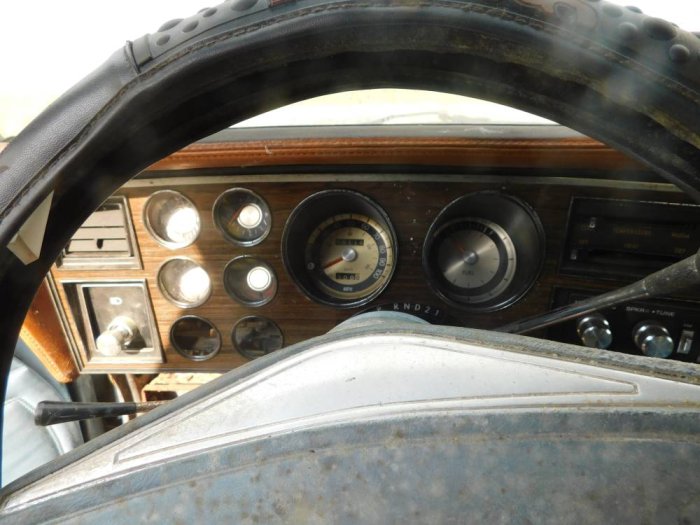

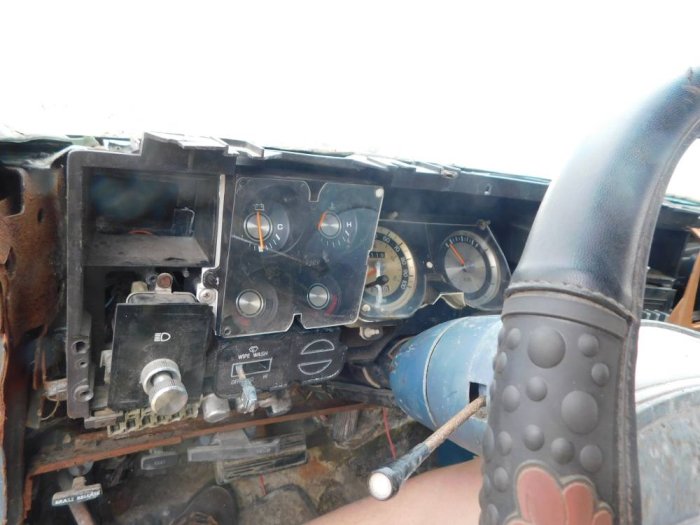

Here's one on ebay. It's actually from a 78 so goes up higher then the later ones but not as high as a cop one.
Maybe someone here who has changed to a police speedometer has they're old one to get rid of?
[/URL][/URL]
got lucky, the gauge cluster was still there and it is now on its way. hopefully this one is intact, and operational. the circuit bord is messed up.

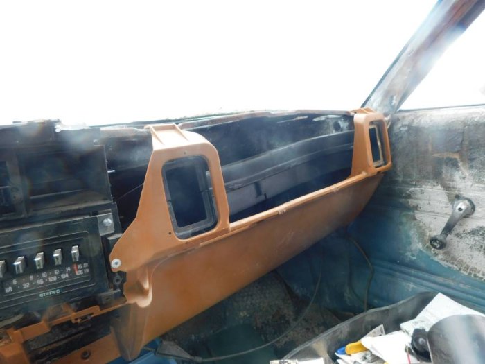

had a productive day on sunday got all the dash parts I salvaged assembled as a test fit.
used metal rails from an old bed frame to make mounts attached to the bottom of the seat, so I could mount the factory seat rails.
. I still have to take it all back apart so paint the plastic. and figure out how to plumb the hot air box to the new AC duct work (any one with Ideas would be appreciated).

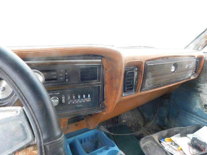

re painted the dash, I was going to try to recover the pad, but I decided to try a trick first.Could contain: Bumper, Transportation, Vehicle, Grass, Plant
I used a product called big stretch it is a type of paintable caulking used to fill large voids and remain flexible. to fill in the cracks, and then repainted it.

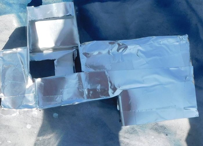

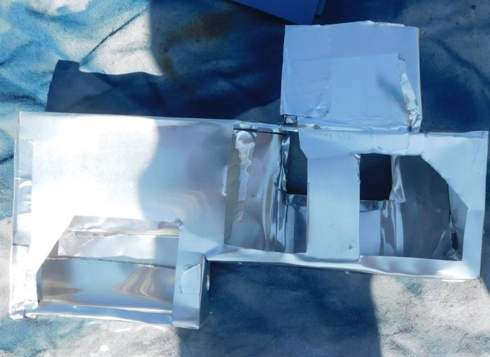

I also had to make the adaptor to duct air from my heater box to my dash& defrost vents
Could contain: Ice, Aluminium
Could contain: Aluminium, Ice, Bag
I made it using the stainless baffling, and heavy aluminum tape. once in place I also used the tape to connect everything and hold it together.

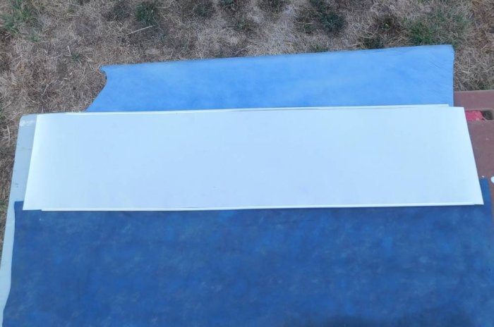

newest update

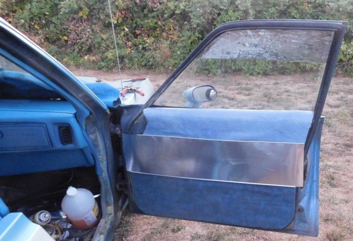

door panel, stripped down to backing
Could contain: Wood, Hockey, Ice Hockey, Ice Hockey Puck, Rink, Skating, Sport, Corrosion
measured top line and started painting on the contact cement.Could contain: Hole, Wood, Plywood
contact cement I'm using paint down liberally to your lines (top and bottom and back of materials to be applied)
rolled aluminum, rounded formica self edge used for a clean finished look, and nylon coated "press in" door weather strip. (used that for making my window felts.) and not shown about 100 pop rivets LOL

I was going to show more details, but time was getting away from me, I flipped that over painted the edges about 2" all the way around, and cut the over hang into fingers , with slices spaced about every 2-4 " +/-.this allows you to draw the materials tight as you fold the mover to the backing..
to get to this:
.( back door inside release deleted)

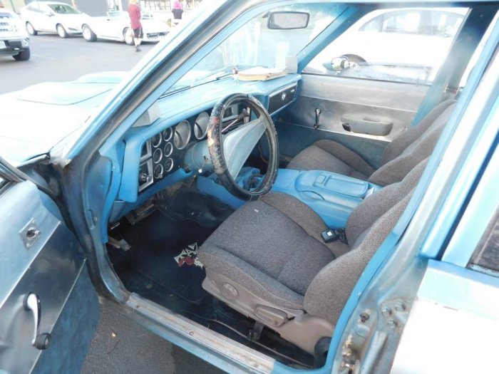

some more stuff I got done repainted the glove box door to match the instrument facia cover, mounted the vent cable, started re stitching the passenger seat so it looks a lil better, then split seams and foam padding spilling out, drivers side is are also done, new sun visors (ones in the dash) and a bobble taz. I also installed the new fan motor resistor while the glove box was out and finished some more of the wiring.
Could contain: Car, Transportation, Vehicle
some thing else I did, but didnt show. since I dont smoke I deleted the ash tray, in favor of a multi- port power outlet to run power chargers, GPS, solar batery tender and other accessories that I might need. (like the console, I took it from a mid 90's GMC yukon. and modified it to fit)

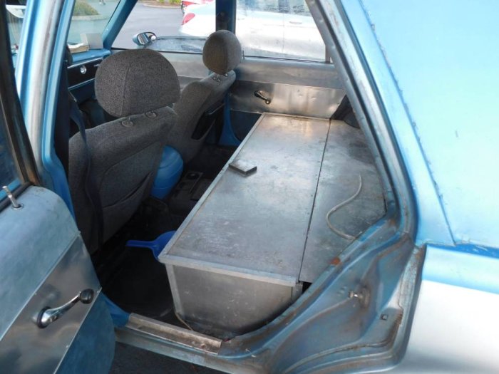

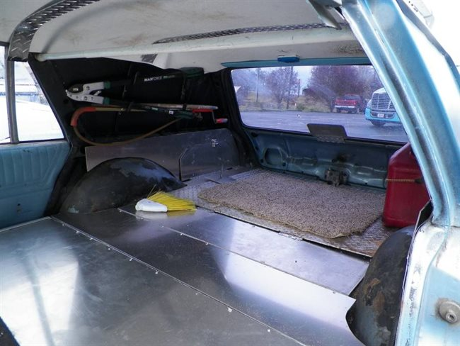

this is the rest of the interior of my service wagon. (pre- fire)
this shows the center filler pannel better , it is split because there is a small storage compartment behind the main tool/storage box
I used some 3M body panel tape to secure the 3/4X 1/8th angle I used for a dress edge,on the lid. I'll add some pop rivits later, if nessisary..
I'm finding there is quite a bit of difference between a AC wire harness and a non AC. and I'm having trouble getting power from the fan control switch, to the fan . any one have the wire chart showing both leads? I tried using the new AC resistor first but not all the wires are in use from the controller, since mine is non AC. so I need to see what wires goes to what? so I can try the non AC resistor. thanks. TAZ
I made a filler panel to adapt the non AC heater box to the AC ducting,, bi past the AC control and wired the fan directly to the heaters fan switch. so far it's working OK at both heating the car and keeping the window fog free. we aint had any real freezing or snow yet. to test against that. I may need to add a secondary booster fan to handle the extra ducting.. I also got a different set of modern adjustable seats with additional storage pouches in the back. and mounted them to the original tracks. they are more comfortable then the strait back 4 door buckets, and give more room behind the wheel. and they give me a place to store my brief case and other recreational items that might go bang.
