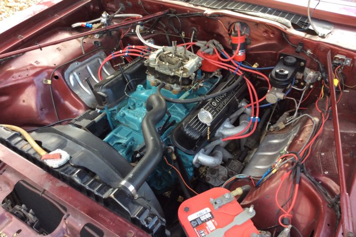

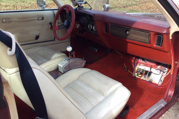

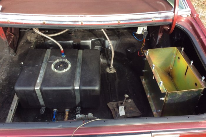

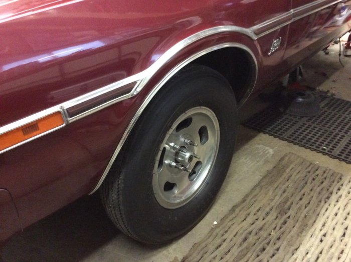

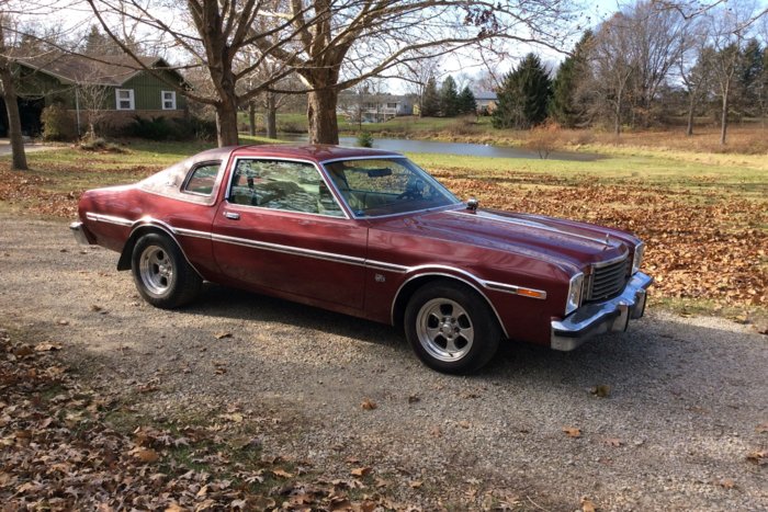

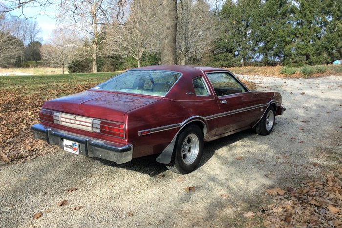

    Bought an easy 79 Aspen stock eliminator project recently. 318 4bbl. that fits in N/SA. Probably seen it on this website before. Only work that needs to be done is to replace the 8 1/4 rear with an 8 3/4 (Picked up the rear end last week) add a set of Caltracs and put on my slicks and front runners. Can't wait for racing season! IMG_0204.JPG IMG_0205.JPG IMG_0201.JPG IMG_0200.JPG IMG_0203.JPG

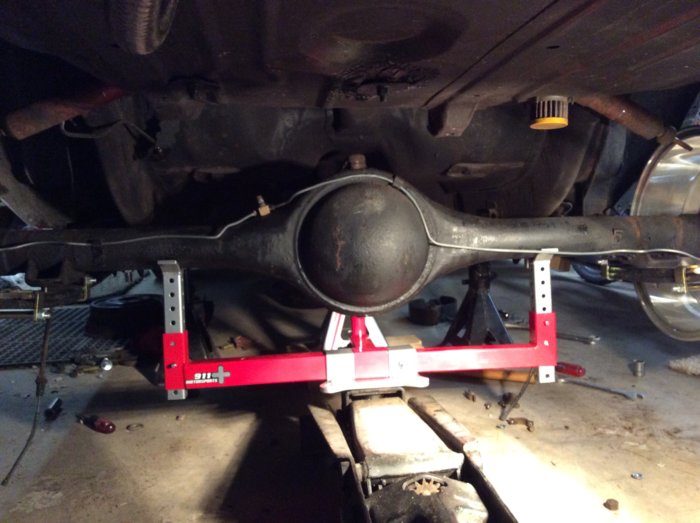

    2

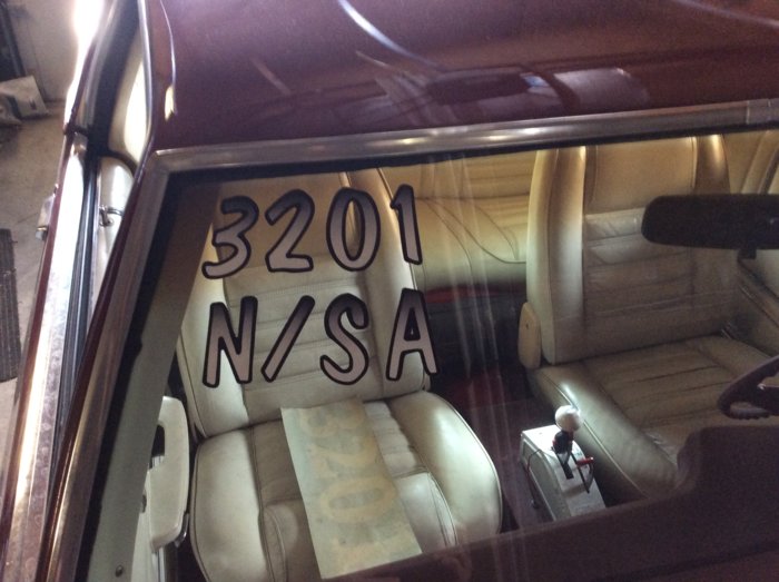

    what is the deal with stock eliminator and N/SA and the 318 4bbl being in that class ? I am not that familiar w bracket racing and I am curious
  4. Oldiron440
    Oldiron440 Well-Known Member
    2,387
    458
    13.00 record means that there are guys capable of 12.00s, how fast is your car?
  5. cjd1963
    cjd1963 Well-Known Member
    94
    37
    Nov 19, 2012
    Mahomet, IL
    Yes that's partially right...13.00 is the N/SA index and there are some that can run -1.00 and more under the index. Stock eliminator is a form of bracket racing but with more rules and restrictions. I haven't raced the car yet but hoping it will run .2 or .3 tenths under the 13.00 index. I will then work at making the car quicker as I go along. Thanks for asking, Craig.

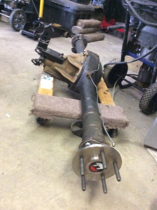

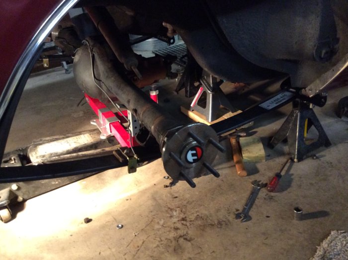

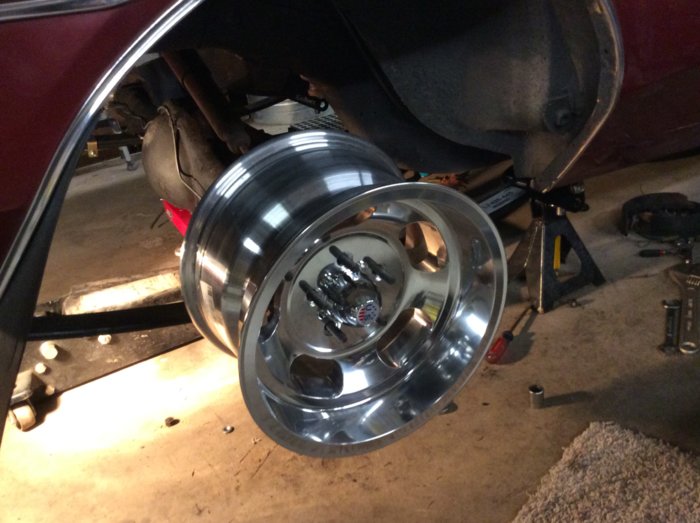

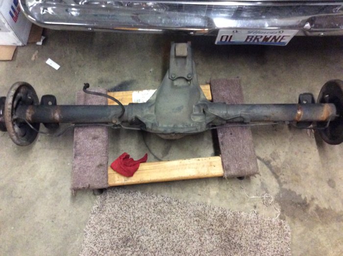

  20. cjd1963
    94
    37
    Nov 19, 2012
    Mahomet, IL

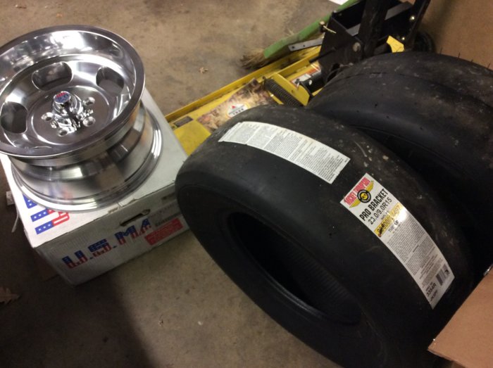

    71A86216-1BA6-4E1A-AA0F-51B46E571DB2.jpeg Making some progress with the rear end and Cal-Trac swap. New springs are in place. Lining up the 8 3/4 next to determine where the new spring perches need to be welded into place. Bought new 9x28 radial slicks and 15x9 Indy slots to match the 15x3.5 Fenton front runners. It’s coming along. Racing season is just around the corner! Thanks for looking, Craig.
