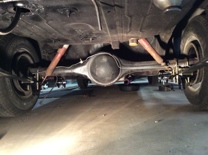

Making some progress on the Aspen. Rear end is in place, took a couple of attempts to get it centered. Still have to sort out pinion angle and the driveshaft but getting closer.

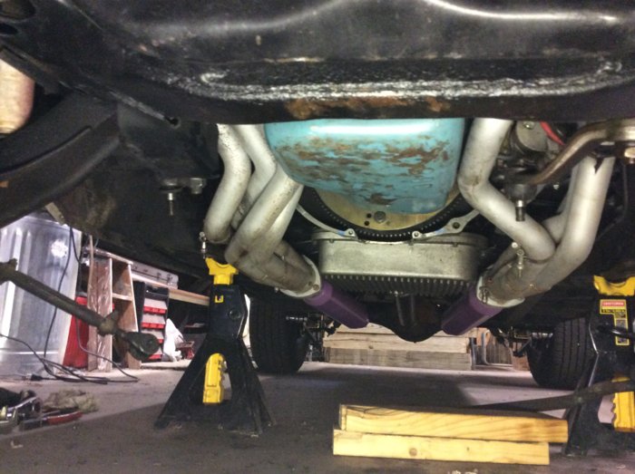

Time for a long overdue update...finished the Aspen named “George”up in July. Took him out for a test drive. We live out in the sticks so lots of open roads. Everything was looking good. Parked the car in the driveway and went in the house for about 2 hours. Started it up to put back in the shop and the oil pressure was 15 lbs. WTF? II have checked numerous possible culprits...drained the oil, clean. No metal shavings, changed the filter. Checked the gauge and line to the gauge, looking for anything that could partially clog the passages that would result in an oil pressure drop. Removed the drag link and dropped the pan to check inside the pan and the pickup tube. Looking for anything suspicious. Put the pan back on, fresh oil and filter. Primed the pump with a 3/8 drive drill and the gauge shot up to 58 lbs. Stated it up and it was at 20 lbs. Gave it a little bit of throttle and it went over 40 lbs. No funny noises or screeching of any kind. There is a partial blockage somewhere and it’s driving me crazy. Putting it back together to drive around and hope that the clog will dislodge itself. Anyone else have this experience?

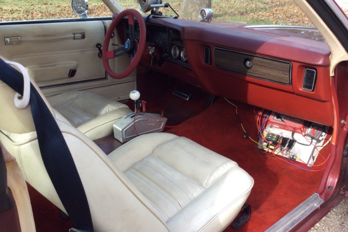

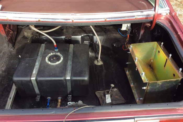

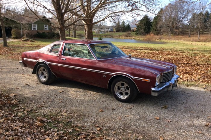

Bought an easy 79 Aspen stock eliminator project recently. 318 4bbl. that fits in N/SA. Probably seen it on this website before. Only work that needs to be done is to replace the 8 1/4 rear with an 8 3/4 (Picked up the rear end last week) add a set of Caltracs and put on my slicks and front runners. Can't wait for racing season!View attachment 27912 View attachment 27913 View attachment 27908 View attachment 27909 View attachment 27910
