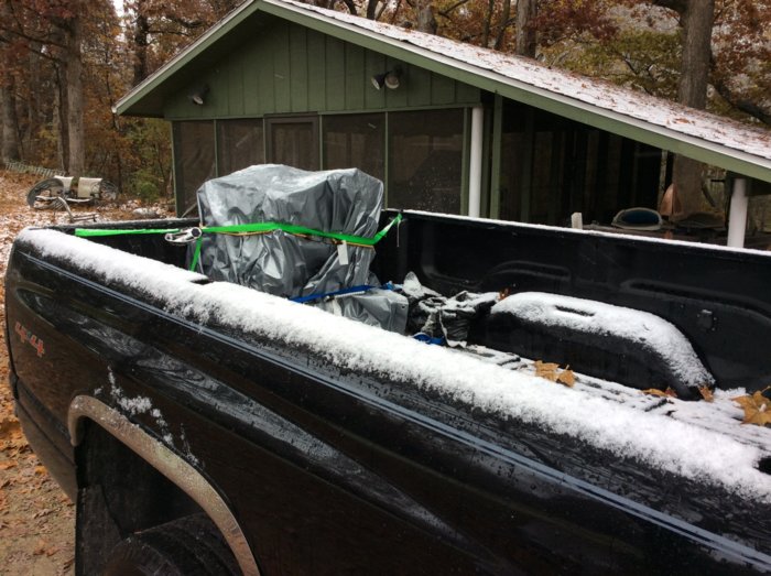

Well, decision time...(drum roll) Going to pull the engine and freshen it up since the racing season is almost over. Don't want to take a chance on making it worse or hurting something else unnecessarily. Besides I'm tired of laying on my back underneath the damn thing. Thanks to everyone for their thoughts and input. The Aspen "Stocker" Project will continue in 2019 for anyone who really gives a crap. Thanks again, Craig.

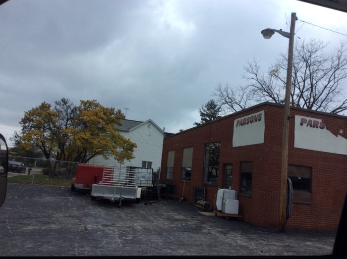

Finally got the engine out and took it to Parsons and Meyers in Dayton OH. Very respected Stock/Super Stock engine builders. Will update when I learn more...
