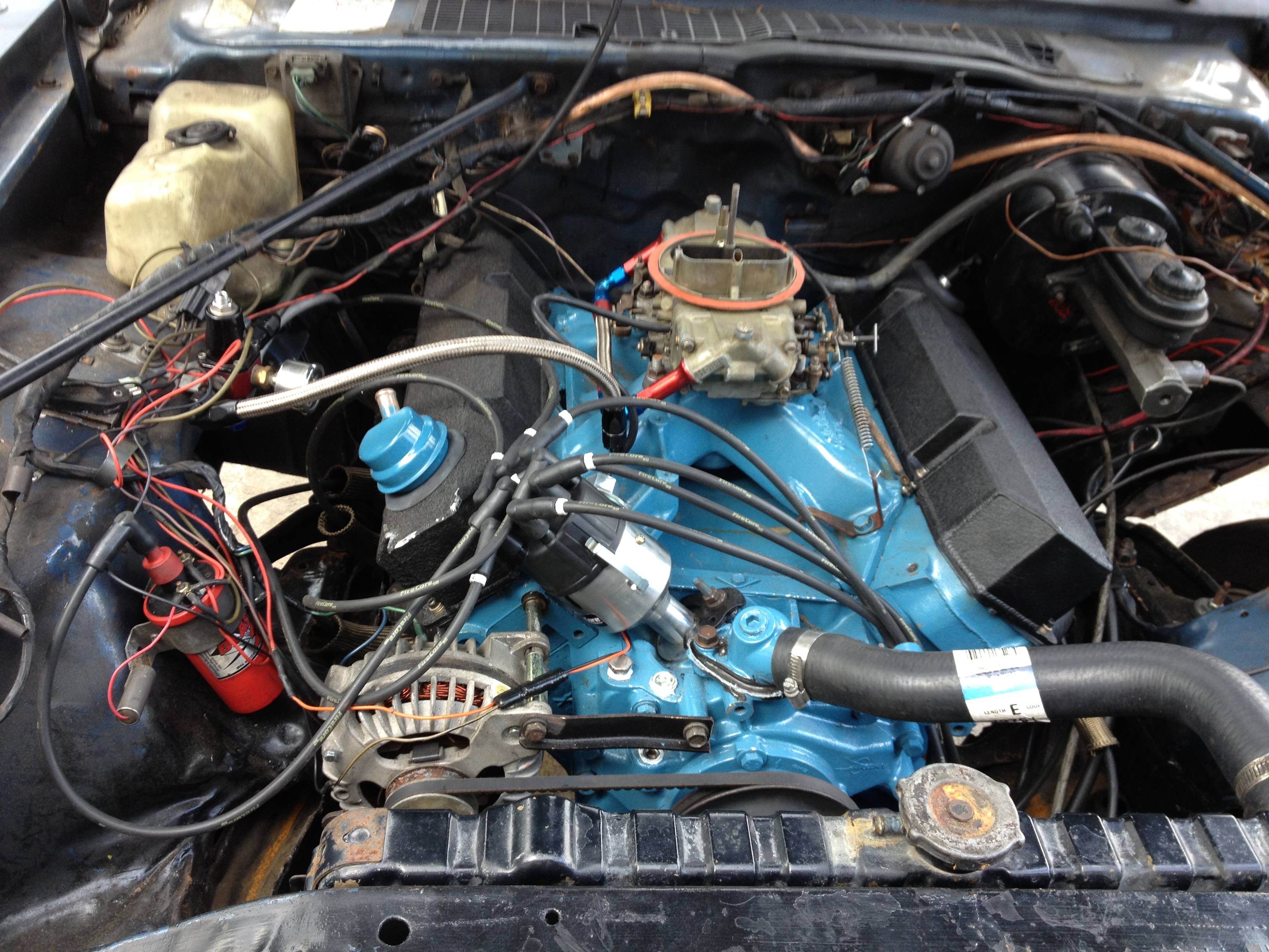

not sure about stock valve covers, but i used ebay special aluminium valve cover with rattle can wrinkle finish and they wouldn't clear the stock booster, had to use a k-car booster, used a deep center sump oil pan ment for external pick up, and yes i had to shave that fat lip on the back of the k-member, I used hooker 1 7/8th headers they fit, but damn its tight on the passenger side, smacking a few of the tubes helps, also switched to an aluminium manual steering box, look at 440source for their "blemished" water pump housings, picked up a passenger side housing that needed gasket matched, but at $35 for the housing, used a GMB aluminium pump off ebag another $20 check out my build here http://board.moparts.org/ubbthreads/ubbthreads.php/topics/1953459/1.html
