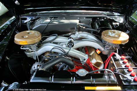

Another dream I have is to make molds of the Long Ram intakes I have hanging in my garage. Then taking the mold and modifying the casting so it has “long”, “short” and “really short” runners (plastic intake), much like what intake manifolds made in last 15 years perform. The problem is the original long ram intakes will not fit onto an FMJ vehicle without massive modifications to the inner fenders and fender braces. I would think having a tuned and adjustable runner intake manifold on a dual fuel injected big block would be blast to drive.

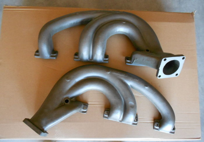

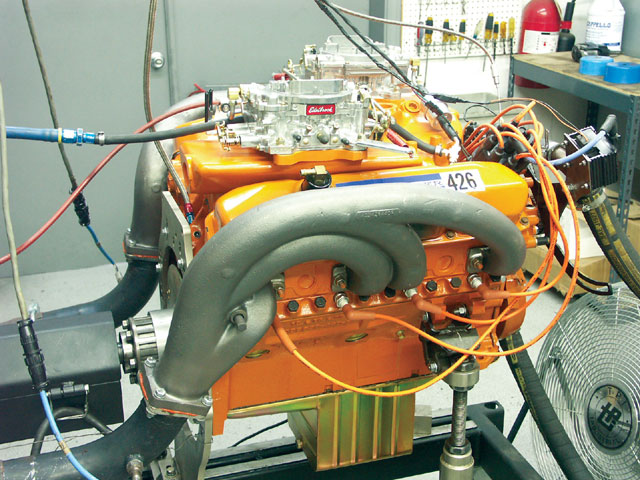

While I'm dreaming, I'd also like to squeeze these under the hood, as well (Max Wedge exhaust manifold) – but, again, I don’t see that happening on an FMJ. I happen to have a pair of these on the garage wall as well (repops).

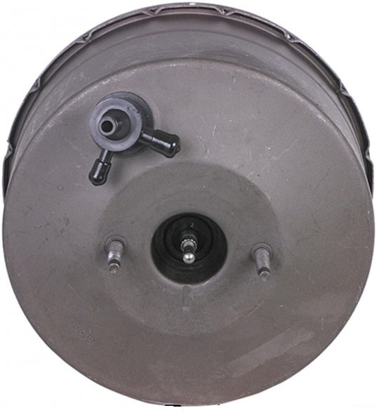

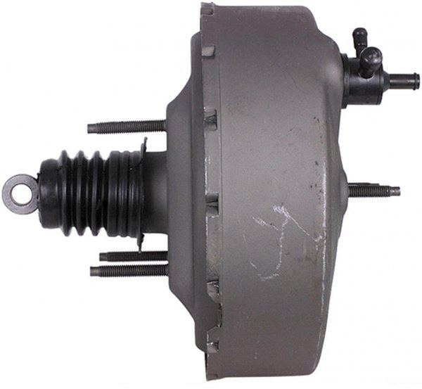

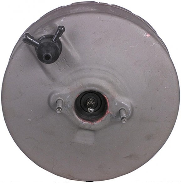

Is a K car power brake booster a direct bolt in swap into a FMJ?
Any modifications needed?
Can the FMJ’s original master cylinder be used?
Thanks
1,494

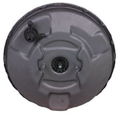

There are two different versions of K-car boosters (pretty much all Chrysler Front Wheel Drive cars made in the ‘80’s – except for L-body (Omni/Horizon) which most things are slightly different on).
The single and dual diaphragm boosters:
The singles were mostly used on carbureted/injected cars and dual’s on turbocharged cars (but that is not a 100% rule – and seen them both ways).
The diameter on both is much less than FMJ booster. The dual booster is smaller still (and much smaller overall than the B/C body dual diaphragm or pickup dual booster design).
The length is a hair shorter on single and not quite double on the dual.
The bolt hole locations are the same on both ends and all share the same check valve.
The K-car provides slightly less power assist than FMJ and dual booster provides a bit more power assist than FMJ. I think the FMJ booster is over-boosted as is (IMO). I haven't heard anyone complain or mention anything about the amount of power assist after conversion.
The difference is the K-car booster uses metric threads. Most of the boosters I’ve ran across, came with new nuts – so on worry there. Just don’t use SAE nuts on metric threads (or vice versa)!
In most cases – no. Sometimes you might need to take a small round file and to clean out a firewall stud hole – but I’ve found that not necessary. If it doesn’t smoothly push it, then just push a tad harder and it goes right in. The same thing applies to FMJ boosters, as well. Sometimes the firewall holes and the brake bracket under dash holes don’t line up exactly – but a semi-firm push remedy’s that.

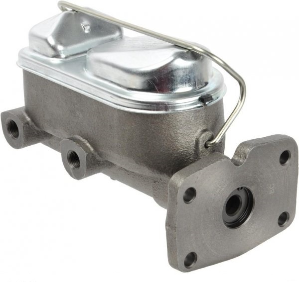

The K-car master cylinder is almost the same, between the different carlines. The only difference is the diameter of the master cylinder piston. If you use an aluminum FMJ master cylinder – you are good.
If you have an earlier F or M body with the cast iron master cylinder, I would encourage replacing it with the newer aluminum FMJ master cylinder and save 20 pounds(?) in the process.
If you have an older FM cast iron master cylinder and you insist on reusing it, the only other option is to either go manual brakes (non-power assist) or find a B/C-body or pickup dual booster with a 4-bolt master cylinder – and some of those are hard to find. The K-car booster is smaller and the better way to go, IMO.

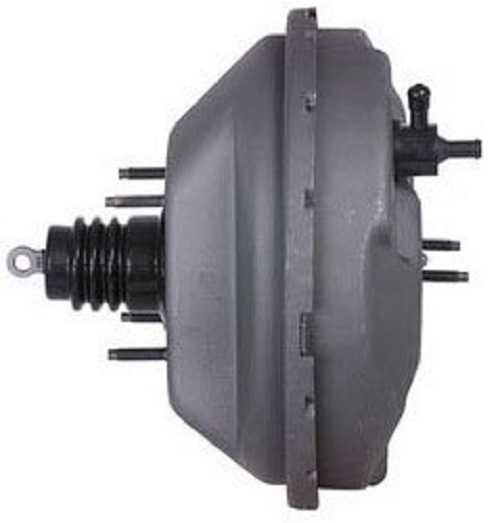

FMJ booster
K-car single booster
Dual booster
Cast iron 4-bolt master cylinder
Aluminum master cylinder (same for most all Chrysler '80 and up, except for bore diameter)
Note: the top tank can vary in color - but all will interchange. They will pop off with a screwdriver.
Edit: Before install, make sure the bolt that goes through the booster rod fits fine.
I have seen three different bolt styles used on FMJ's.
One uses a bolt have an O-ring grove cut into it to prevent metal on metal rattle (a good idea to change the O-ring while bolt is out).
Another design us a more normal bolt and it uses grease to prevent a rattle noise.
The last design (most popular one) uses thin plastic bushings between the bolt and booster arm.
Whichever design bolt you have, be sure to apply some grease there and wipe up the excess.
The bushing - if missing, can sometimes be found a better stocked hardware stores.

Way back in '89 when doing the original BB swap on a tight (meaning no) budget, I had a set of hi-po 440 manifolds (not Max-Wedge) and the drivers side would have exited inside the car, right on top of my right foot. The left side exited dead nuts on top of the subframe rail. They were the manifolds on the donor engine, which came out of a rotted to the door handles '71 Roadrunner at the bone yard. Settled for standard passenger car manifolds instead, not really ideal but they were free. Headers weren't an option, they were only a dream, lol.
I wonder about the Max Wedge manifolds. A buddy had a '68 Barracuda fatsback with a 440 swapped in by who know's who, and it had the Max Wedge manifolds, and they fit that car just fine, IIRC. That was like 1983 so, if there were any mods, I can't remember them anymore. Slightly amusing story about that car. My buddy traded his '71 VW Super Beetle straight up for the 98% rust free Barracuda. Of course he went from 40 mpg to 10 mpg but, what the hell!
