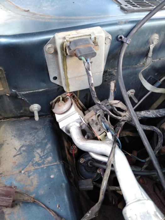

    after a rough ride i put an ear to the engine to try and once again find the source of the click. pinpointed this set of wires attached to the two right side metal boxes on the firewall. i have heard that the larger one with the plug on the front has a history of failing on multiple m body cars. anyone know what each of these boxes do? i adjusted them and suddenly the clicks just went away! and even stranger is that after adjusting these wires the choke closed after the car went cold! previously my choke was stuck open. the car has treated me well these two days and i don't want to jinx her by saying my problem is fixed.

    the big one with the plug and green/blue wire is the voltage regulator. That could do it.

    By virtue of you playing with those wiring harnesses, it sounds like you've either got a bad connection at one of the connectors or a break in the insulation of one (or more) of the wires inside that big taped bundle. The tweaking you did on it has temporarily solved the problem. The "clicking" noise could be electrical arcing from those wires which is causing the engine to not fire on all cylinders all the time, giving you that "hunt" in the idle. Some careful, gentle unwrapping of the bundle, and a close inspection of the wiring should find you your problem.

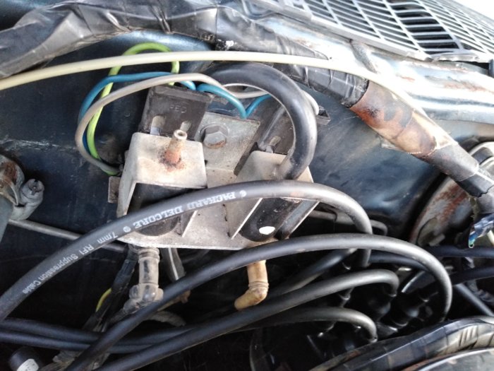

    The one with the wires going in the bottom looks like a metal relay box. A short within or leading to it would cause it to click. If it controls something like start/run timing conditions that click could also be messing with your timing.
    I admittedly have no idea what it ACTUALLY does because it's part of the mysterious late year LeanBurn setups with baro sensors and other retrofitted emissions junk.

    just got her back from the shop. runs very quietly after getting some new belts but alas the stalling continues. they cleaned up the connections on the wires and added some new electrical tape but the clicking soon continued stalling me out in the wal mart parking lot. fiddling with the wires helped get me home with one final click while parking her at home. luckily it went away when i told the car to "shut up!". over all she does run great except for that one issue. could it be the dreaded "LEAN BURN?" the sound isn't coming from the computer. its the top right part of the engine and goes away once you fiddle with that set of wires. guys at the shop said the voltage regulator should have nothing to do with carburetor function and its most likely a lean burn issue. i'm lost here but i can live with having to pull over and fiddle with some wires every now and then for now.

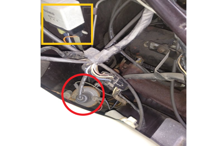

    the main bundle seems to jolt while its clicking. i think its the voltage box. one one with the plug on the front. but i do see there are other thing hooked up in that area of the engline like the round thing directly beneath the washer fluid. not sure if thats what could be messing me up. i want to know what these two things do and where does that wire lead to. what in this area of the engine could cause me to stall? just the voltage?

    Open up the wire loom going to that relay looking deal (yellow square) next to the voltage regulator. Make sure the insulation isn’t cracked on the wires inside the loom/under the electrical tape. It sounds like an electrical short if it’s happening intermittently and shaking those wires “fixes” it.
    My car had its lean burn deleted well before I ever bought it, it doesn’t have that relay so, I couldn’t tell you what it’s there for.

    Red circle, that’s your ignition coil. Check that thing for cracks, that red wire could be rubbing on something...dig deeper lol

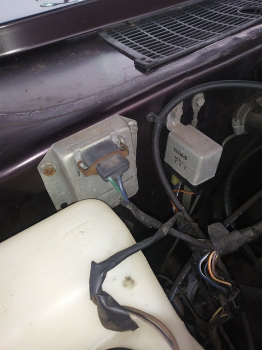

    That's weird, I still have the lean burn but I don't have to that particular relay

    Later models and Cali compliant cars would have had extra emissions equipment. I'd bet Elwood doesn't have the barometric and evap solenoids right behind the air cleaner either. Picking up something like a Haynes manual isn't a bad idea for the vacuum and wire diagrams...

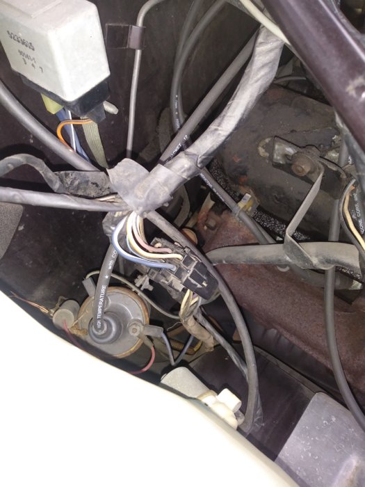

    You mean these things?
