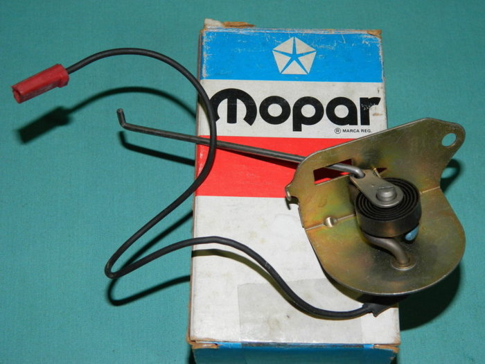

- The choke thermostat is a bimetallic spring that has a 10 to 20-year lifespan. If yours hasn’t been changed (which I would assume, if it had been changed, its due for replacement again) then I would do so, again. It bolts to the intake manifold and has a rod going to top of passenger side of carburetor. If you can’t find a new choke thermostat, let me know for I can get you pointed into the right direction.

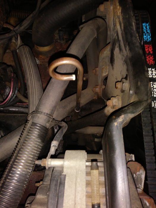

as i've heard many say, the car is "temperamental" took it out today (its my daily driver) and warmed her up for over 5 minutes. after idling for a few minutes it begins to idle slow and puttering a bit before going back up again, this normal? i took off once the idle smoothed out but i got that dag on surging again. i pulled over and opened up the hood and let her sit a while in the pouring rain and once i closed it, the car ran smooth as a whistle! there is a hose that is rubbing up against the dip stick housing that is a little bit burnt and the clicking noise shows up every now and then but is nowhere near as severe as it once was. shows up for a second or two once cold starting then goes away with a rev or a yell of "shut up!" i have given thought to the fuel injection conversion but i fear it may be expensive and who knows how the end product would turn out. if it saves fuel economy i guess i'm in. what ever fuel economy you can get from one of these boats!
1,494
These cars do have some quirks but being temperamental shouldn’t be one.
Can you take a picture of the “burnt hose on dipstick”?
Rain / high humidity can make the ignition system act up (high voltage meets water…) at times. Sometimes hitting a water puddle just right can make either of my cars act up for a bit.
Same with washing car underhood at a car wash. Get a bit of moisture in the distributer cap area and it can do the same thing – until that area gets hot enough to boil out the moisture.
1,494

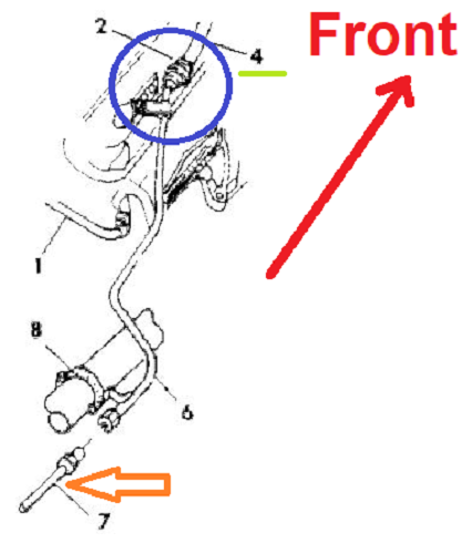

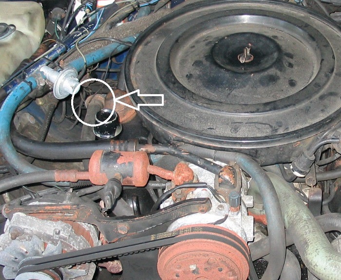

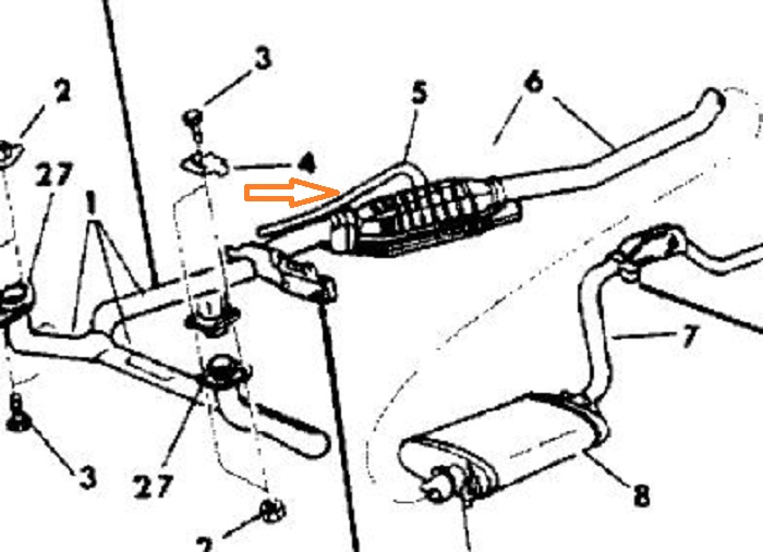

That hose comes from the A.I.R. (Air Injection Reaction) pump. The A.I.R. pump pushes air into either the exhaust manifolds (before engine reaches operating temp) or to catalytic converter (after engine gets to operating temp).
That hoses looks/appears to be a heater hose (and heater hose might work for a replacement – if wanted) and it connects from the A.I.R. pump to a metal check valve (white circle/arrow).
This is pictures from my ’87 Parts Manual:
The metal air check valve is blue circle. The hose in question is the (green) underlined #4. The two orange arrows (different pictures) are the same item.

everything appears fine with the car. just that hose is a little bit burnt. not sure if i can move it or not
1,494
It is not a critical concern – unless the air pump is disconnected.
If it is disconnected (no belt), and if check valve failed (white circle, above), then that can be a concern (exhaust can/will melt rubber (or worse)).
If pump is connected (has belt and turns when engine is running) I would either leave it alone OR:
Get a heater hose splice kit (3/4” inside diameter – I think) or get some electrical tape and wrap around it a couple of times. There shouldn’t be any heat (other than normal underhood heat (~230’ F)) and part is not under much pressure.
Edit, I might even have an hose I removed from my '86 Fifth Ave - but don't remember its condition.
