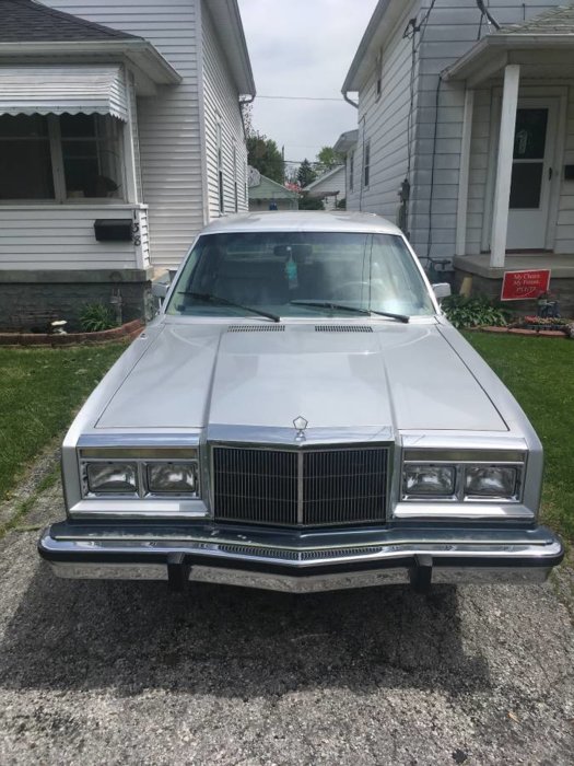

BTW, check this beauty out for the same price but 600 miles from me...
1986 Chrysler Fifth Avenue

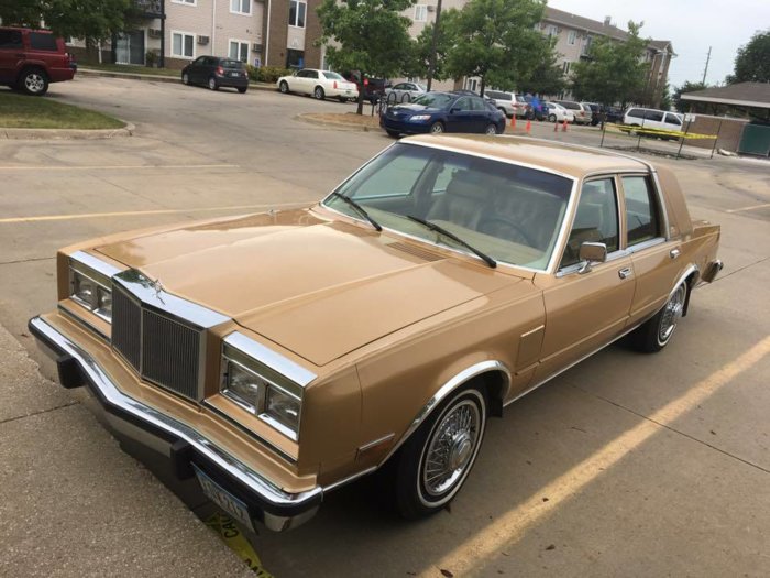

Get the brown one in des moines and drive it awhile.
If you don't like it, shoot me a PM when you want to get rid of it.

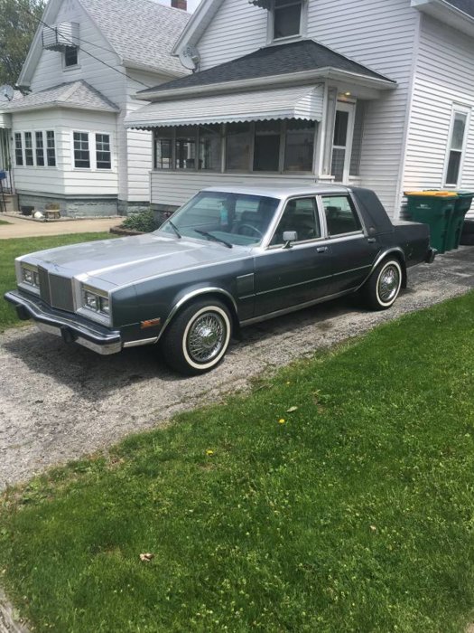

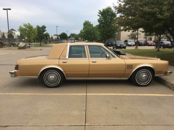

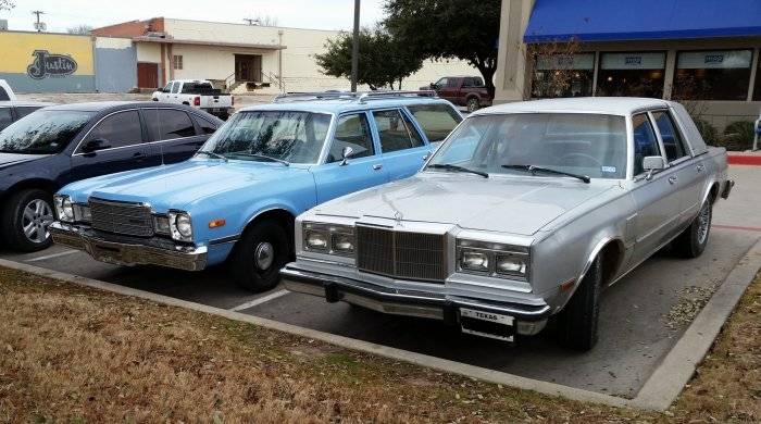

I love the first Fifth (the two-tone silver/gray) looks like a marriage between JustWondering’s ’87 and my ’86 Fifth Ave’s. Just wish it was a lot closer to me . . .
On the exterior – both cars look very nice – but I would want either more pictures or spend some time looking at and under car before spending that much on either.
As far as Safety, Reliability and Economy – I would say any ‘80’s Fifth Ave compared to an ‘80’s Crown Vic or Caprice – the Chrysler would win or be a virtual dead heat on. Now comparing a Fifth Ave to a ‘90’s Crown Vic or a ’06-11 Crown Vic – then there is no comparison, the newer car wins hands down.
A person just cannot compare vehicle 7-12 years old to a vehicle that is 32 years old.
I have a feeling the headliner on the silver car is starting to come down (a problem with all cars made in that time frame, including Ford) – based off how it is starting to peel away from the trim that is visible. No inside shots on the tan car – so can’t comment there.
My ’86 Fifth Ave has been in my hands for over 10 years now. They only thing I have done to it is replace a leaking water pump, replaced the A/C compressor (not sure what previous owner was trying to do on it – for compressor was half taken apart and half of it was Ford parts, Replaced the starter with the mini-starter (starts so much better), replace the carburetor with a non-computer-controlled Carter BBD and remove headliner from car. I’ve also have a few flats on car – but for ten years driving – I think is good for a car with 80k miles on it still.
Car does need to have steering gear leak fixed – and original exhaust system replaced – and have the parts on hand to perform both (just no time . . .).
Both vehicles mentioned are in better shape than mine is – for mine has sat outside for last 30 years – and it shows.

I like them both. I usually don't care for silver cars, but the two-tone with charcoal looks quite nice with this body style. The gold is more unusual though. After having been t-boned on the drivers side in my first 2010 Mazda 3 with only 6000 miles on it, I am a firm believer in air bags. Both cars were totaled, but no injuries. I was thankful and impressed enough to go back and buy another identical Mazda 3 which I still have as my daily driver with 100k plus miles on it. I love my '78 Aspen wagon, and all older Mopars, but for a daily driver, I want the safety features that just weren't available 30-40 years ago. Just my opinion, but if the same accident had happened in my Aspen, I doubt I would still be here. So that is the safety aspect of things. As far as reliability, probably luck would play a part, as well as how well the car was maintained. No doubt the 5th would be easier to work on than cars of today, but then it would probably need more periodic work to maintain it than the cars of today. The only thing I've ever done to my Mazda is change the oil and put gas in it. Nobody is going to give the Mazda a second look, but I don't care about that for my daily driver. Also, the 5.whatever liter Triton V8 engine in my 2000 Ford truck seems to like to eat through spark plug coils at over $100 a piece. PITA to remove and change spark plugs, but otherwise, ok. Meh, but ok. If the Ford or Mercury have this engine, I'd keep looking. Just my opinion, but good luck in making your decision.
