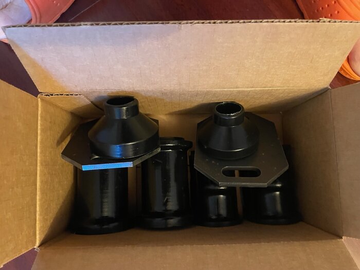

I got an email that my t-bars had been delivered while on shift last night so I swung by and secured them but really didn't have time to open them up and drool. So for now this is the only pic I have lol.

so exciting ...
you say thats whats in the brown box, but we all know what you reallllllly ordered, that gets delivered in a plain brown wrapper....
Ginormous chocolate bar?
lordy ... I need to stop this caffeine...

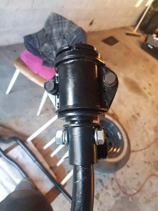

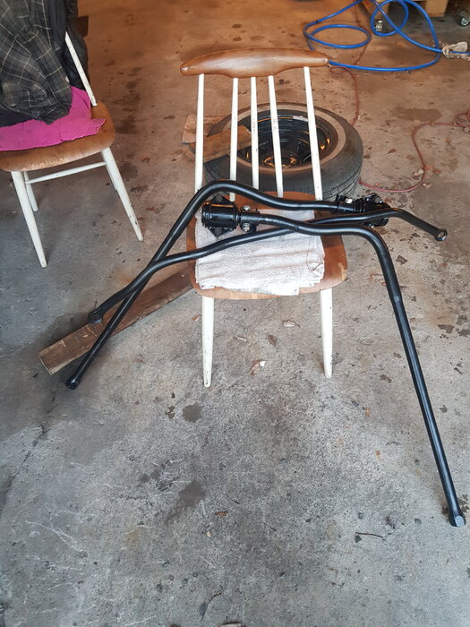

Here is a photo of my bars assembled with the new pieces before I put it back in.

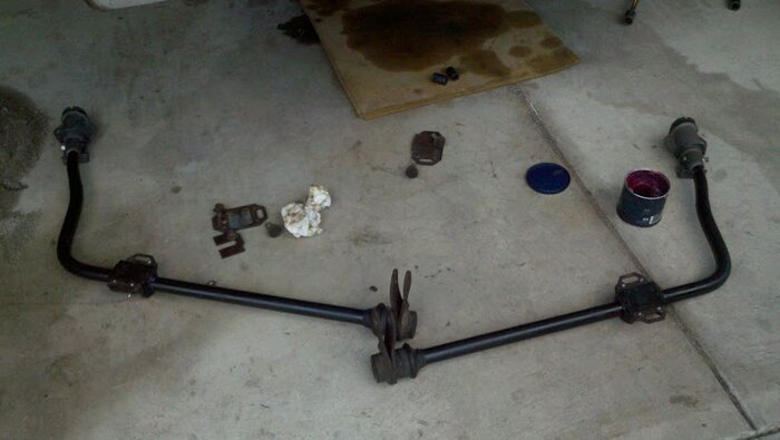

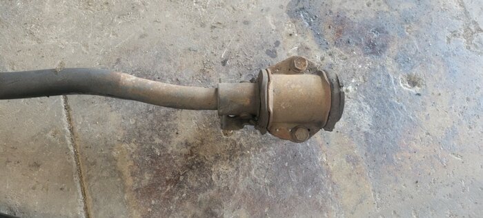

I found a lot of good info on dippy.org when I did mine.
Suspension: Torsion Bars
Like Duke said the hardest part for was getting the control arm end piece separated from the torsion bar. After removing the pin the end piece were rusted solid to the bar. Had to get creative with a hydraulic press to break them loose.
The end bushing shells was a bit tricky to separate without destroying them. I used a small grinder and a punch to break the spot welds. They got a little deformed in the process, but I managed to straighten them out in a bench vise.
Unfortunately I forgot to take pictures while I did it, only got some after job was done. :rolleyes:
Attached an article with some pictures, see #11, 12(it says stabilizer bar, but that is the pivot bushing) and 24-28.

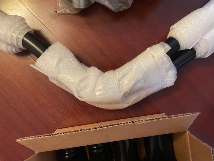

Big beefy bars and new urethane and plates

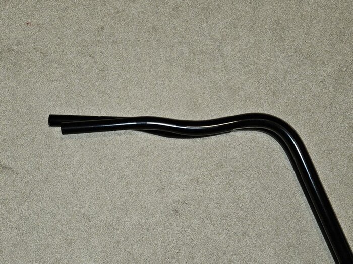

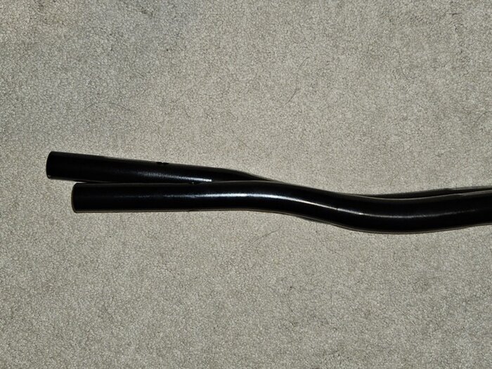

Well, I picked mine up today from my friend's. Happy than a pig in shit for sure...but I got them home, placed them down on the floor and noticed that they are...ASSYMETRICAL!
Clearly I have never realized this before, and I always thought they were the same thing. Heck I could swear I never noticed them to be different in the past. Maybe I was lucky to always grab the right bar for the side of the car...or.....do I have a problem here???
Take a look at these, a couple of shots to just compare them...clearly the curve is different on the LCA part of the bar, otherwise they pretty much match up to just past the 90-deg bend.
EDIT
Never mind...a quick search revealed that they are in fact different: specific L(eft) and R(ight) sides!
1,822
1,025
Yeah, there is an L and R stamped on the hex end of the bars. They couldn't be symmetrical. One bar sits in front of the other on the K and would need to be longer to reach the LCA.
Oh, yours had that?
Nothing on either one of my bars...no 'L', no 'R' either...
1,822
1,025
Oh, yours had that?
Mine did at least, yeah. That was eight years ago though. The longer bar is going to be the one furthest towards the front of the car.

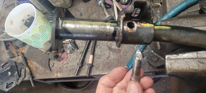

Okay drilled and removed pin how does this come off again (second picture)? Do you put a bolt through here now? Thanks!!!
