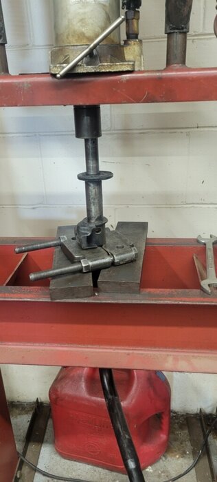

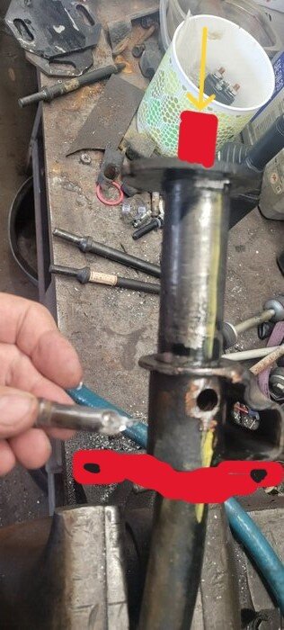

That is what I meant was the hardest part, separating the sleeve from the bar.
I made two half-moon shaped pieces of flat iron. The radius of the circle they make when you put them together must match the thickness of the torsion bar. Made holes in them and bolted them tight against the bar, right under the sleeve.
Then I used a hydraulic press and applied a great amount of pressure aganst the bar end, and used the iron pieces as counter-hold.
Alot of rust remover, apply pressure and heat... more rust remover, more pressure and heat some moore...
Hard to explain for me in English, so I made a beautiful sketch from your picture so you get the idea. :p

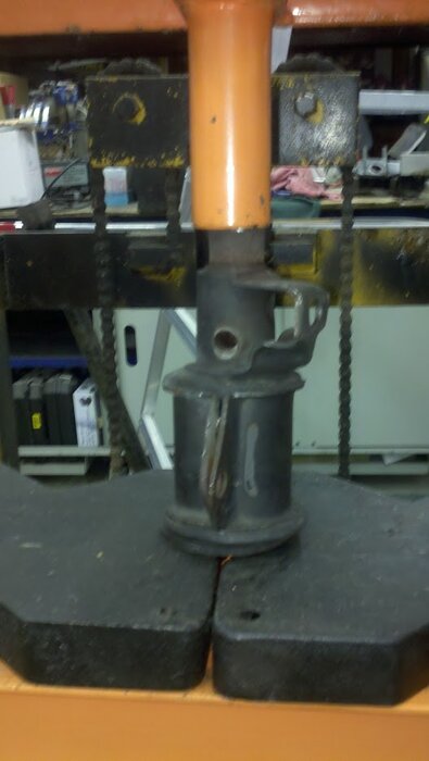

Thank you Duke5A and Sub03! Both are off now. I appreciate the pictures too!
I had to borrow a press.

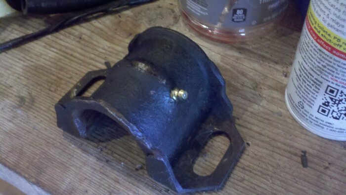

Here is a shot of the pivot shell with a zerk installed. The Firm Feel kit came with this. This was ten years ago though. Their kit may have changed since then.
Couldn't salvage the bushing from the old bars. Fucker rusted solid.
It will NEVER happen again. lol.
