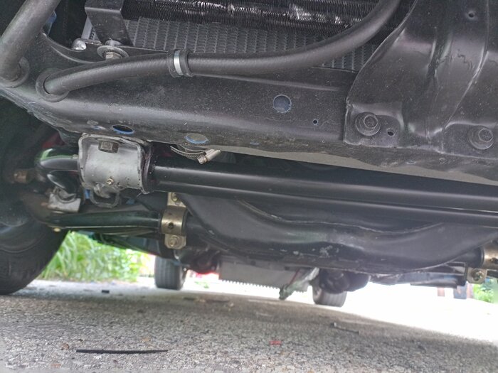

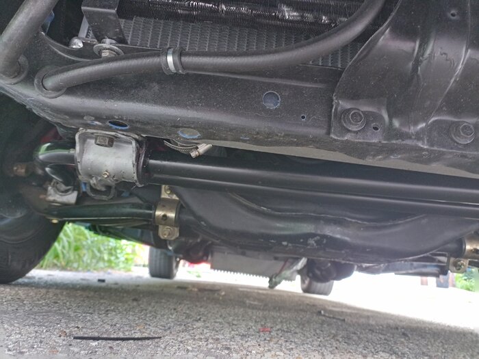

Got my bars in, not the best pic

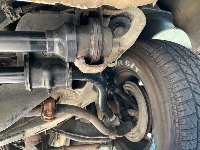

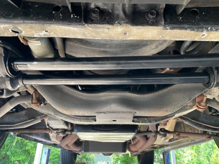

Today I worked on raising the car a bit more and perfectly leveling. Everything checked again and looks good. Slight pull still to right so I'll get an alignment soon. LOVE the way it drives and handles now!

So many FF parts up front now, from aluminum biscuits to urethane bushings and of course the new t bars. And again a big thanks to Duke5A for the custom frame ties! I really believe I've done everything I want to this AHB and absolutely love driving it now more than ever.

I told you guys. Lol. The first hard turn I took after install I couldn't believe it.

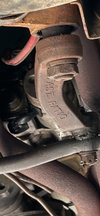

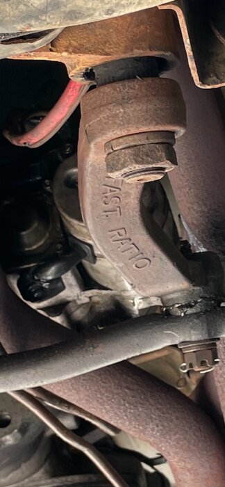

Larry for the fast ratio arm, What year(s) was there the
different size ? Charlie
