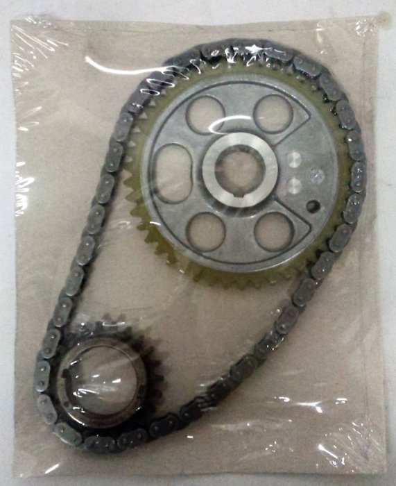

This is a single roller chain setup that uses the plastic/aluminum gear (the silent gear set). Most replacements will be an all metal design. The plastic is quieter, but its lifespan is, um, pretty short.

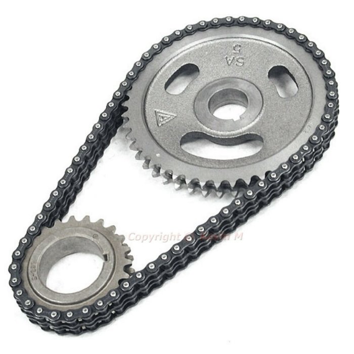

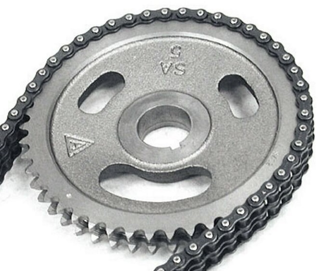

An aftermarket double roller setup. The main difference between single and double roller is chain is like two narrow chains side to side (made into one).
There might be a difference between the all metal single and double roller design, maybe/possibly. The plastic single roller gear set shouldn’t be used on anything but on Furds or Chebys, period. Technically, they were bad/defective when installed on the assembly line, but they were cheaper and quieter (which I can agree they are quieter . . . and are REAL CHEAP!).

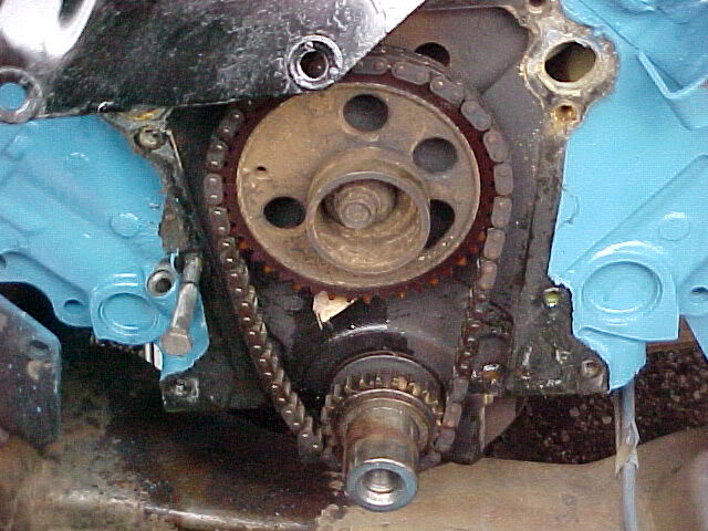

Look at the cam gear teeth and, if you can, the chain has a runner on both sides and in middle.

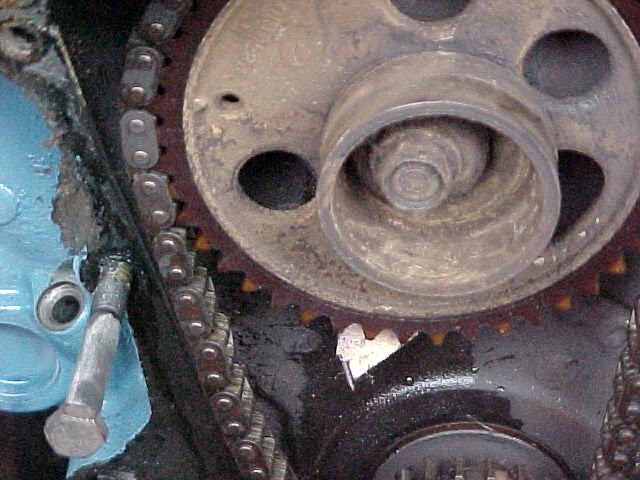

This is some pictures I found on internet. The white plastic has turned orange/brown from the heat. I’m very surprised there are no missing teeth!
I can see the Right side (of picture) the chain is tight. The Left side (of picture) is saggy loose - enough so to condemn the chain.
