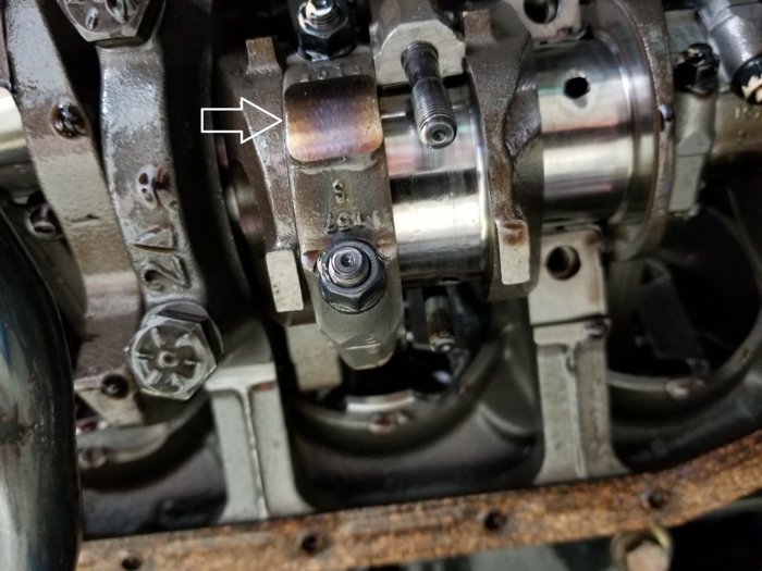

I have an opinion to rod bolt failure (any rod bolt) – but have absolutely no proof (so this is only a working theory):
I suspect when the rod bearing has worn (or failed) to the point the bearing is making a knocking noise - the hammering of the rod hitting the crankshaft twice a revolution, fatigues the bolt to failure, or if noting else, causes the nut(s) to loosen – which compounds the hammering effect.
I have seen the loose rod cap nuts (or broken studs), on rods with very little (or no) rod bearing remaining (ie: a catastrophic failure). A rod bearing will make noise well before that point, which makes me wonder about things.
On a different note, if you have a sudden stop of engine oil flow (ie: stopped up oil pickup tube, zip/zero/nada oil inside engine, striped or broken oil pump driveshaft, stuck fully open oil pressure release valve, etc.) then I have seen rod bearing fastener failure occur very quickly –for without any lubrication any engine will fail soon.
Also, my experience has shown when you have a bearing failure, generally (not always) and with the engine oil pan is off, you can see discoloration of the effected rod bearing caps (which happens before rod cap fastener failure) from excessive heat.
I had a few pictures of the rod cap discoloration to show, but it appears those photos don’t want to be found. This is a (poor) picture I found on the internet:
I've seen the rods change a wide range of colors (dark black/blue to almost white). Almost always a noticeably different color than rest of the connecting rods are. This rod cap didn't change color that much - but is still showing signs of overheat.
