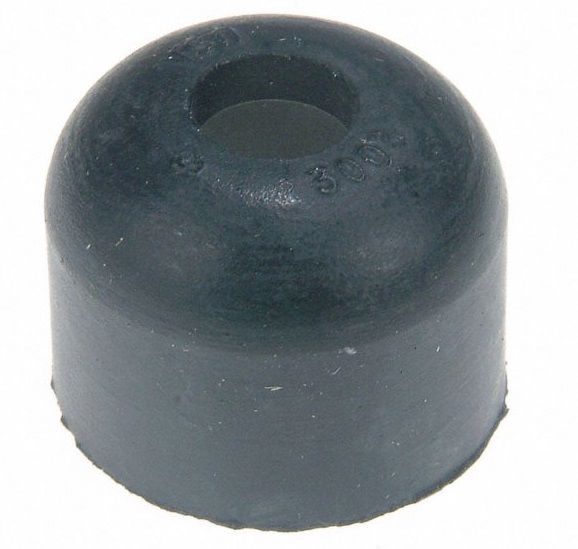

To be honest, I do have oil consumption issues with both of my 318’s, currently. Both cars need valve seals replaced. Let’s face it, I would say that 90%+ of all the engines FMJ’s used need valve seals (unless you have had recent engine work performed). Those rubber umbrella seals get rock hard and crumble which allows engine oil to get sucked right down the valve guides. I’ve seen them crumble when five to six years old, and most Chrysler engines need valve seals replaced after 10-15 years old. I might have to do a writeup on how to change valve seals with cylinder heads on car (not that difficult for most of us).

My old '81 D150 318 burned a quart every 300 miles and left an embarrassing blue cloud at idle and on decel. Redid the heads with new guides, valves and seals and then it was MAYBE 1/4 quart per 3,000 miles. Amazing how much oil can get past bad seals, especially with worn guides.

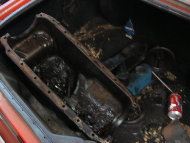

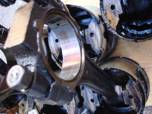

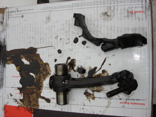

Im surprised to hear that from you guys, ive two rod knocking 318 F-s currently and have a file of 6-7 F-s ive parted with rods laying in the pans. I always surmised it was from the owners trying to run harder then the rod bolts were designed for. Trying to run like a non smog 340. Usually the rod bolts are what caused the bearing failure or just simply not changing oil. Maybe not so much the m@j cars but there are many more F-s without the org. 318 then with, but everyones world is different.
Naa 318-s are easy on rods bearings, just hard on rods.

They must be unlucky or poorly serviced. I can`t count the number of high mile 318`s I, friends and family have had and never had a rod knock in any of them. Sure i have seen them but it was rare..
My ’68 Charger (original 383 car) used oil and smoked bad when I got it. I changed valve seals on it and smoking stopped and oil consumption dropped to almost nothing.

Most likely that result is from using the engine for something other than what it was designed for. I'm sure you're right, the stock rod bolts and nuts are the weak link. In normal use for a 318 the engine usually outlasts the car, especially in salt states. That said, I did have a 318 blow the bottom end out BUT, it was on it's last leg anyways, burned a quart of oil every 50 miles (and was not only valve seals, lol) and had 5 psi oil pressure while driving, zip, zero, nada at idle. Just driving along at 35 mph and knock, knock, KABOOM. Looked very similar to your photo's.

A bit off topic but the two type mopars I used to replace the 318-s in or bought them blown were the 73-74 like cudas and the F-s. Its odd because the rod bolts were all the same but they were beat hard. One of my fun things were if they were already knocking hard and they had another motor for me to drop in, id take the car out and finish off the 318 really well, some still running with six pistons together.
