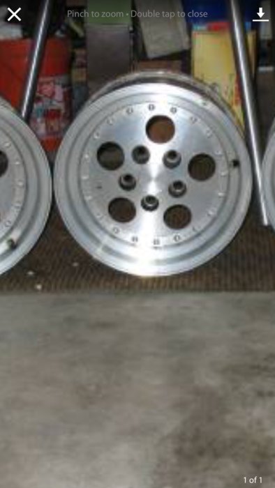

    Hi everyone, any body use jeep gambler rims on a volare ? , i like the rims and fairly easy to find reasonbly priced. I'm trying to keep project on the low.Rims are 15x8 with 5.5" back space 4.5 on bolt pattern , they came on wranglers 96 up to i think 2000, i have 14" ralleys now but want to find 15" rims ,

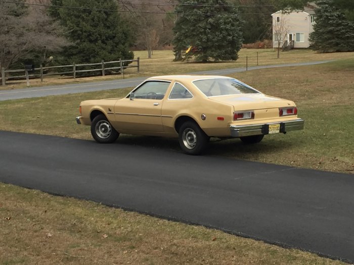

    I am trying to use these rims on 1980 volare

    Jeep wheels have too much backspace and will hit the control arms on the front and make the back look awkward.

    15x8 rims are to big to put on the front,I have a set[6] 1980 only 14x6 factory mag wheels if your interested,center caps,trim rings and enough triangles to do 5 wheels

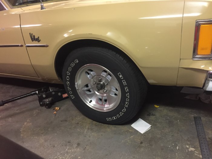

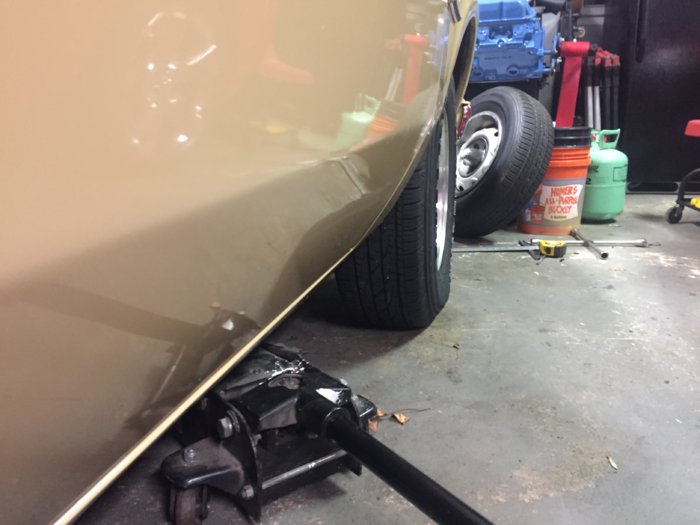

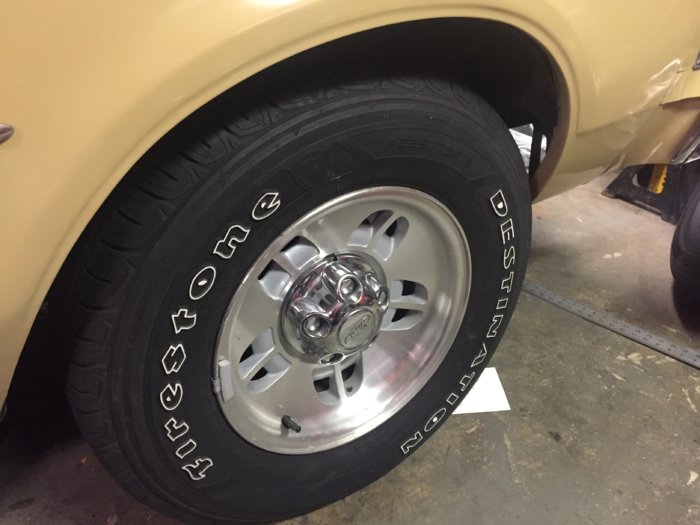

    i put ford ranger /explorerer wheels on , 15"x7" 5" backspace
    tires are 225/75/15 wheel weight close but doesnt hit 2 hacksaw blades thick.

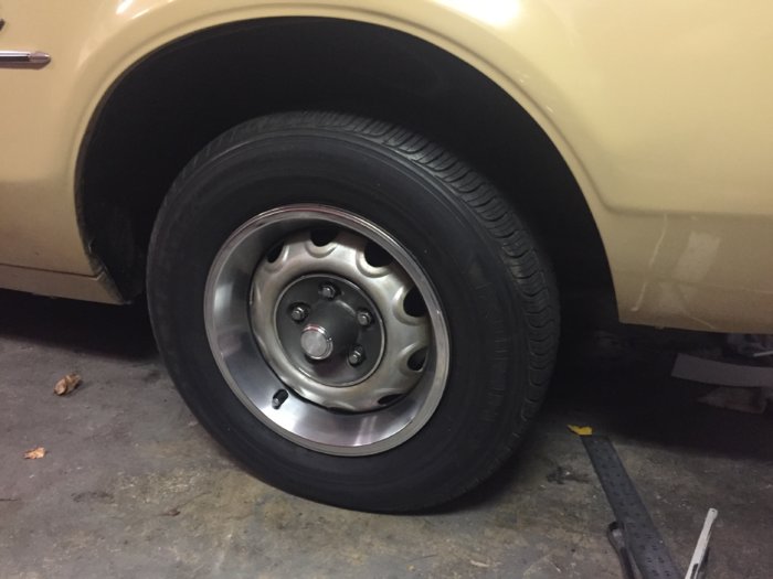

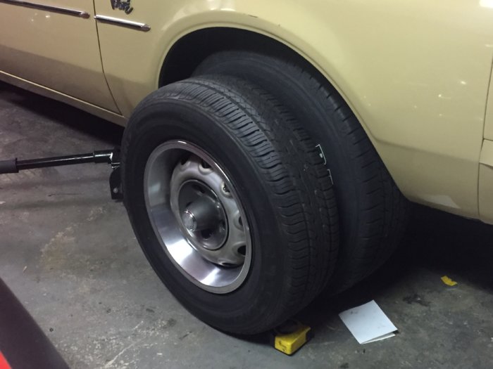

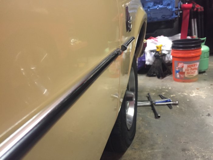

    These are the old wheels, compared to bigger 15"

    Anything is an improvement over Rallye wheels :my2cents: Those actually look pretty good. Is there any way to cover up the Ford center on your current wheel choice? I can hear BillyBob now, I ust to has me one of them Volare Fords. LOL

    Lol. Yes can get a round emblem drill and screw to cover ford logo. But you also need right lug nuts to hold trim cap on. They do fit pretty good. Plentiful rims , and cheap. Plus different styles.

    The wheels do look better on your car, than the vehicle they came off of.
    My only concern is wheel backspace.

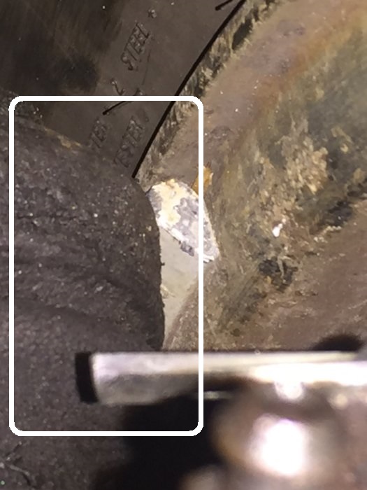

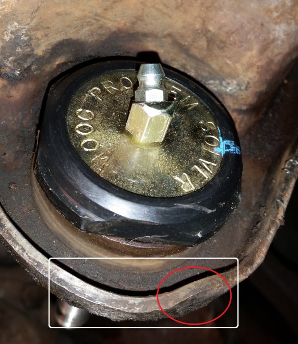

    You commented – but not sure what you are trying to say or where this picture was taken from/at, exactly.
    I'm guessing the white box is the upper ball joint?
    I’ve not measured a hacksaw blade before – but would guess they are about ½” tall. Are you saying the tires are roughly 1 inch away from anything, both front and in rear?
    If referring to the thickness of two hacksaw blades, then things are TOO CLOSE!
    Wheels do flex some (as well as wheel bearing play, spindle flex, ball joint play, etc.) and on hard turns - something will make contact.
    I replaced the L/F upper ball joint on my wagon last year (actually had a wheel bearing failure, and noticed the extremely loose ball joint at same time), which this is a picture of that repair.
    Thirty years ago, I installed 15" Mirada wheels on my ’67 Satellite – and had a similar problem with it. First, the stick-on weights would make contact with the upper control arm. I ended up having to use normal wheel weights. Also what I did, was grind off the outer most edge off of the outer control arm a bit. About a 1/8” bevel did the trick (white box) – so no (or very little) weakening of the control arm would occur.
    In this case, It looks like a previous owner (or repair shop) tried to do something similar with a hammer (red circle) – which might be another possibility for you – but I don’t like using hammers on sensitive car parts.

    thanks for info Bud,your pics and info are great, the wheel weight is close to upper ball joint about 3/16" , but if wheel weight was moved inboard of rim, it would have at least 3/8-1/2" clearance . so should be ok or a 16" or 17"rim would clear ball joint as well , these rims have 4 7/8 back space,from what i measured, ford forums say 5" is back space, these are 7" wide rims. i like the 10 spokes you have on the wagon, finding factory rims with less than 5" backspace seems to be hard to find, mustangs have nice wheels but offsets are 30-50 mm, i really don't want to use spacers, and want to keep cost down . Thanks for all the info
