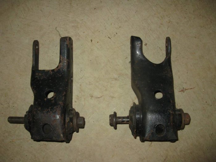

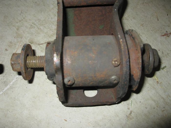

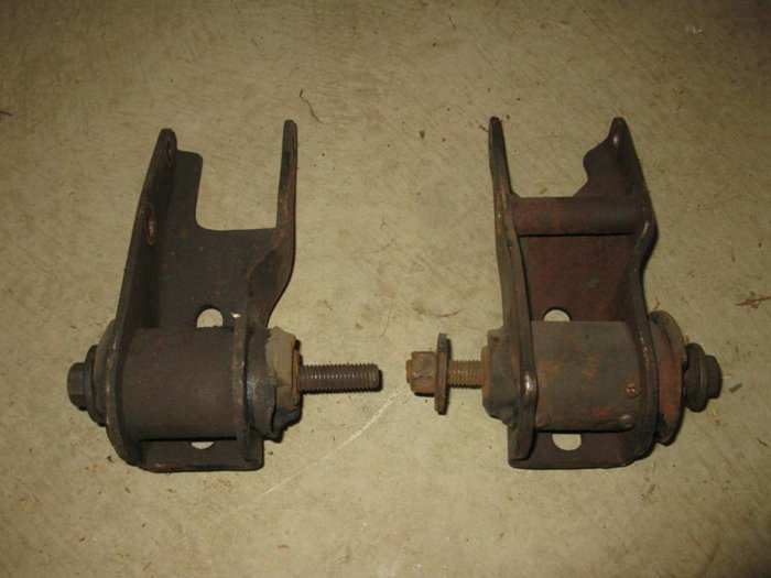

I made my own driver side mount by modding a big block spool mount, and didn't have to notch the k engine mount. There were no aftermarket parts to do it back then. We live in a good time for car parts.

I did something similar to the drivers side motor mount in my 77 RR when I dropped in the 413. The spool mounts have a tin covered rubber insert. I peeled back the tin lip part and moved the rubber part forward a hair and pinned it with set screws. This was strictly 1980, low bucks. No Schumaker back then. Worked just fine.

I actually cut the drivers side mount in half, moved it forward about 1/2" re-welded and added some gussets.
