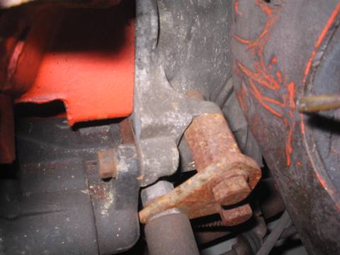

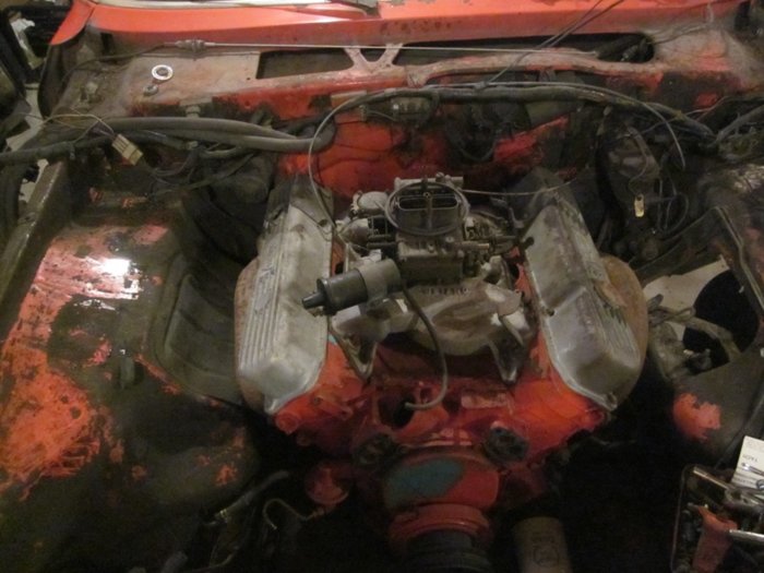

I won't argue with your insight, because, I actually know that you are right. HOWEVER, my 25 year old self in 1980 didn't know any better. My 25 year old self out of lack of funds and ignorance made the big block fit with the mods to the drivers side motor mount and tranny mount.
Question:
Did it run?
Answer:
Yes it did.
Question:
Did it run GOOD?
Answer:
Oh, HELL yeah!
I'm sure it did, I just thought it should be said how it should be done. I've seen swaps that didn't look correct under the hood because the builder didn't have a clue. Then you run into harmonics and trying to figure out vibrations.
Do the Schumaker mounts maintain correct engine placement?
stock trans mount will work and use that to set engine mount location fore and aft.
