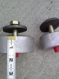

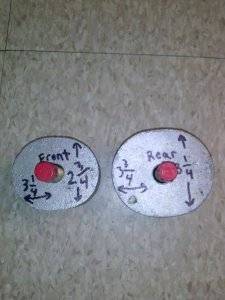

I would appreciate very much if you will give me the thicknesses of the one that is the spacer between the k member and the frame rail.
Thanks Tom

NO PROBLEM TOM.
I'LL GET YOU THAT INFO TOMARROW, WHEN I'M BACK IN THE SHOP.

Firm Feel aluminum mount dimensions
