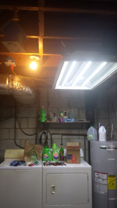

Got me another 6 pack of shop lights. I put a pair (so far) of the lights in the attached garage and, holy crap! The 4 flourescent fixtures together only made half as much light.

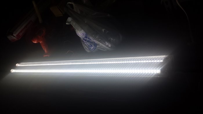

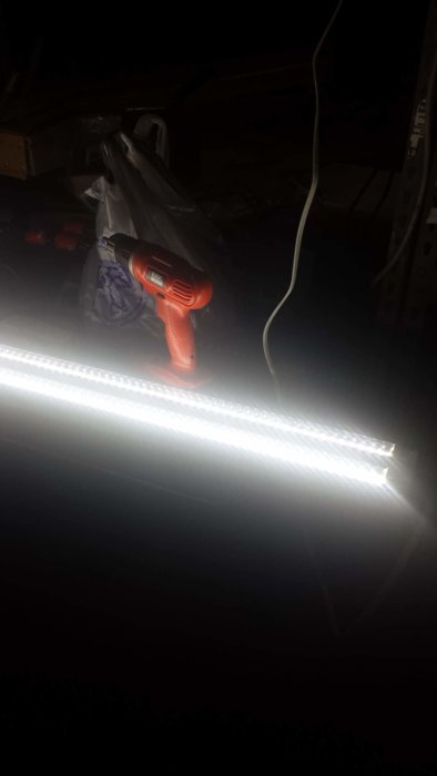

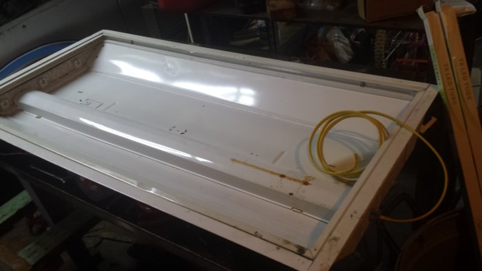

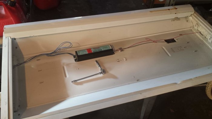

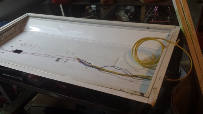

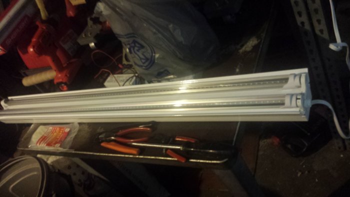

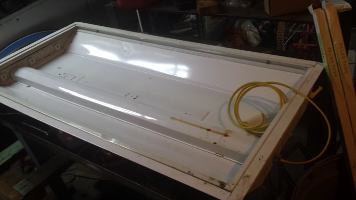

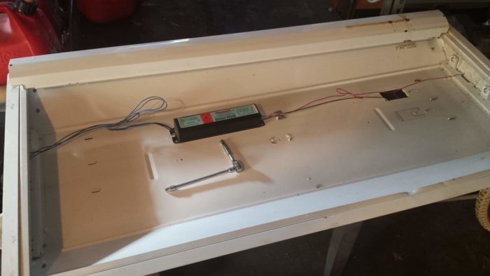

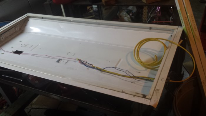

I just ran across this thread..... What are you doing with all your old light fixtures??
It's way cheaper to convert your old lights over to LED's.... it only costs you a bag of wire nuts and new bulbs......
Matter of fact I buy the cheapest 2 bulb fluorescent light (4') strip and convert them over to LEDs.....
That's one I got from a building being torn down......
View attachment 36832 View attachment 36833 View attachment 36834 View attachment 36835

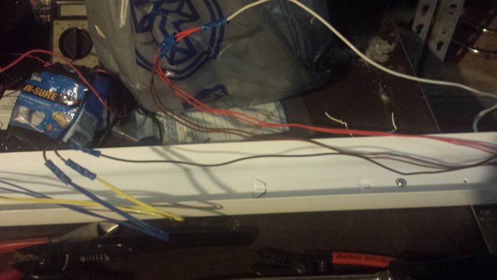

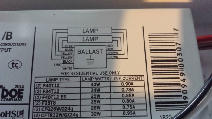

Maybe I'm just a little behind on this, but how do you convert them?
Very simple.... cut the ballast out and dispose of it....
I use all T8 double ended bulbs, so take all the wires coming off the tombstones (that is the part that the bulbs (1 or 2 prong) insert into) and connect one end to the black (hot/power) wire and then take all the other wires coming off the tombstones at the adjacent end and connect them to the white (common) wire...... install led bulb's and instant LED lighting.....
Hard to see but here is a few pics.....
Interesting. I did not know that the LED bulbs were direct wired to the 110 line. Surely they do not direct wire the same bulbs in countries that the standard is 220?
So why is it that all of the screw in bulbs from 40 watt equivalents to large commercial 200watt equivalents all have to have transformers inside of them?
