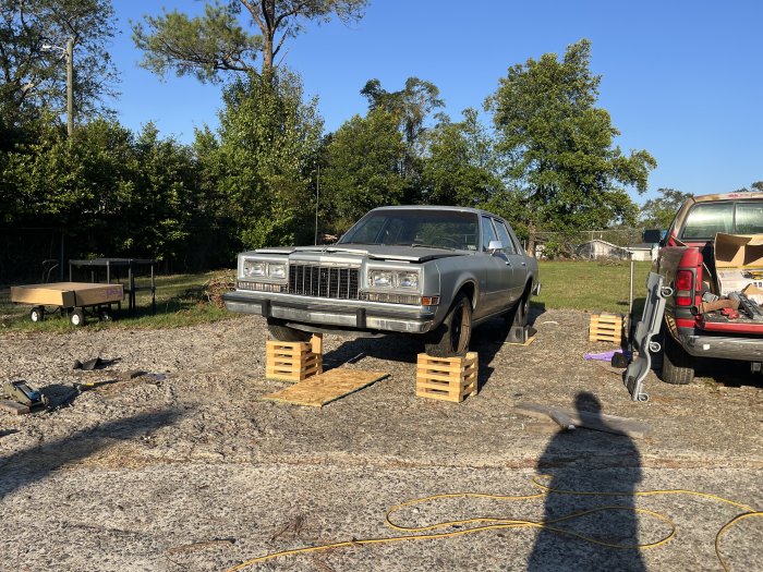

After quite a bit of finagling with it, the car is *finally* level. (Or at least it’s all within a degree according to my phone’s app. My backyard does not have a level spot in it.)
Next weekend I can weld on a pair of subframe connectors to it.

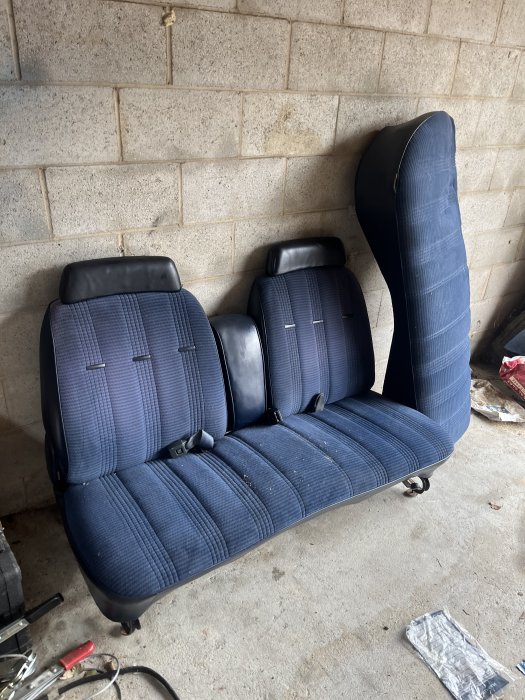

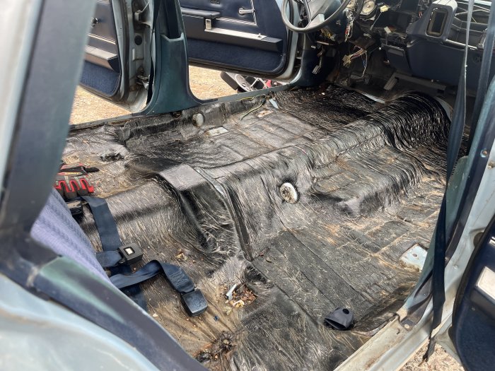

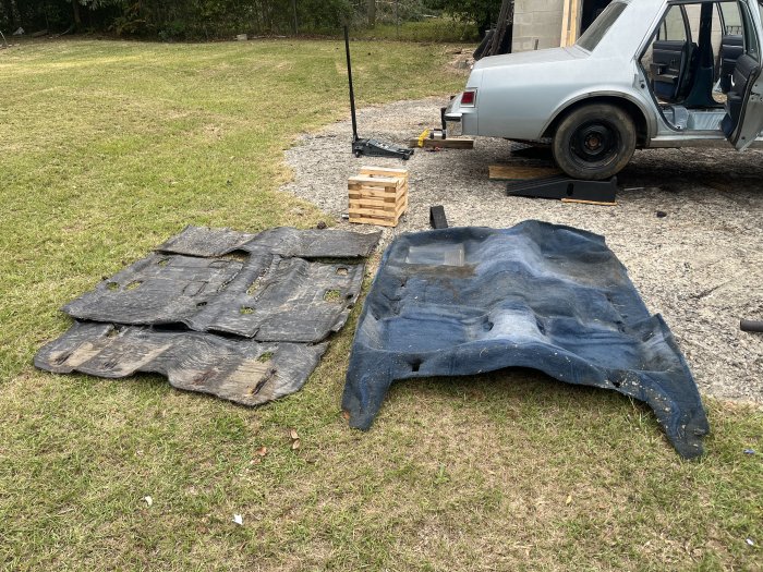

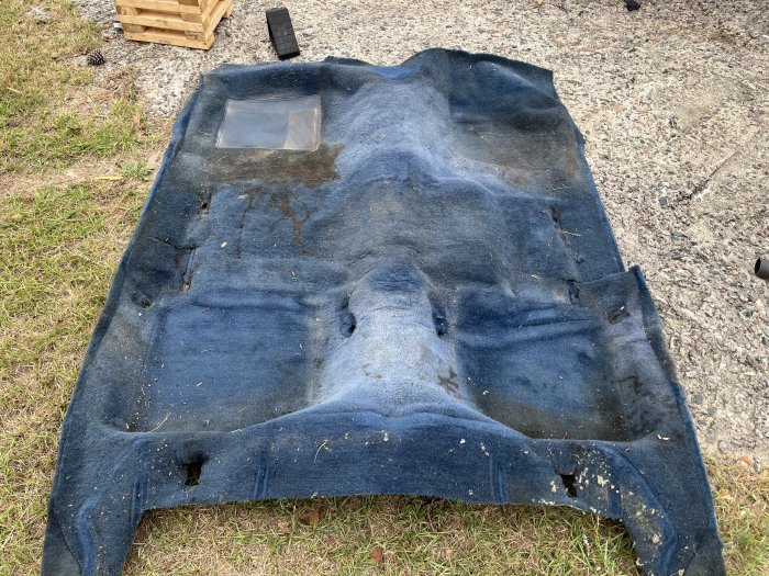

Progress!
....I forgot how heavy and how much of a PITA the front seat is to take out of these.
The shifter boot is from a K-car Daytona. :p
Back seat, Carpet, and the rest of the dash comes out tomorrow.

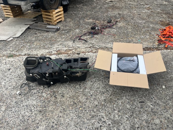

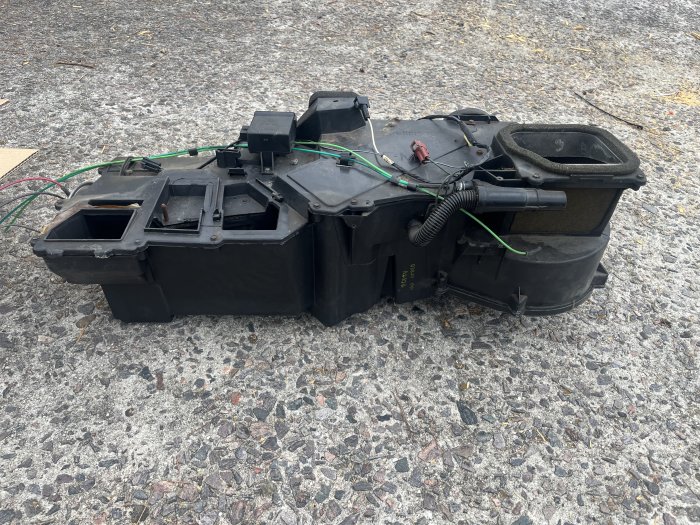

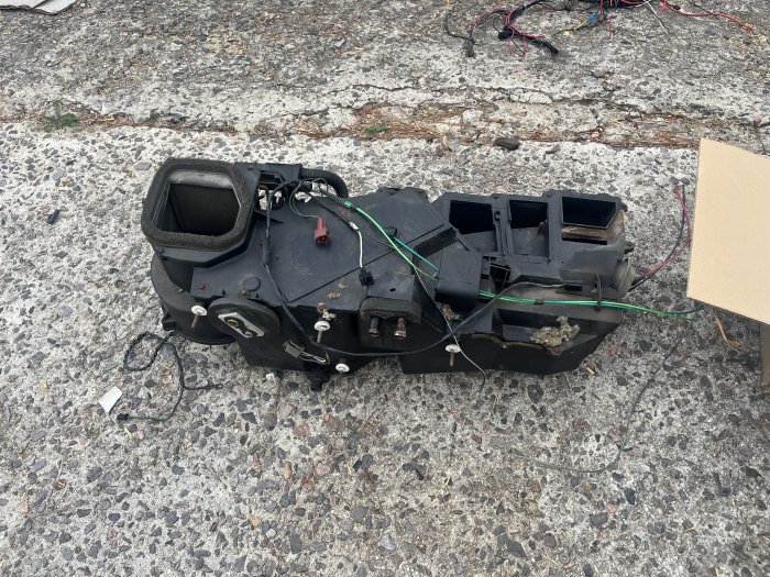

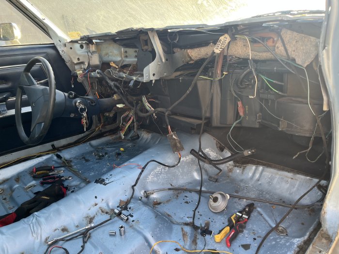

The dash is mostly done, but I’ve hit a snag: the HVAC unit.
I really wish it could’ve all came out at one time like when they put these things together at the factory.
2,991
Stuck on defrost can be caused by no vacuum to the controls. Defrost is the default mode.
Carefully check your vacuum harness, and especially the tube going to manifold vacuum under the hood.
1,830
1,035
Is the blend door on that car operated by a servo or vacuum? Mine stopped working because the electrical connector lost tension on pins for the servo control board. I scuffed the pins a little and added solder to build them up. Been fine for 12 years now.
Lightning II
Sep 24, 2020
239
108
Augusta, GA
Looks to be vacuum-operated.
I think so.
img_3444-jpeg.54500
img_3446-jpeg.54501
it's a monster compared to what's going to replace it.
img_3445-jpeg.54502
