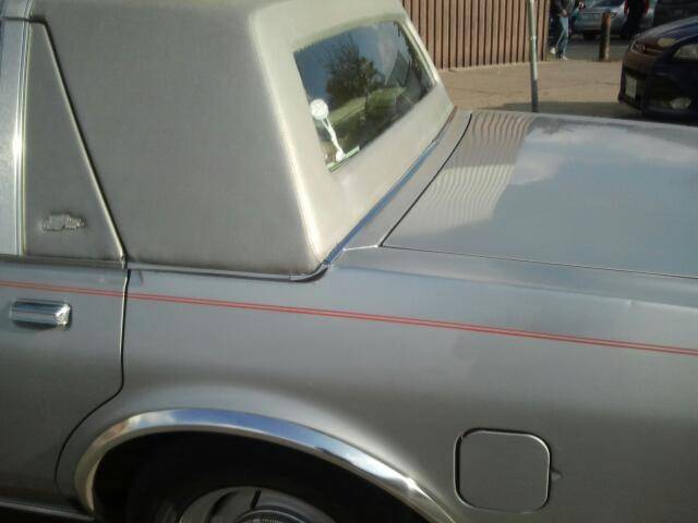

Luxury Cop Car

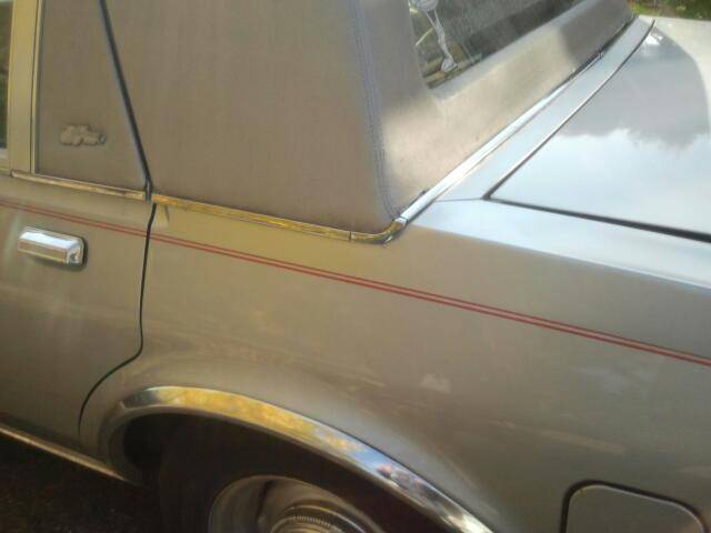

That looks really nice. You cant even notice any kind of repair that has been done to it. Nice work. :icon_thumright:

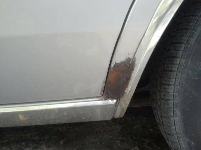

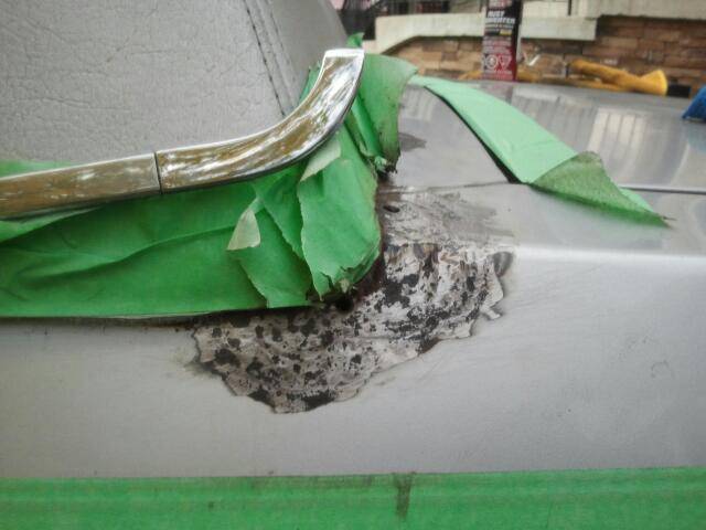

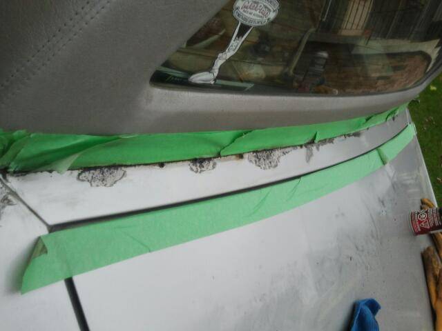

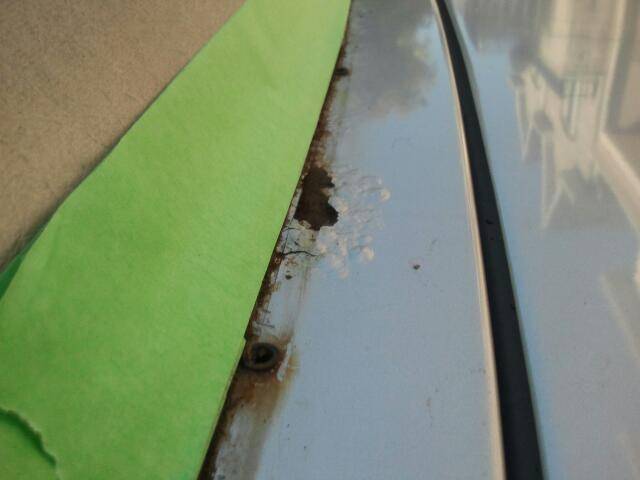

Here's what I started with after pulling the trim.

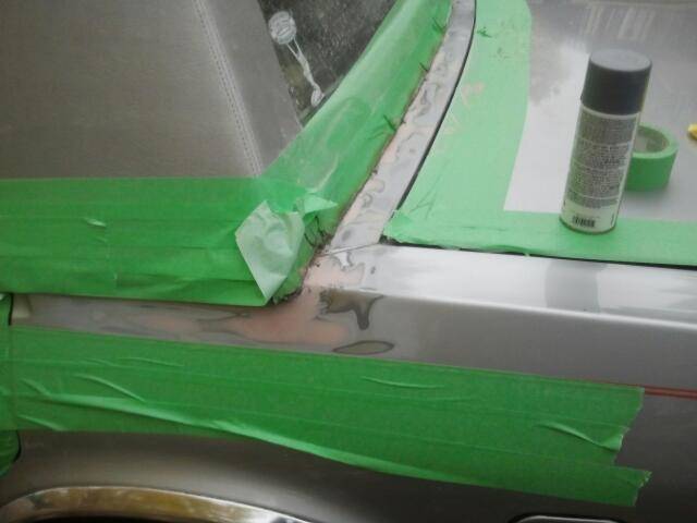

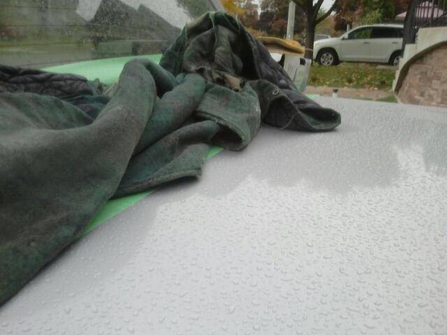

Now....other than the gale force winds...what could make things easier?
Rain of course.....forecast today was mostly sunny....

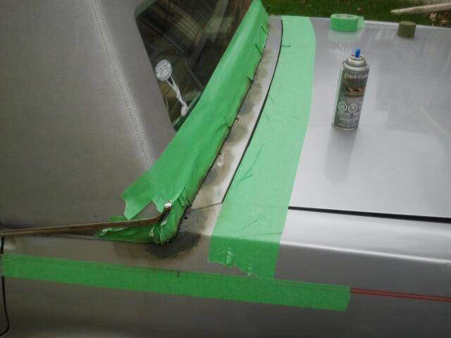

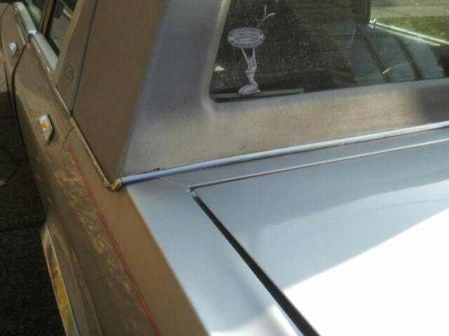

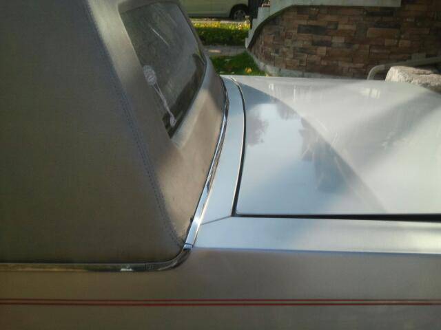

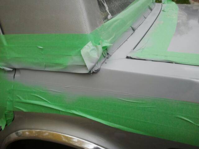

Gave it the duplicolor touch and got all the trim on.
Overall....not so shabby but I have some wet sanding to do tomorrow to make it pretty.....

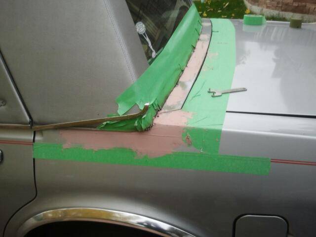

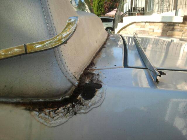

Had to dig in as far as I could to get the rust and couldn't help biting the vinyl a bit....silicone.....
It's sealed and a hell of a lot better.
Won't win gold at the Nats but....it'll do for now....
So....tomorrow is wet sanding and buff.
Then silicone all those pin holes that the trim goes into so it doesn't just start again. Then hopefully finish the rest of the spots I need to do so I can get it oil sprayed before the snow flies....

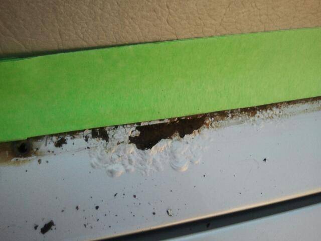

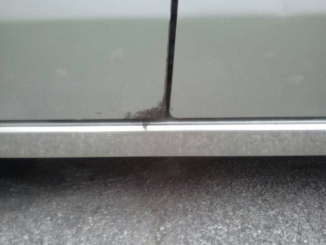

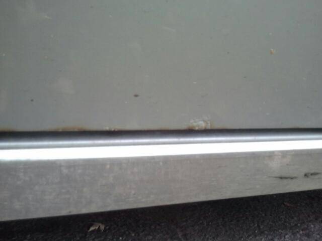

The stuff around the vinyl was a beotch and that's sealed.
Have to do one dog leg and the bottom of the passenger door.
Only thing that looks like a drag is two spots that butt up against the windshield trim.....I really DO NOT want to take that off but it looks like I'll have to. :eusa_doh:
