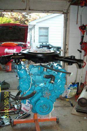

Well I'm finally under way with my 81 ls project. The 360 is together on the engine stand, and I can hardly wait to hear it say "rumpitty,rumpitty,rumpitty..... I want to post pics of my progress, but can't seem to figure out how. don't know what the url ? is ? Any help would be appreciated.

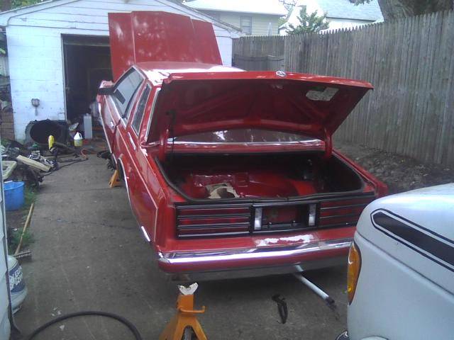

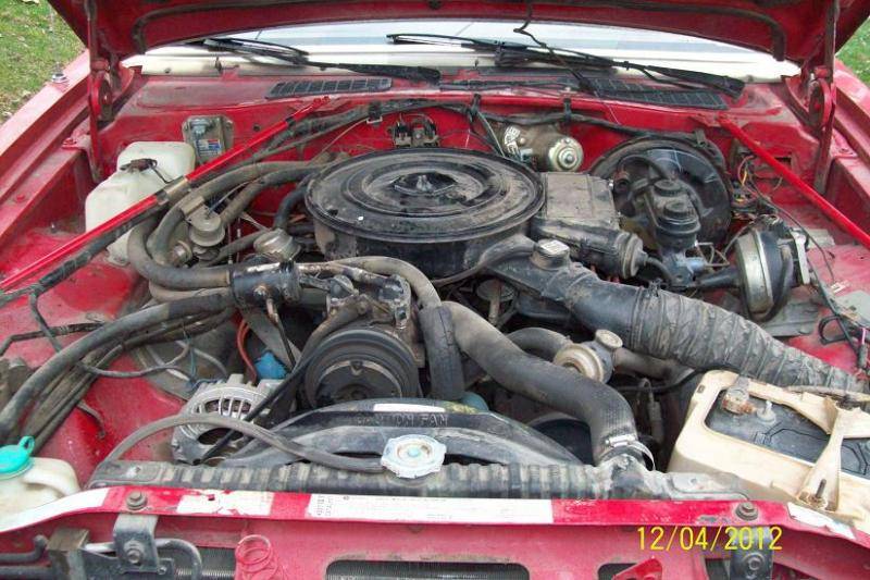

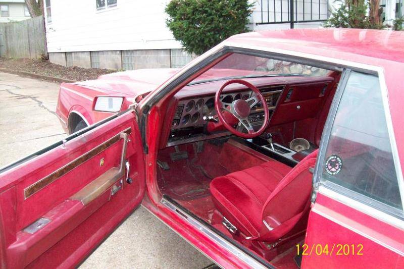

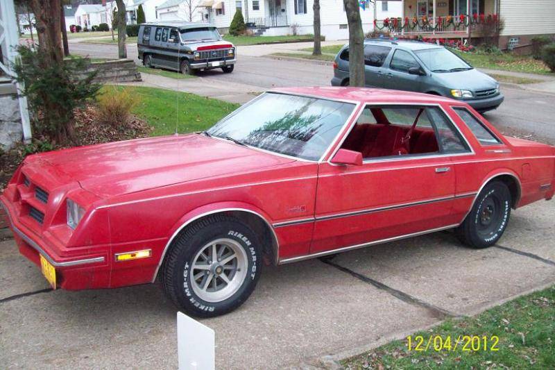

This is the ls after it came off the trailer

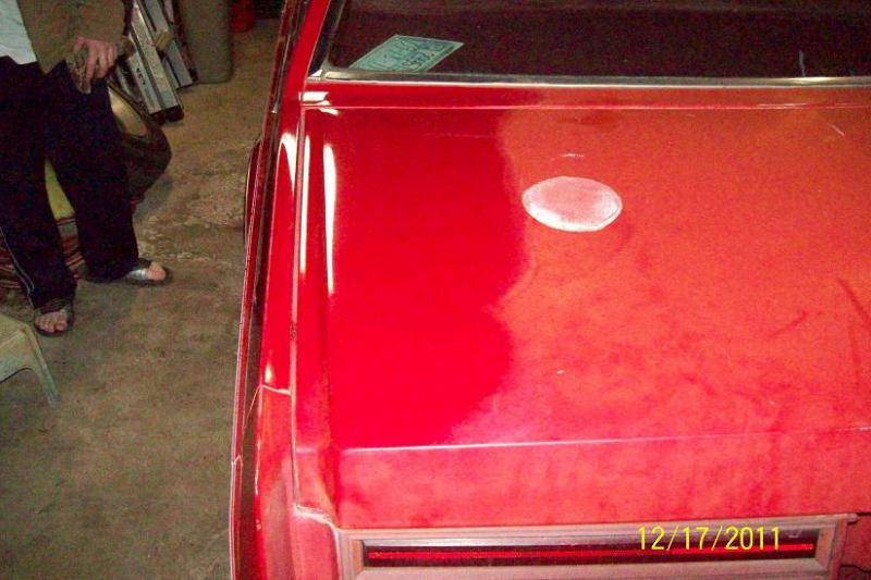

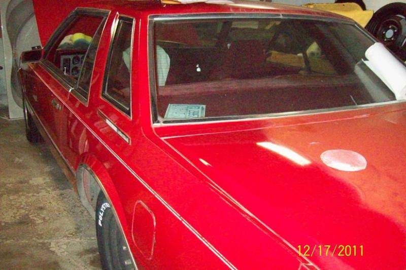

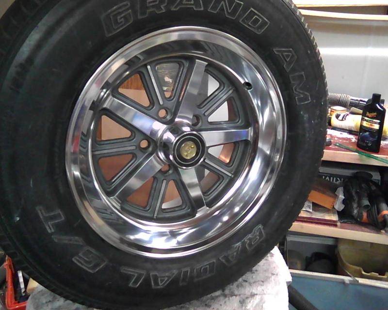

Doing a little cleaning to see if the paint will come back.... that would be a yes!

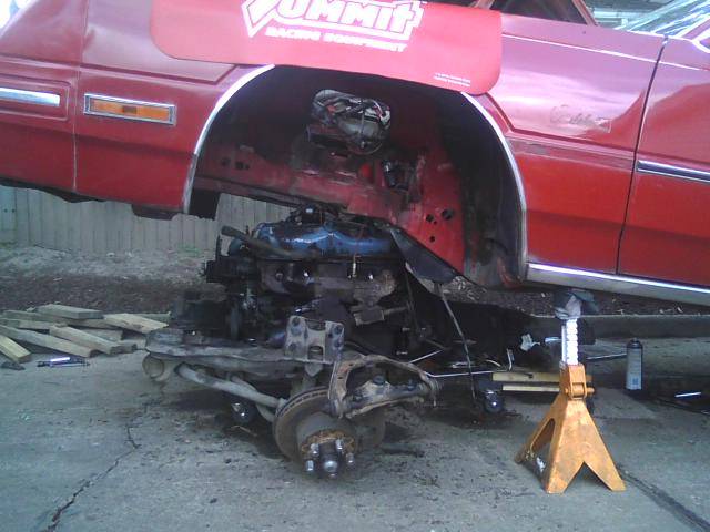

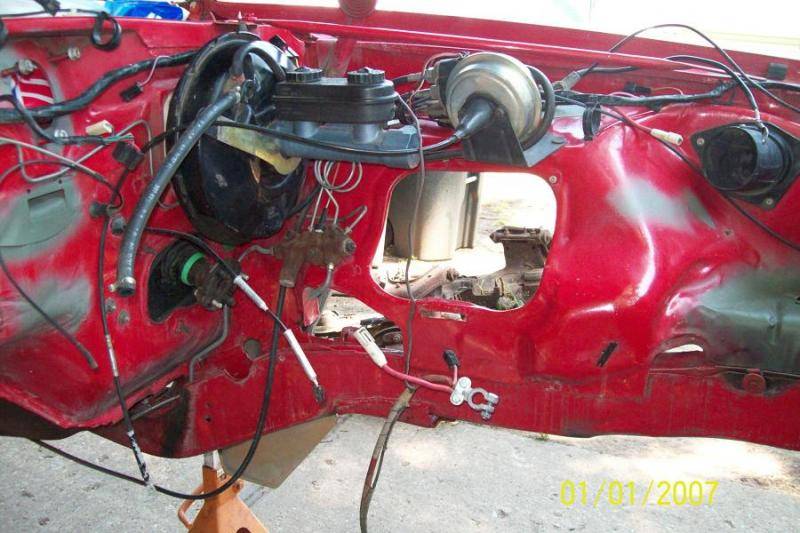

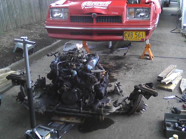

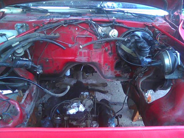

Engine, trans, k-member removal. Not going for a full repaint of engine compartment, I think it will clean up nice.

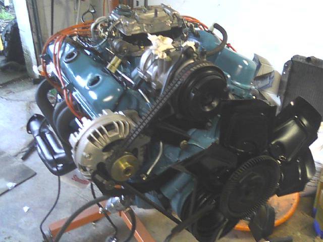

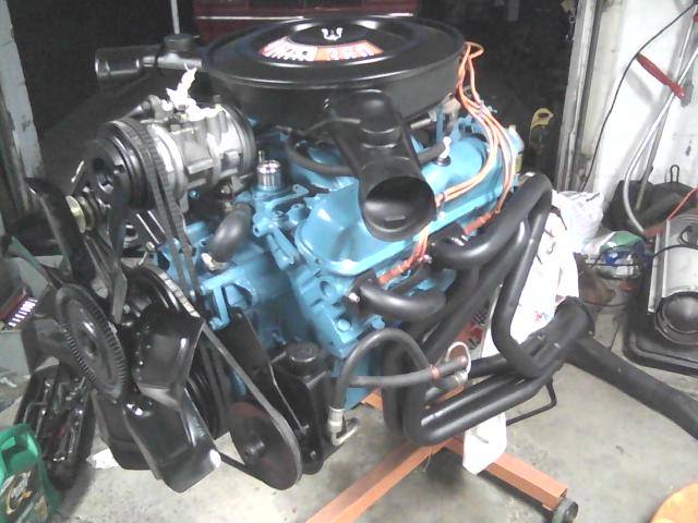

Heres the engine: 71 360 40 over 484 cam flat top pistons edelbrock intake rebuilt thermoquad 1 5/8 headers . Going for a semi factory look. Made my own dual snorkel air cleaner by taking the snorkel from the 318 and welding onto the 360 air cleaner. will add fresh air hose an passenger side later

WOW!!! Paint may survive for a bit yet... Looks great, hope ya can get a vid posted with the rumpity rumpity rump a singin' for us to hear...

Everything looks great, I'm liking that 360 too, curious to see how it runs. How did you build the bottom end, factory, after market, did you balance it, what converter, and gears.
jasperjacko
Dec 4, 2011
1,672
251
Engine was balanced with sfi flex plate and neutral balance converter. I have a 904 lockup trans but not sure which way to go on that yet. Also have a 3.55 suregrip 8.25 rear that will more than likely be going in. Car still has 2.2 8.25. I'm going to dissassemble k-frame/suspension to replace any worn parts and refinish components. After installing engine/trans and working out any bugs, I'll move to the rear-end

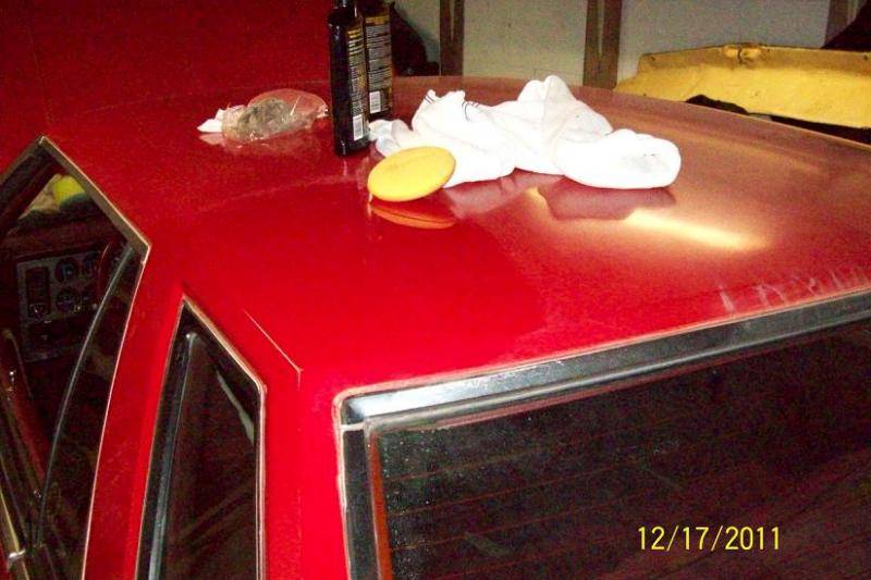

I used red and white compounds, then mothers polish with the red ball and a drill

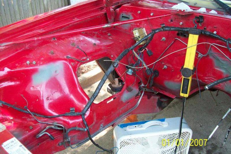

Here is the engine compartment degreased, and spot primed. Was planning on just touching it up instead of repainting. What do you all think?

You MIGHT get away with the spot repairs, but more than likely you wont. It may end up being spotted looking...
