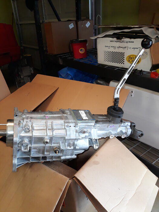

Well, been acquiring parts for the next phase of Modoba. Started the 408 engine build, but it's on pause until we get moved into the house that we bought 2 years ago. Hoping to get back on the car this fall. I will be doing the engine build and other updates on this thread going forward. Some here may remember me talking about putting in 5 speed manual, well that's going to happen. It was just shipped the house the other day. It's a Tremec tkx from SilverSport.
Did some preliminary measurements and looks like the mount and yoke are very close to factory position. Should not need excessive tunnel mods.

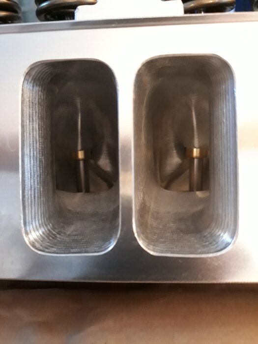

Had a little time to do some test assembly on the 408, and found my pistons are about .010 above the deck surface. Turns out my stroker kit is for a la block, and I have a magnum. Is a thicker head gasket a legitimate fix for the situation? Hoping to hear feedback from all the engine builder guys here. thanks.
