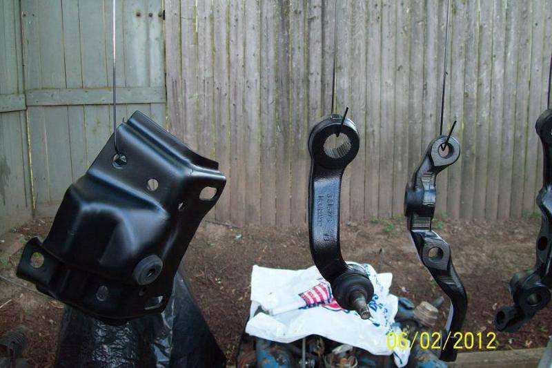

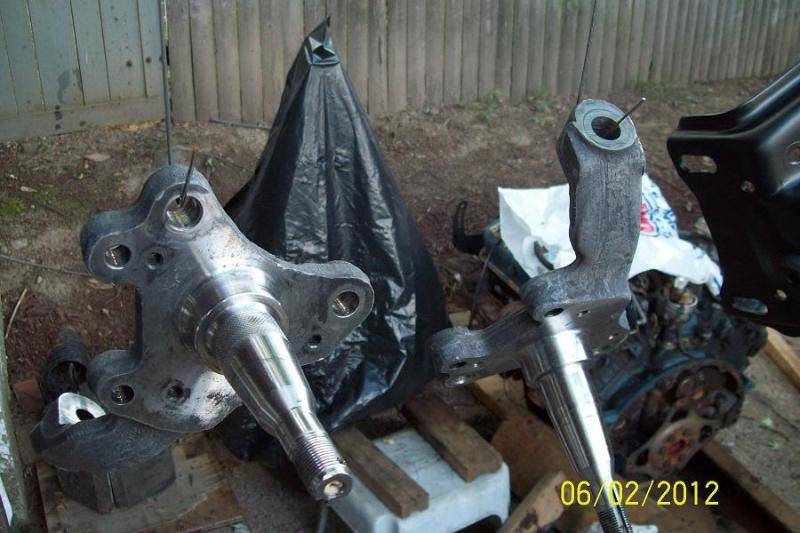

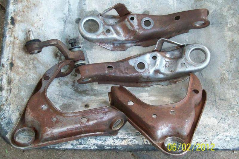

Here are some suspension pcs. after degreasing, soaking in evapo-rust and painting. the control arms are just degreased, I'll post pics tomorrow after they spend the night in evapo-rust. If you guys have never used this stuff, its AWESOME!! The spindle pic is after being soaked for 3-4 hours then washed.

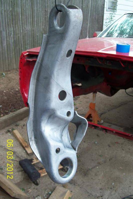

heres a lower control arm after soaking in evapo-rust

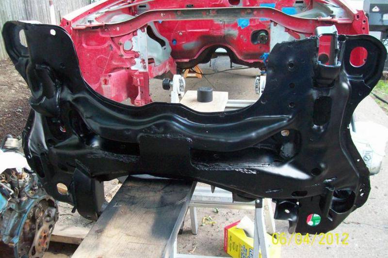

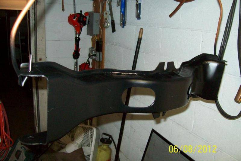

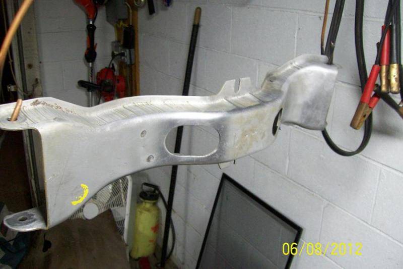

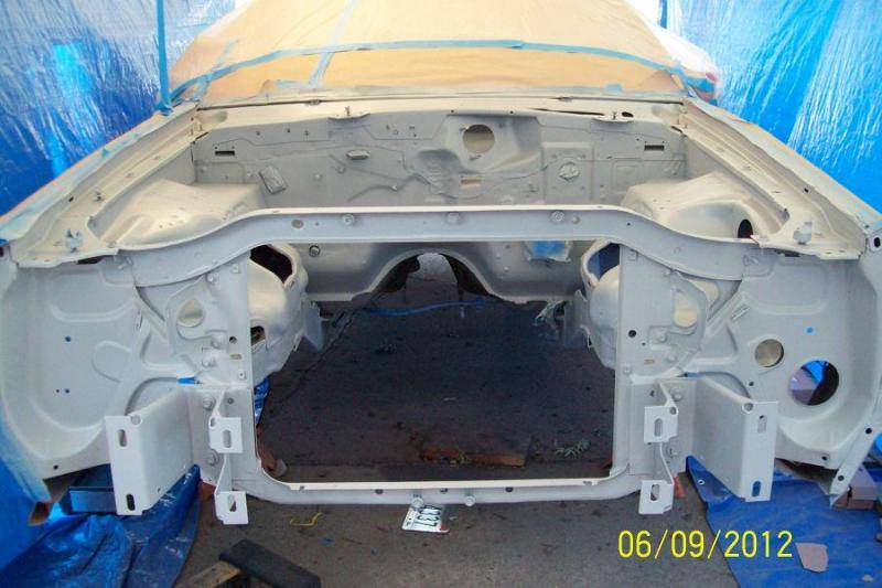

if all goes well, should have the engine compartment in primer this weekend! You guys know anyone still making suspension parts i.e. bushings,balljoints etc. in THE USA!? would rather not have import junk. Not to exciting, but heres pics of the trans crossmember...weeeeeee!

Good deal. One big problem though. The engine bay will look so good you will want to paint the entire car.
