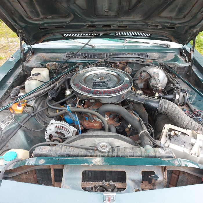

Oh dear me what a lot of work done and still struggling to make it running as it should. I noted one thing that I want to comment.
I have this G22 1978 bought in 1991 and ran till 2000 when mothballed. Pulled out again in 2022. Mid 1990 I threw out the Spark Control Computer and replaced everything needed with the Electronic Ignition system as per attached photo. Threw out the Thermoquad carb that caused some idling problem (The importer could not get it run properly; I did!) and put a Edelbrock instead. Ran perfect all those years before stored.
Then when I started to renovate her in 2022 I bought some new items from Rockauto. You see them in the picture below: Ignition module to the left and the control module in the rear of the window washer tank. (Sorry I have forgotten the names but I am sure you understand) She ran as in those long gone days.
Then to the point:
A new coil and ballast resistor bought from Rockford as they advice to do so (cost was only coffe money). Replaced those items and started her up.
She started all right and warmed up most at idle for a while. Then: Shifting gear to drive she struggled and struggled and hardly ran at all. Just as this one. Hmmmmm what to do? A cup of coffe and a short rest. Then I checked it over again and the only thing that was different was the BALLAST RESISTOR. The original in the set had two point connection but the new one had four. Old one dusted off and replaced the new one. Hey! Presto! Back to normal and long gone days.
She now runs and idles perfect as she did and should do.
So: What about the Ballast Resistor??? According to Rockauto the new one should be compatible with the old one. NO!!!
