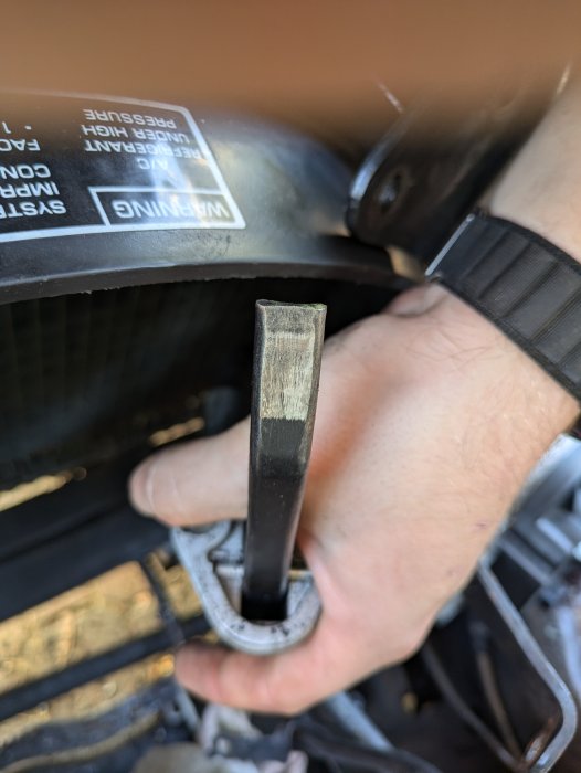

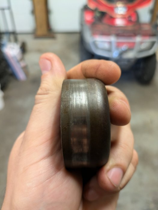

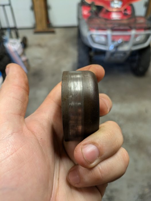

Where the eccentric contacts the pump arm is smooth as a baby's bottom.
Width of the contact mark on both matches in width

I bet that pump arm is riding around in an elliptical pattern and not just straight up and down, and as it completes a revolution it kisses the chain

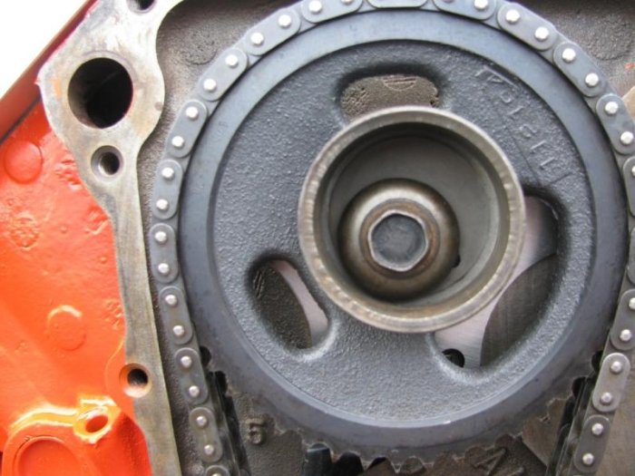

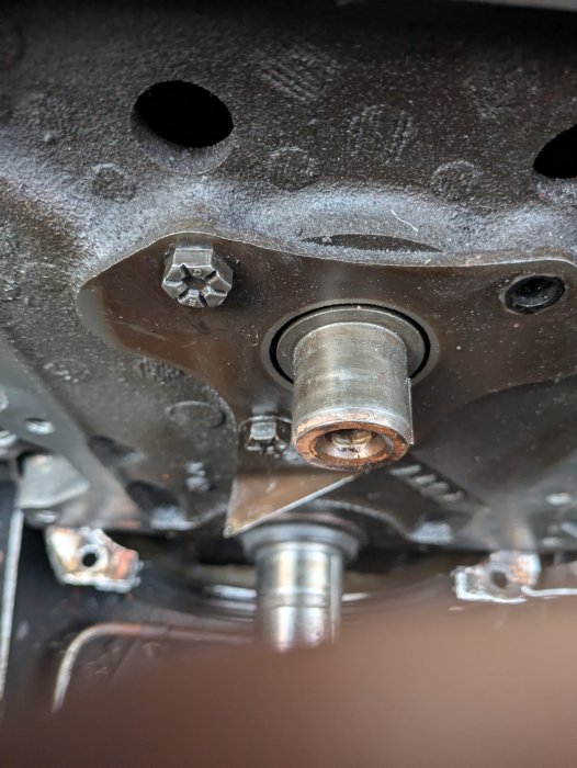

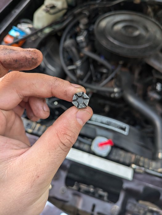

I got poking around a little bit and noticed something, pics attached. Isn't at least one of these bolts for the plate supposed to have an oil drip hole? Because none of them do. Or not needed?
2,992
IIRC, the lower right (looking from the front) thrust plate bolt had the hole. Later versions don't have a bolt, just a locating tab on the oil baffle (brain fog on the correct term) that goes in the the hole. That's where the chain oil supply comes from. Can't see yours in the pic, but would imagine it uses the tab.

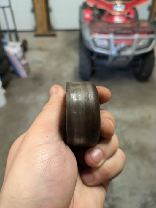

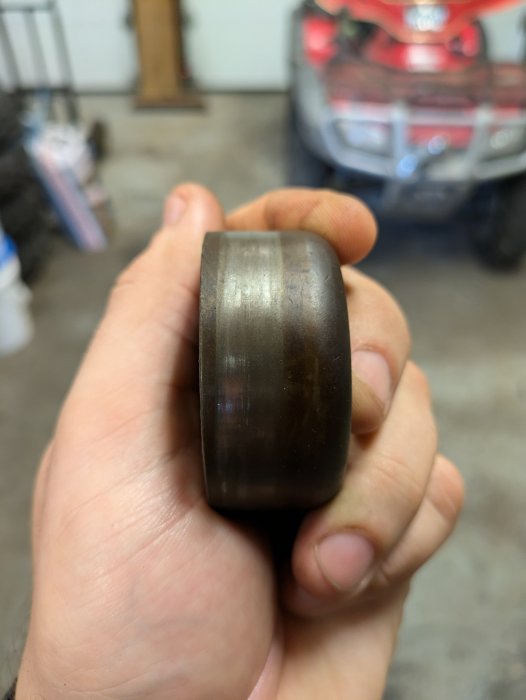

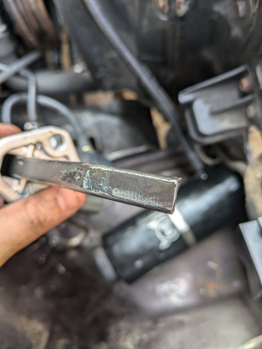

Can't adjust the fuel pump any more than 1mm at the bolts, doesn't make much if any difference. The fuel pump arm has plenty of oil on it after running, plus some splashed up into the fuel pump hole, not even counting the break in grease I applied to the arm. Picture of the pump arm wear after a few minutes of running. Looks pretty consistent to me. There are no scratches or marks on the sides of the arm. Though it is strange that the wear pattern is on the side opposite from the eccentric mount.

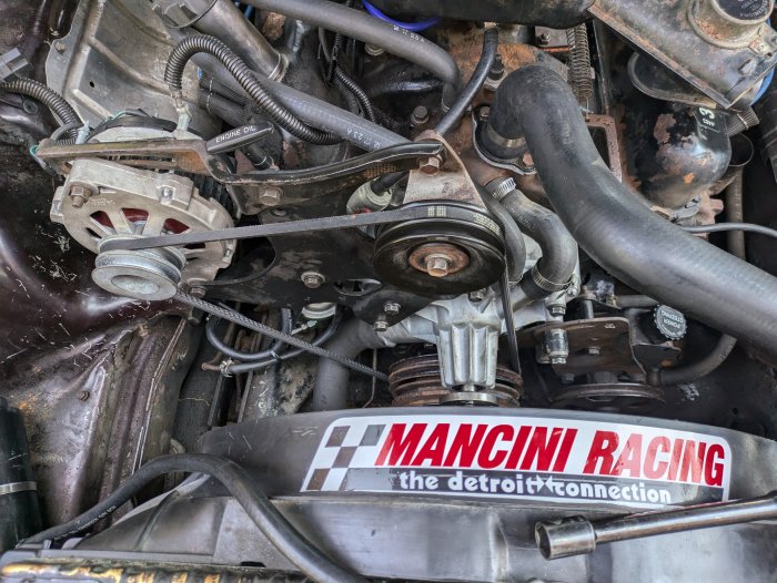

But to sum up new melling OEM chain which is the exact same design as the one I took off, replacement mancini timing cover/and tested with old timing cover, oil slinger added, new Carter fuel pump. Only inside part not changed is the pump eccentric.

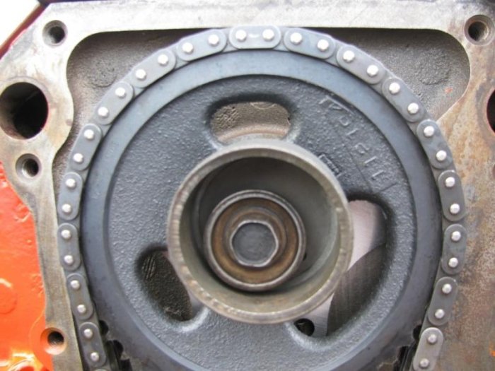

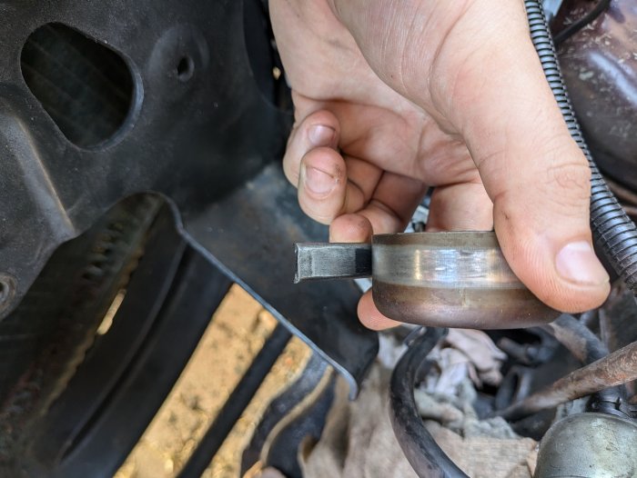

That pump wear still looks really wide. Stupid question, which way did you put the washer back on the eccentric?
AMC Diplomat
Feb 14, 2023
1,744
826
NY
Stupid answer, Second picture, with the cup facing in and covering the end of the cam.
Well, my only other idea is that whoever did the timing chain before used the wrong eccentric and that's why all these fuel pumps are chattering, but that's a huge speculation
