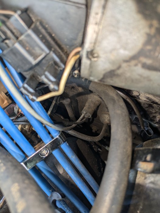

What are these two vac lines in the middle of the picture? Black one goes to the vacuum tree. Gray one goes to the heater hose teapot
There are vacuum lines that feed the heater controls and the heater valve on one of the hoses. That should be the only stuff needing vacuum passing thru the fire wall.
Thank you, the black one that runs to the vacuum tree, it's connector broke off at some point during my recent engine work. Gotta figure out how to re-attach it lol

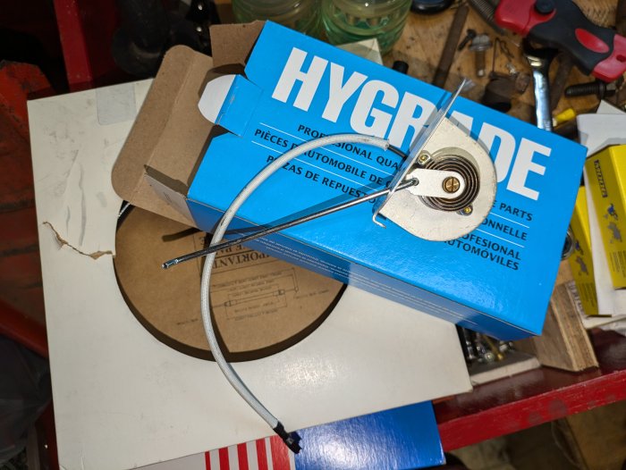

I got a new choke thermostat to cover my bases, and it doesn't fit. I swear it feels like I'm beating my head against a brick wall with this car sometimes. Rod length seems to match but the inner thermostat itself sticks out and stops it from seating.

I guess I will have to try and source a new choke thermostat. That one I got, yes it looks right but the plastic on the inside stops it from mounting where it should. I would have to grind about an inch off the chokes home if I wanted to make it fit, and I'd assume that could introduce even more issues.
