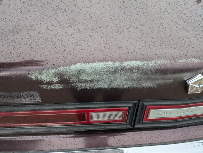

Unfortunately it's raining so this picture isn't great. This is the trunk paint, I'm unsure if it's paint that's discolored, or it's the primer underneath, or something else. The weird eggshell white textured stuff.
If it has been exposed to a lot of sun, it is probably primer. The paint, in areas that are very bright and the car sits outside, will eventually get burned off (what I call sunburned). I think it varies with the angle of the sun (horiziontal surfaces tend to burn faster than vertical), the ambient air pollution, and the paint thickness (which will vary all over the car). Are there any other surfaces that are looking rough, especially, the hood and roof? If so, they are on their way to having the paint burn off.
If its been indoors all of its live, it could be just paint failure, or if it is a clear coated paint, possible that the clear coat has failed, and the colour coat is now failing below it. Colour coats beneath clear coats don't seem to last very long after the clear coat is gone.
So surprisingly no, this is the only area that is this bad, higher on the trunk lid is perfectly fine, and the roof is damn near untouched.
The hood on the other hand, some spots (about 1.5ft both sides and a little in the middle) the clear coat has clearly worn off a bit, cloudy marks. But nowhere near as bad as the trunk, still mostly the proper color.
As for storage it was stored outside in a lean-to(makeshift wooden tent basically with a tin roof) for around 10 years and then I got it, it has been stored in a garage since until recently.
I only saw pictures, but I think that the rear end was exposed a little from the back of the lean-to. So what action should I take to try to correct the paint?
It looks like the roof of my '96 Dakota. The clear is baked and deteriorated. There isn't much you can do at that point other than sand it down to an intact substrate (primer, or even all the way to bare metal) and repaint.

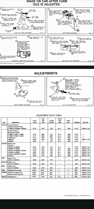

I adjusted my carb entirely, went back and redid all possible adjustments mostly focusing on the choke and thermostat stuff, she definatly runs much nicer on those morning starts and not as much rolling before start either. Set to 2.75 turns
Before I say what I am about to, I want to make it clear I do understand that most carbed motors have a hard time in cold weather, or cold starts before they warm up a bit. But I've never had one have this kind of issue.
It will still stall out, now I'm not trying to leave right after it's started or anything, I still wait a minute or so. Again once it's warm it's happy, at least the 1st line of the heat gauge.
I am also having an issue with idle, I have it set to about 660(vs 630 the hood sticker calls for)
At stop lights or anytime I stop in drive/reverse, assuming my rpm gauge is reading correctly(rpm on the gauge matches rpm on my fancy timing light so I'm assuming it's right)
I will watch my rpm drop to under 500, now it doesn't FEEL like it's going to stall. But I can feel a little jolt every second or so from the motor. I wish I could get a digital reading to have an exact number but...stop signs lol
Now if I were to slap it Into park the idle goes up to the 660rpm as normal.
After all carb adjustments, I redid my timing. It's set to 8°, had my father rev it to 2500-3000 as suggested and if I remember right it advanced up to 33°. My father has a slightly weak foot, he is getting old. But he held it as best he could, so it did jump a tiny bit back and fourth as he lost it and brought it back but I never saw it go stupid high or low.
At idle it sits pretty at that 8° and hardly moves, if it does it's 1mm at best.
I'm not feeding it more timing as it seems happy at that, at least not until timing chain gets done
I mention the in gear low idle, and the still stalling while warming up as I figure the two things are likely related.
I'm guessing that it's still something to do with the carb, but any other ideas throw them my way please.

It does sound like carb issues still. What it came off of can also have a bit of an effect, how it was jetted etc.
I didn't even think of that
It was off an 80s ram charger 318, it had no idle stop solenoid or anything electronic attached to it.
Also I'll attach a pic, I have been following the 1986-87 passenger car specs to adjust my carb, as they seem to match closely to my hood sticker and vehicle year.
Oh being a truck I wonder if it was jetted bigger, putting to much go go juice in with the 2.75 turns.
Oh and just to rule stuff out I replaced my main vac lines (the fancy red ones) with blue rubber ones. So no collapsing even remotely possible.
Hopefully the pic is legible
