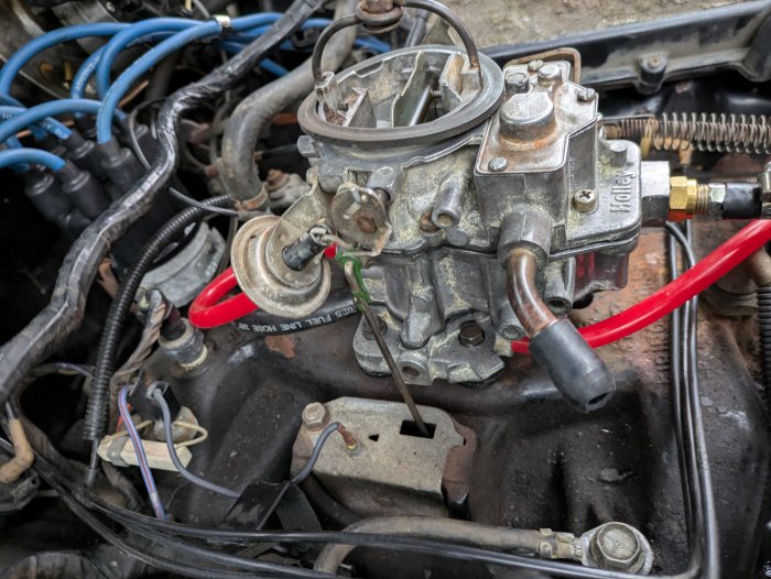

Ok got 3 days off and I'm trying to use them as best I can.
Spent an hour or two going over my ground connections, cleaning with a drill and wire bit. Dialectic grease applied
Freshly cleaned 2280, I spent last night rebuilding and putting it together, however there is no way for me to transfer over the idle control solenoid, no way to mount it? It has been put on the car, and tested today. No leaks, And yes I made sure to hook up the emissions lines correctly since the 2280 and 6280 the rear ports are swapped (pcv goes to left port instead of right when looking at front of carb)
BEFORE testing, I actually went up to the scrap yard again, and I found a fuel control computer, wasn't paying attention to what it came out of, it was on a 318, had the same labeling as mine, So I took that for shites and giggles.
Now the car does seem to run better with the 2280, smoother at its high idle, and seems like it starts quicker.
However same exact issue, under roughly 1k rpm or ANY load wether it be putting your foot on the gas or turning on the rear defrost rpms drop and start jumping between 300-1k up and down.
As an added bonus, I got it to backfire through the carb a few times lol
Adjusted the carb a bit and fixed that.
And this same behavior occured with both my original computer, and the junkyard one. No difference in behavior whatsoever.

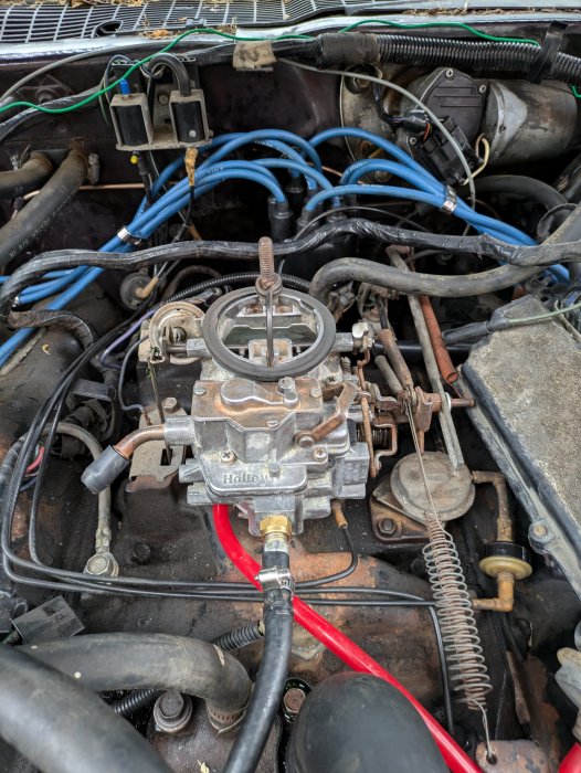

I mounted the orange ECU from the mancini kit, and then unfortunately it began to rain so I packed it in.
I swear the car has it out for me, every time I get a chance to work on it it rains and I only get to do a portion of what I want.

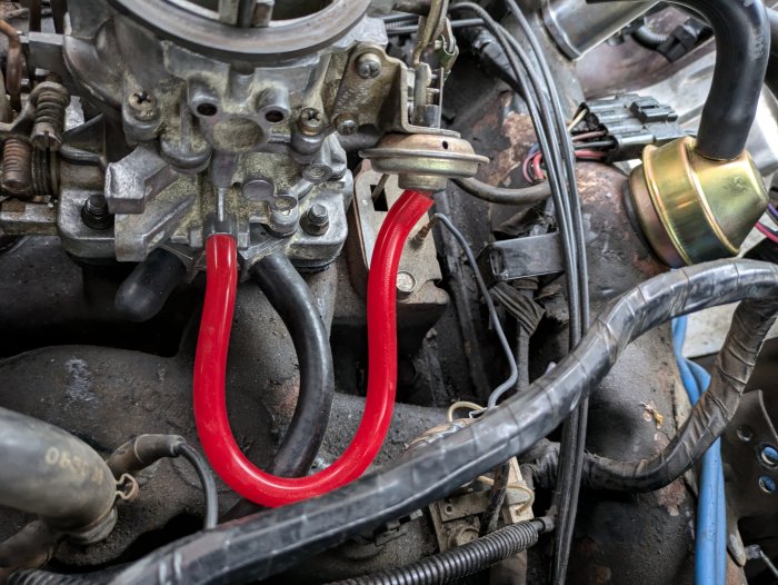

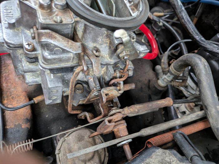

And yes I used the fancy red line, I also used an old rubber line and cut about an inch off both sides to make sure it didn't have brittle tips. I have been switching back and fourth since it was brought up and during all this testing, Did not make a difference which vac lines were used.
I am hoping that it will be a nice tommorow, but the weather report isn't looking great. If it is I will be back at it, and hopefully installing the mancini kit.

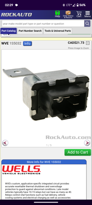

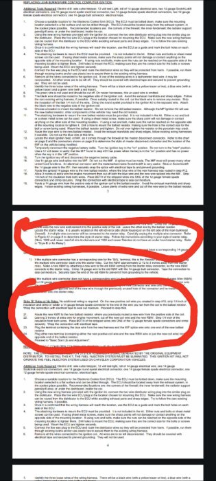

Got half of the wiring for the mancini kit done once the rain eased up. Ran into a problem, attached pics, hopefully it's legible.
Basically kit instructions are telling me that 88 and up vehicles don't have an under hood starter relay, and therefore I don't need a wire coming off of it to the positive on my coil.
But I looked, and I do have a starter relay, stock image from rockauto attached cause I forgot to take a picture, it's 3am here lol
But it's up mounted right next to what I assume is the master disconnect.
So....does anyone know if I still need that starter wire or no?
Mikes5thAve
Mar 3, 2020
1,781
736
Try the directions for no relay. All the wires should still be there somewhere but that relay is missing the spots you usually connect to.

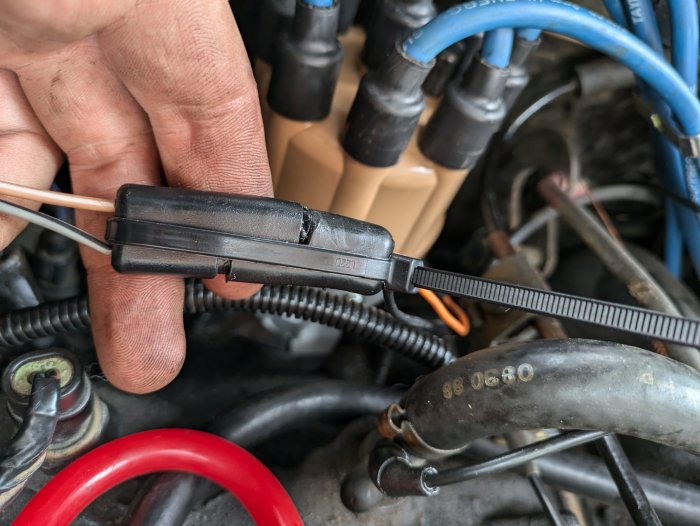

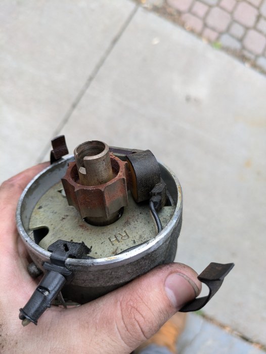

I think I found the problem, distributor. Pickup and reluctor are rusty as hell. Picture attached though it may be hard to see, I certainly couldn't see it while it was in the car.
The mancini kit was great for the most part, the confusion with the wording for the starter wire install was a minor issue.
The bigger issue was the distributor wiring connectors. I will attach a picture but basically the connector would not go in properly. For it to go in I had to cut back some of the rubber on the connector.
When pushing in I could see the rubber "marshmellowing" out and blocking it from going in fully. I got it in as best I could and zip tied it together. Hopefully doesn't separate. Otherwise I may have to buy some quick disconnectors and replace that connector on both ends.

And here come the questions, with all this together, done and working. I started taking the LB wiring out. Had no problem there.
Thanks to another post and BUDW commenting, I knew I would still need the oil pressure switch and power to the choke thermostat.
So I De-pinned the LB wires from the main harness connector, only leaving the ops, choke thermostat and I'm not sure what this one is for but it's a pink wire and a small push on cap type connector. This worked great and meant I did not have to butcher the harness much at all.
That said, that leaves 3 connectors/sensors that I'm not sure if I need or what to do with them?
Car seems to run fine without them but just making sure.
The 02 sensor remains disconnected, as well as a 2 wire plug style connector behind the carb, and a second push on cap type connector that sits in front of the carb (bright lime green wire)
All of the wires for these 3 went directly to the LB side of the harness and didn't even interact with the main bulk connector. I'll take some pictures if necessary tommorow, just didn't think of it at the time.
I'm also assuming those solenoids on the firewall, that all the emissions lines run to is no longer of use since they won't be getting power from the LB harness. So can those be removed, along with the associated vac lines? That would include the EGR? (I have the EGR delete plate on for the time being until I know what to do with it)

The pink wire up front with push connector is temp guage. The oxygen sensor can stay disconnected. The egr solenoids can go. I forget if it's in thus post or another one but the vacuum hose from it can go to another vacuum connector that comes out of the intake on that side and then to the carb. I can't remember if 88/89s have it but it's a vacuum switch that opens once the engine warms up so far. EGR shouldn't open on a cold engine.

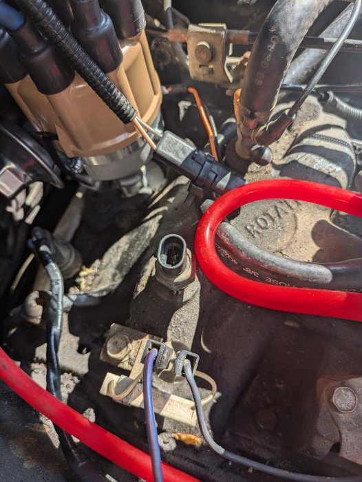

Great, that helps. Any idea of the other push connector with the lime green wire, and the clip in 2 pin?
Guessing I don't need them since they ran straight to the LB computer but who knows.
And yes I believe it was AHBGURU who mentioned it, and while I was at the scrapyard I think I actually saw exactly what he meant.
Rear right of the intake vac tree, went to the front right of intake ccvs bottom port, and then top port of ccvs to EGR valve. At least that's how I saw it done on a 318 non LB ram, but who knows if it was tinkered with or whatnot.
It's timed to 7° btdc based on the under hood sticker.
It just seemed weird, very sluggish. Like going 20kmph then put my foot to the floor and it felt like it took 2 seconds before it really started to pick up. Could just need to be ran though. Hasn't had a good drive in years
Mikes5thAve
Mar 3, 2020
1,781
736
Not sure what that connector would be, got a pic? Pretty much the only things you'll need now is temp, oil pressure switch, choke with the resistor looking doodad, alternator and ac if they are in that harness and whatever you are using for ignition.

Son of a.....I forgot to get a picture while I was there. I'll stop on my way to work and get one.
Temp, oil pressure switch and choke connector are the 3 things that I left in so that's perfect.

These are the two connectors, pretty much dead center of the photos.

Don't worry about that disconnected one at the back it's a sensor for the computer. The front is temp sensor for the guage.

Good to know about the rear sensor, but I thought the pink wire push on was for the temp gauge?
Because the pink one is connected down below the alternator ground point, and my temp gauge is working.
The push on one pictured was the lime green wire that went straight to the LB harness/computer.

Sorry yeah that front one in pic can stay disconnected.
