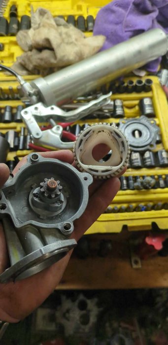

Had to fix my driver window motor, the little plastic shims in the motor were almost disintegrated. Turns out you can get a kit that comes with the gear, shims and a few other odds and ends to fix them, about 20$. Much cheaper than a whole new motor or even a wrecker unit. Mind you I understand most people just throw ball bearings in to replace the shims.

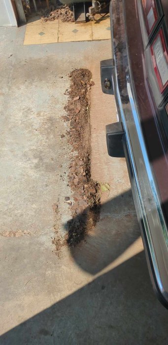

The other picture is the amount of dirt/salt/rust and scaling that came out of the rear bumper. Spent an hour cleaning that out then rust treating the rear end.

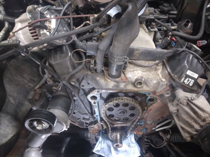

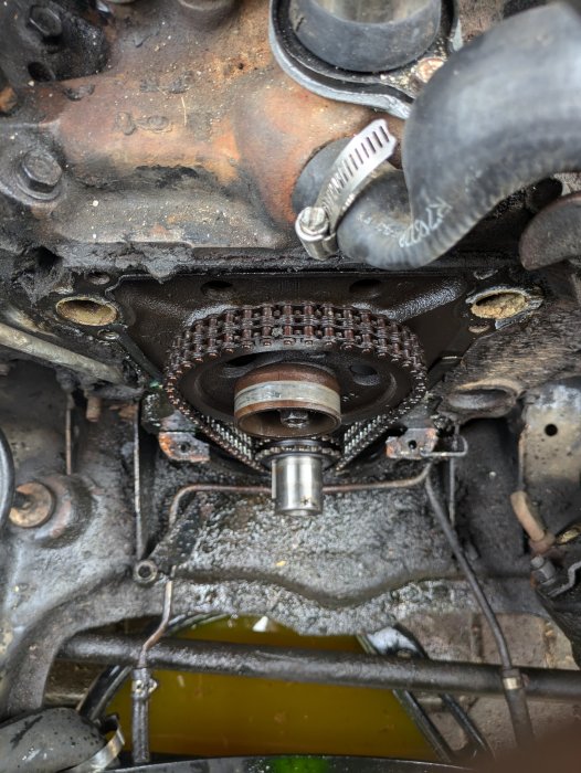

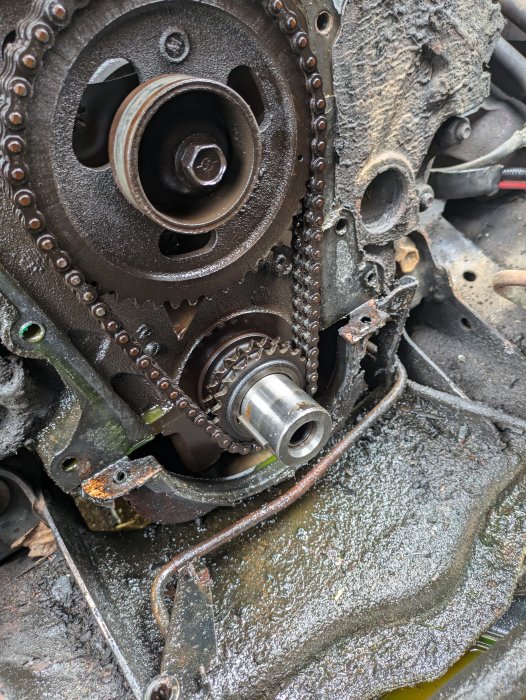

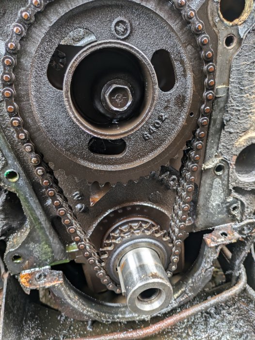

Well son of a..... Look at it this way, probably needed new cover and wp gaskets, along with a new crank seal anyways.
Just finished doing exactly that on my '96 Dakota 3.9 Magnum.
