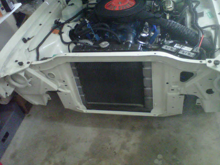

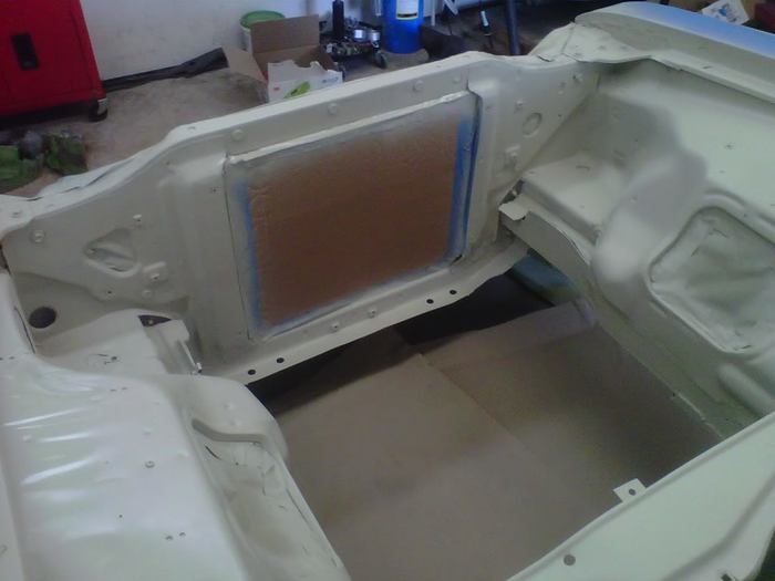

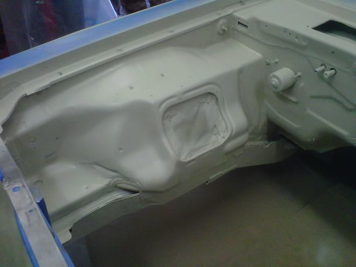

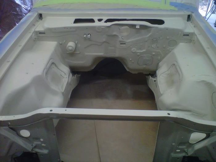

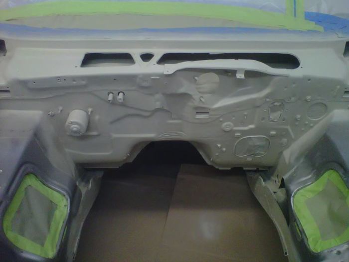

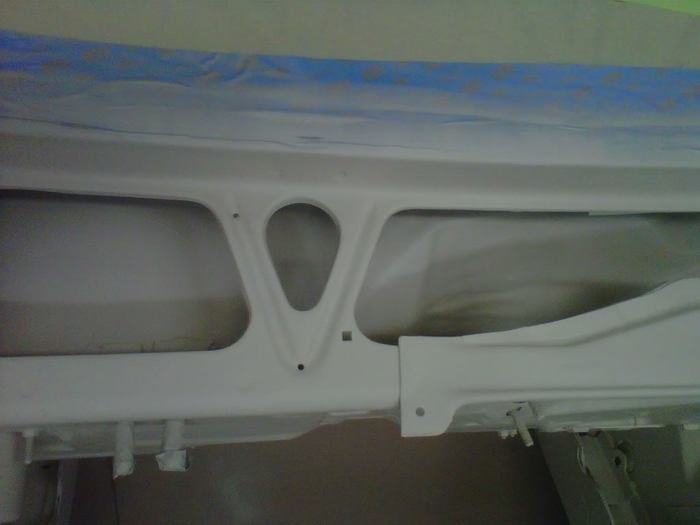

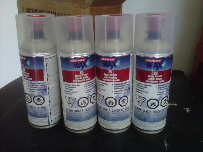

    For the do it your selfers...I like to use this newly found epoxy primer in a spray can...I used it and it worked and sprayed just like a HVLP spray gun...adjustable spray pattern and the overspray is almost like a dry fall product...it falls and dries quickly..I give it a big thumbs up...Spray Max 2K epoxy primer..
    This is the front of my car that I used the epoxy primer...like that white

    I forgot to tell you were you can get the Max 2K spray...Try Auto Body Tool Mart on-line

  13. bremereric
    bremereric FMJ Body Moderator
    3,555
    220
    Feb 25, 2011
    Jackson Missouri
    Eastwoods sells the Spray Max two part exopy rattle can....Auto Body Tool Mart was a little cheaper when I bought it...
  14. bremereric
    3,555
    220
    Feb 25, 2011
    Jackson Missouri
    All back in white now...3 and a half cans...I had five on hand...70 bucks worth of epoxy primer and a lot of work before it...That spray max stuff is the bomb..
