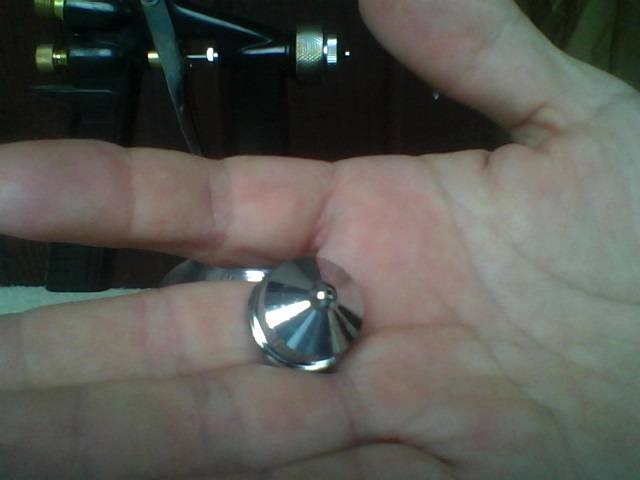

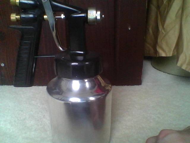

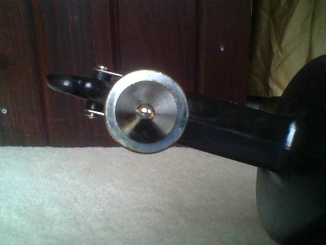

Ok, I really don't have the skill set you guys are talking at. The set of guns I had were all non grav feed type. This was the last one. It came with a slit nozzle and a round hole nozzle. The other two in the set had only one nozzle each. My friend just used one on the duster, but I'm not sure of the nozzle. The one I used was the primer gun and it's nozzle was a large hole that tappered out. I did see decent results with heavy metallic paint with both of the guns. So would grav guns be better for clear? And these type be better for heavies (pearl/ metallics)? Realistically I know nothing comes easy and I don't expect to have a showcar perfect job right out of the box.

I started painting with a flea market "Sprays just as good as a Binks!" $19.99 imitation Binks. I could lay down some nice paint with a Ginsu gun. When I got more serious about painting, I upgraded my equipment. Practice, practice, practice. Shoot test patterns on scrap body parts to save $ on having to strip it & recoat.

If you can swing it, pick up Nesco HVLP (High Volume, Low Pressure) gravity fed gun. They make a full & touch up size. I have both. A jobber trying to make a sale will tell you that it sprays just like a Sata. Bullshirt! Only a Sata sprays like a Sata. But, they do lay down a nice paint job. Acquire cheap paint for your learning curve. Try to find body panels with as many body lines as possible. Make your mistakes on panels that don't matter, with paint that doesn't break the bank. Perfect your gun technique with different paints, patterns, pressures, etc.. When you get to where spraying is second nature, THEN go buy a Sata. You'll go from being a very good painter, to a great painter. The two lines of guns feel similar in your hand, but a difference of night & day as far as quality goes. I always try to learn on the cheap as much as possible. The only guy I know that used Rustoleum painted his car flat black, so there was no gloss to check out. I don't know if your paint supplier carries bulk paint, but the places I used to deal with did. These were colors that were surplus, mixed wrong, customer didn't want it, or whatever. They sell for pennies on the dollar. You still have to buy your reducers, hardners, etc., but I used to pay $16-22 a gallon for paint! You have to choose from what's available, but it's good enough to learn on. Sometimes you find a color you really like that you can use on your car. Hope this helps, Larry

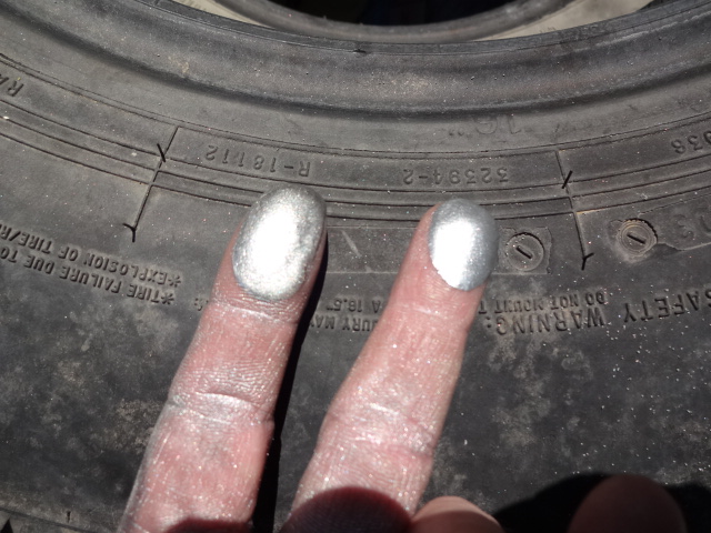

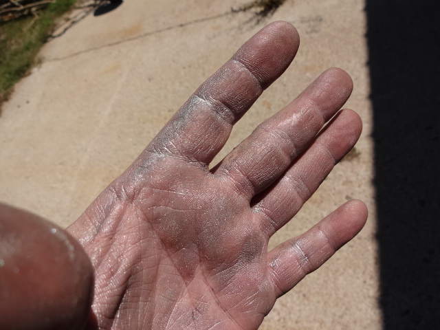

Not enough can be said for proper protection, dam I wish I would of thought things through starting 40 years ago. Ive a very F---ked nervous system, lungs, lymph nodes, cant walk some days,ect. Way back you could tell good quality paint by the way it smelled when you opened the can.
Even today just because the paints are good for the environment they still are not good for us.
One thing I do use is run an 02 line with 8 litres to my mask when im painting for fresh air and the unit is 100 ft away behind my shop.
But I do have a very nice stash of paints from the 70-s and 80-s, maybe 30 gallons and many quarts.
Ive not painted in a couple years, as if an ant would fart my lungs want to lock up.
2014 is the last time I painted, ive one last car to paint and im not really sure I can live through it. I took these in 2014 and I had not learned by then, sucks.
Hmmm, one course silver toner, one fine.
