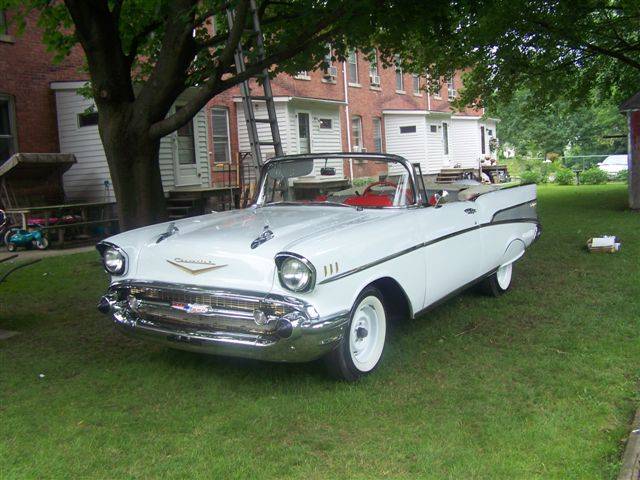

Here's a little example:
This car was done in PPG's Concept single stage mixed one to one RTS with 2002 Concept clear. I laid down three coats of single stage, gave it 36 hours of flow time (kicked back just a bit on the hardener and just a hair more reducer) then wet sanded it with 1000 to give the next mils something to bite on. I then laid down three coats of the single stage/clear mix (a trick, since the clear is thinner and you can have too much flow... kick back on the thinner in the clear), gave it the same amount of flow time, then sanded it down with 1500 going to 2000 before giving it an overall buff with an aggressive compound before going to a polish and finally a cleaner/wax also with buffer.
The car is white. A very forgiving color to work with and one in which it's hard to get a gloss from like a darker color. Yet, when you look at this car in full sun, wear your sunglasses.
