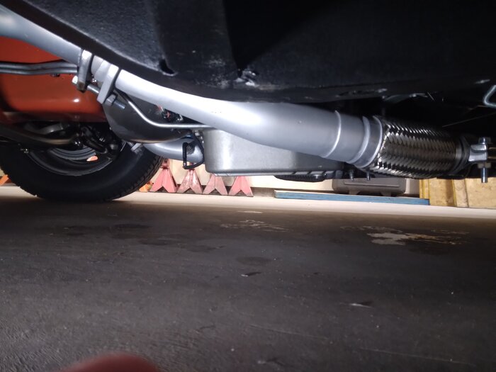

Since my trans pan has now sprung a leak for the 3rd time in the last month (Right Stuff gasket maker was still the wrong stuff, lol) figure it’s time to put the rusty pan in the scrap bin and get a deep pan on there. Should be here in a few days…now I’m officially “that guy” with the old car and the gnarly oil stain/s in the driveway. Before it was just the old car, lol. Looks like someone tried to bleed my baby dry in the driveway.

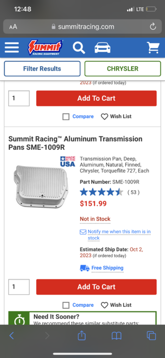

They're not in stock for ages. Want two, too.... (A100 + Charger)
Have one on my camper's 727. Painless and tight. :)

That’s what makes swallowing the cash on a TCI or Moroso pan so hard, I know, or hope anyway, a more affordable option will be around again. I mean, I have two small blocks and could use a spare 904 so, I’ll end up buying another deep pan sooner than later.
