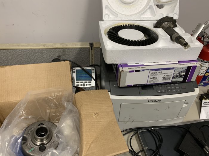

    picked up a 8.25” rear end from, brotherGood.
    Posi carrier, 3.21 gear set and rebuild kit will be at my shop Monday.
    Need to get the rear all stripped down, cleaned, painted and drop it off to my buddy, Adams shop and have him assemble the new rear gears for me.
    Order up some fresh 11” drums, shoes and hardware and such and throw the thing into the car; maybe grab a, rear sway bar from, FFI while I’m at things. Should make the car feel a little more peppy stop light to stop light while cruising around Chicago.

    About $700 and most of that was just buying and shipping it.
    Carrier was a gift from a buddy, gears and rebuild kit were a little over $180 and I guess brakes will be about $200 for everything so, about $800 give or take all said and done

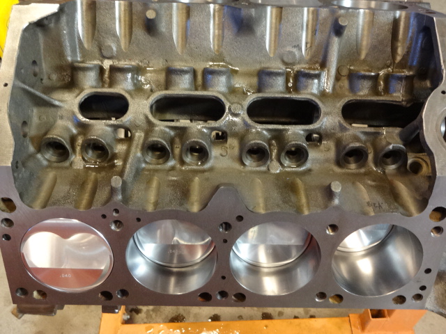

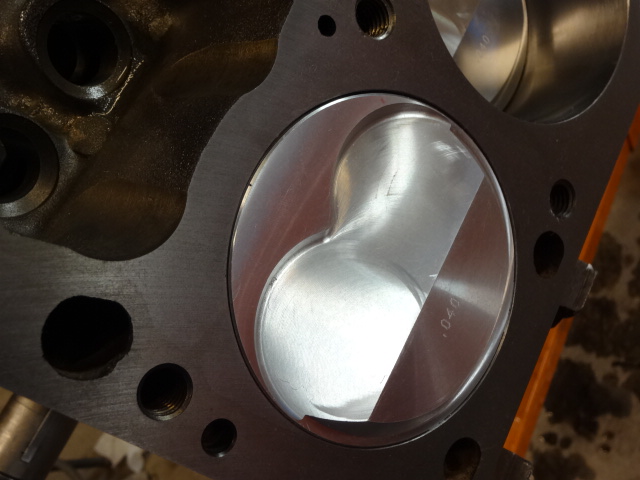

    While I’ve enjoyed my 318, it’s well, a lack luster 318. While a swap won’t actually happen for another year or two, I want to start getting parts together for when the time comes.
    I’m leaning towards two options;
    Option one:
    There’s a couple 5.9 magnums complete with transmission, harnesses, ect... their both over 150k miles and would need to be freshened up to be solid. Ones still in a running/driving truck, the other is on a pallet. Each going for about $600 and then any additional cost for rebuild/parts
    Option two:
    There’s a tanked and magnafluxed, 400 with crank, rods and pistons for $400 that’s ready to build...and then getting everything else to build it, shift it, ect...
    Ideally, my long term goal with the car: have something reliable enough that can be driven on the street day to day but, still be a bunch of fun on a 1/4 mile strip any given weekend.
    What would you do or what have you done when replacing your lazy, 318?

    Jack in some compression, I had org. used some lightened 340 rods in this one but then rebalanced to a lightweight aftermarket rod for a low 1800 gram bobweight vs oem 2100 plus.
    But you could do a ring and bearing job and a whiplash cam all on the cheap and have a fun combo as well.
    Unless you have a reason to run a 318, id even say if your gonna buy pistons, bore/hone/balance, for equal money the 360 is a better choice
    Camtron likes this.

    360 magnum, easily.
    Ive got one on the stand waiting for me to finish everything else that's lined up in front of it. The 318 with magnum heads in car now make it fun.. and ive not even driven it with the 3.55s
    Camtron likes this.

    Decisions...decisions...I've been here. My car has had four different builds in it over the years. Need more information on what your expectations are, but don't even screw around with a 318. Too many better options out there if you're pulling the motor out.
    Do you eventually want an O/D transmission?
    Got an expectation of quarter mile times?
    More of an emphasis on handling than power?
    The 400 is going to give you more power obviously, but it'll also add weight to the nose and complexity if you ever wanted to tackle an O/D transmission conversion. It'll need conversion mounts and a new transmission as well. Seeing as how all 400 motors were smog dogs the static compression will be in the toilet, so new pistons on top.
    360 Magnum motors are stupid easy to build to 400HP and 400 ft/lbs of torque utilizing a factory rotating assembly and heads. You can reuse the transmission you have and not have to modify motor mount tower to get it to fit. It also won't add any more weight to the front end than what you have now. If you want more though, then the 400 begins to be more practical.
    Going with what you gave us already though I would also vote 5.9 Magnum. If you're looking at one with a transmission too then it needs to be no later than 1995. Starting in 96 the transmissions are completely computer controlled and will be garage art unless you plan on using the factory computer; which is no fun.
    Camtron likes this.

    That smog dog 400 with a 440 crank even with iron heads can make 525 hp and 550 tq. even more with decent aluminum heads.
