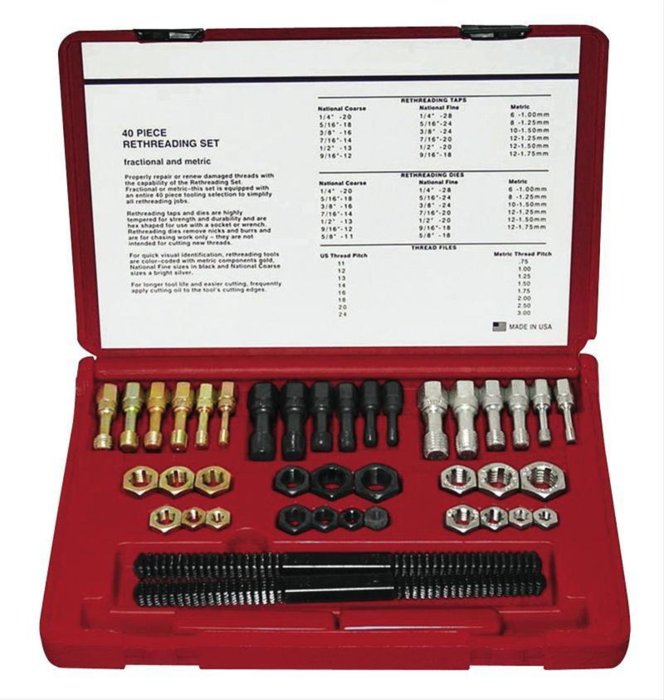

- Take vehicle to a carwash and spend a few $ in cleaning the area well.
- Use a tread cleaner to clean out all bolt holes in block and in timing cover. A tap could work but the official tool (thread cleaner) does a much better job on cleaning those threads – which (in my opinion) is a REQUIREMENT on small blocks, and not something nice to do.

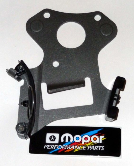

- If you have the money, pick up this item and install. If will help more than you might ever know:
Dodge 53021195aa ($49.50 US), as of today.
Mopar Performance P5007709 ($45ish)
Cloyes 9-5387
Melling BT428
Enginetech TT387
The above (bottom) three range between $20-30 (US) from Rockauto.com and about $45 from O’reilly auto parts.

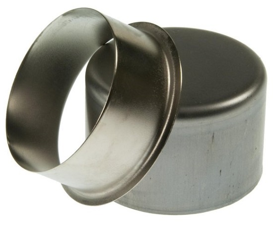

- The last thing is to feel the balancer hub after its removed. Sometimes the rubber from the seal can grove the hub. If it will catch a fingernail, get a balancer repair sleeve.
This is a National 88218 (about $10, US) , but others make one as well. I think it is odd something as soft as rubber can wear out steel (or cast iron), but it does. This is cheap insurance over a likely oil leak area.

Will the tensioner work alright with a double row timing chain? That’s what I have to install but, the tensioner I ordered comes with a single row chain and gears so, I guess no big deal either way.

don't mean to hijack your thread but I have a question about thread cleaners.
Stop me if you've heard this before ...
I have a 580k backhoe with a few problems.
One problem is there are supposed to be 8 studs on the front wheels.
The front left has 6 studs and two holes that look like either:
1. a lug nut was overtightened and broke the stud off
OR
2. a nitwit used a drill to try to 'remove' the stud because they didn't know what they were doing.
Either way I have two holes and each appear to have material in them one in the threads and the other I just can't tell but think the center is drilled out.
Would a thread cleaner help? she asks as she goes over to the interweb to search for info on thread cleaners....
