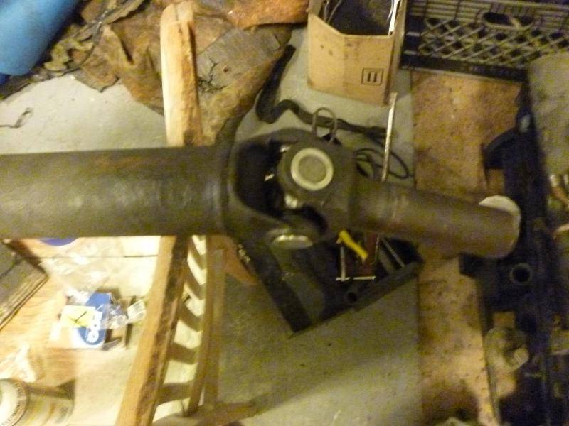

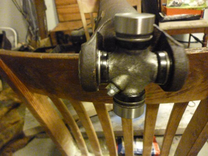

U-joints..it needed them for sure the old ones looked factory...

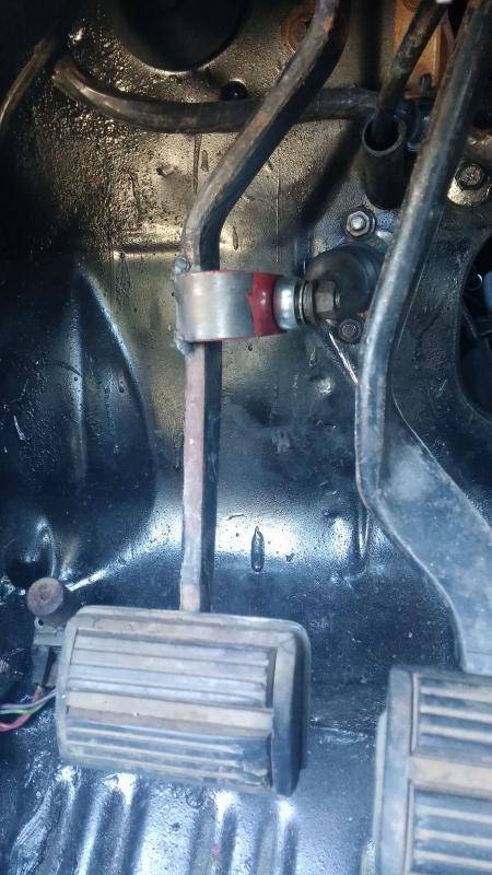

ok so I have been waiting for this Heim joint for almost a week I get it and it literally took 30 minutes to install it including making the braket and welding it to the pedal,... all done gonna paint it black when it cools. :icon_super:

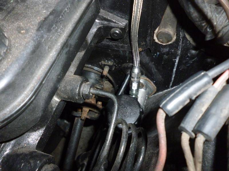

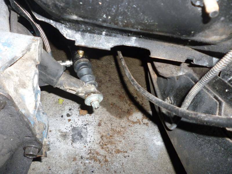

Made the line for the hydraulic clutch here is a pic of the progress all I have to do now is fill the master cylinder and bleed it..gonna need help for that...

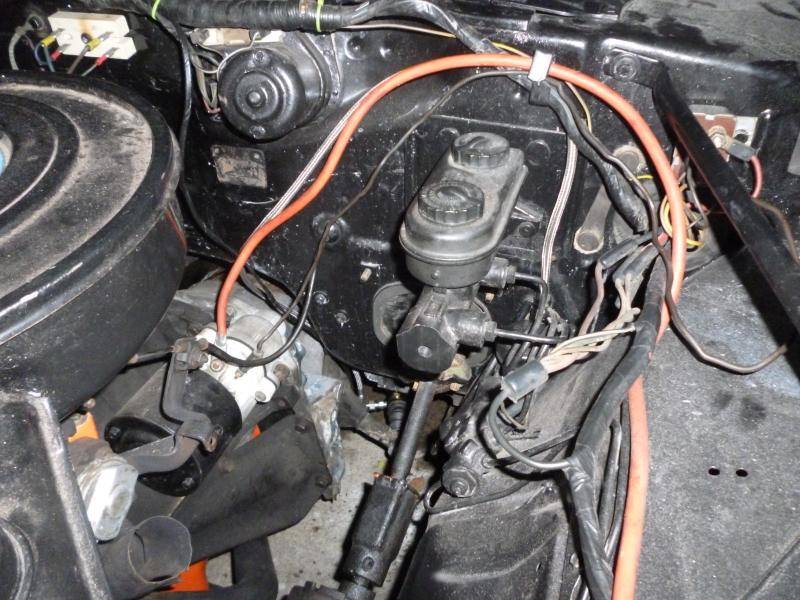

Its a factory manual but the master cylinder was like the only new thing in the engine compartment so I am guessing that it was the wrong part.
There is a manual and power brake push rod, maybe you have the wrong one? Dr.diff has adjustable ones that work well too. New wheels really make a difference! Nice!

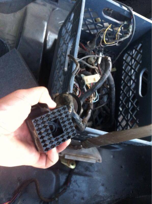

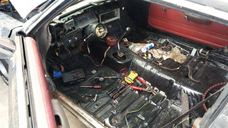

So Rich was having allot of

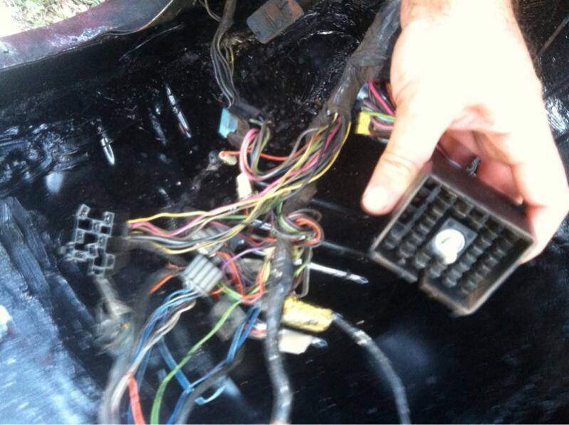

Problems troubleshooting (from now on typed T/S) smoking grounds, cross connected wire functions, half working electronic circuits, etc. so I suggested that we pull out my internal harness & swap it out & see how it goes. You cannot under value morale support! Pics to come
Did you half to replace all of the wiring?. I know mine was shot. I had to replace all of it. And boy was it a job. Corroded rusted rotted and dirt dobbered to death. I hate those bugs and there mud Lol.
It wasn't all shot, just some of it shorted, shorted to each other, the head light switch powered the windshield washer motor...

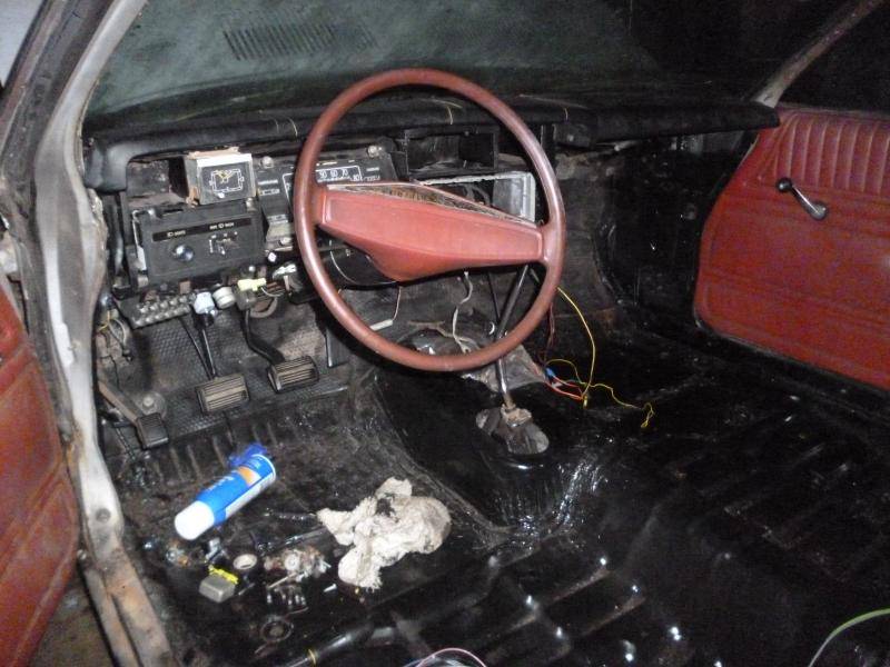

Some how I had acquired a NOS new in box under-dash/in-cabin wire harness so I told him to use my aspen dash vice trying to T/S it for two days. It had some differences and RIch will have to expound on those. He had multiple problems, but the switching of in cabin harnesses solved quite a few problems. he still has one headlight...
I work full time so I don't always get to put in the same time as Rich-he will be able to say more. We did have mud dobbers nests all over the cars, but not in the wiring harnesses. AND we had some mice/rat's nests intitially-stinky/gross!
I will check it out thank you!!

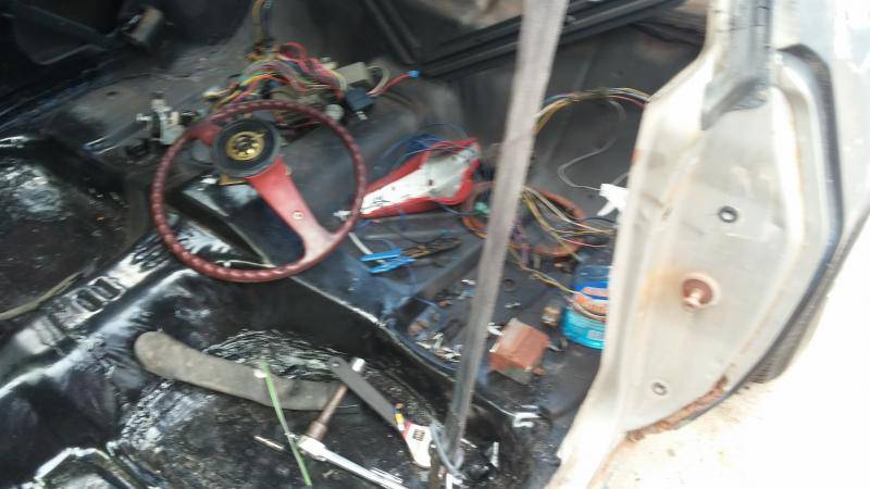

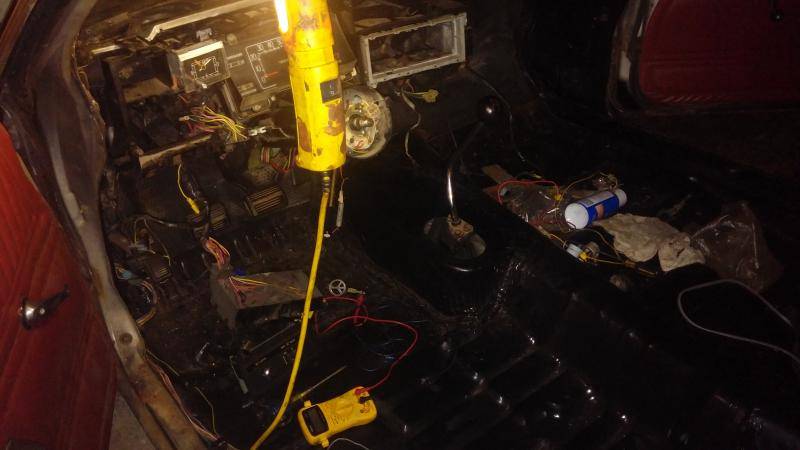

So here is what is going on...
The dimmer switch on the headlights when put full on turns the washer fluid motor on..
the horn is shorted to the ignition switch so when you turn the key you get a shock and the horn blasts...
the headlights dont come on at all but the drivers side running light/ turnsignal does and the licence plate light does....
I swapped the interior harness and thought that it solved the problem accept that the headlights still didnt work and when I put the steering wheel back on and bolted the fuse box back up. the same problems came back...( I think that the steering wheel part of the harness is screwed up and it was ok untill it wiggled)
So I have eliminated the interior harnness as the problem..I know that the rear harness is working because of the licence plate light...
that leaves one thing and I dread it because I hate hate hate doing things twice...

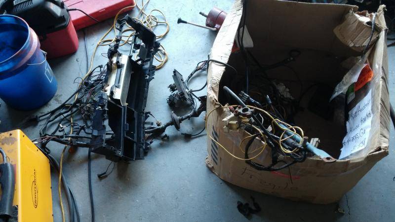

I have to replace the engine harness from the big connector forward it makes sense because all the wires that are misbehaving twist together and go through the fire wall together so some thing is touching that shouldn't in that bundle.... :BangHead:
Swapped out the harness today...
horn works no more shocker!!
headlights work but only on one setting, not sure if high or low beam yet.
washer fluid pump no longer turns on from the dimmer switch.
