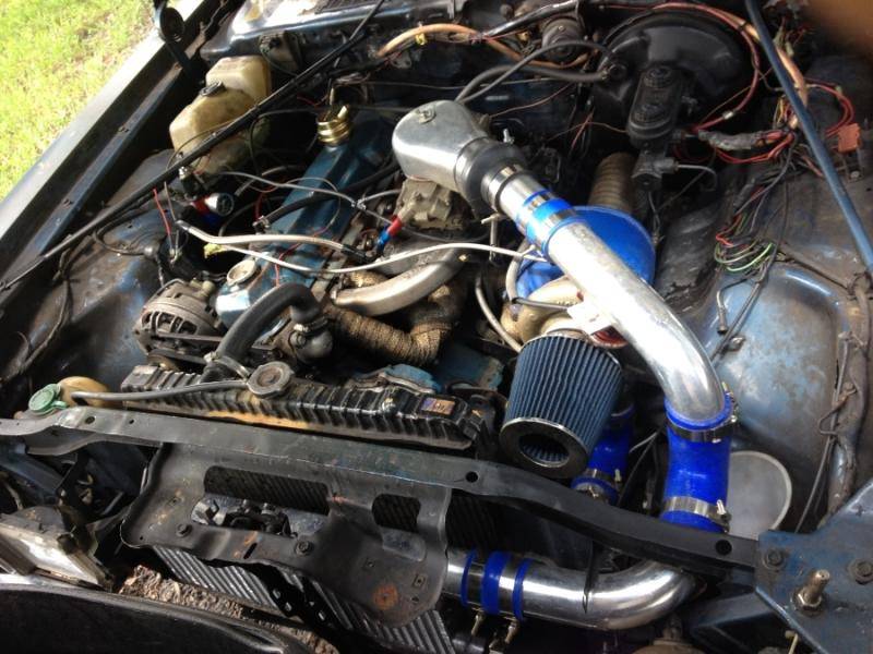

Bro super sexy build, but a turbo is the best route, blowers are nice, but buy the time to get done making it work you will have 3-4 times what a good turbo set up would cost
if your intrested the setup is available including the blown motor, I got greedy with 20+lbs of boost lol and its a complete setup from intercooler to oil pan, turbo, carb intake turbo cam and solid lifters etc, and a properly built slant 904 using V8 guts is better and lighter than a slant 727, I know i have run both, and still have the slant 727

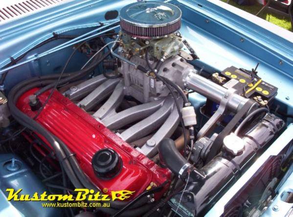

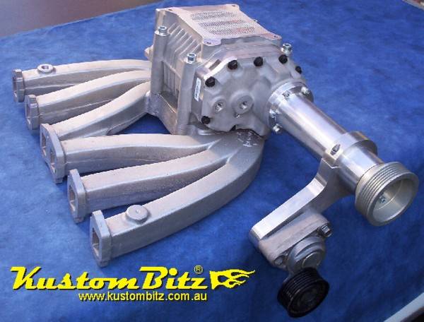

Just do a hell of allot more research than I did when I was buying small block parts. I don't want to share my dilemma experience with you or anyone. If you buy the blower, carb adapter how much more will it take to get the super fancy intake & custom exhaust-turbo portion?
Aussiespeed M90 blower manifold
THat is the best looking four barrel intake manifold for a slant that I have ever seen-never seen before! wow
