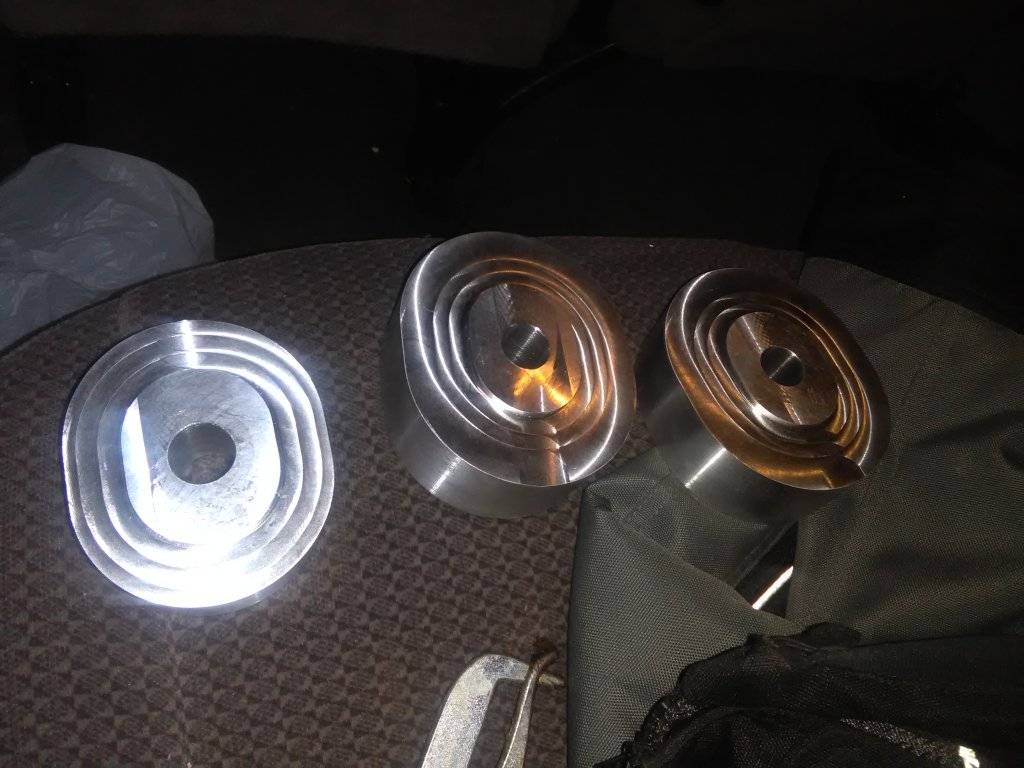

Lost track of time...well, actually ran out of time is more like it.
Here is the "blueprint" of the isolators I have on record. I think this came from CuddaZappa, but not 100% sure.
I've got the POLY isolators in my coupe, this combined with all HD/new stuff, including the adjustable KONI shocks does give a pretty good ride. I do also have the MP cast-iron pucks and CudaZappa's aluminum pieces, have not tried them though, so I can not comment regarding the difference one would see.

I got one side of the front to test fit today and it fits great. Getting the old rubber ones out was a little bit of a fight but no nuts broke loose. Had to saw the middle out of the old ones.

I got the other three today. I need to know how many would be wanting a set. Material is expensive for just a set or two

Cnc
