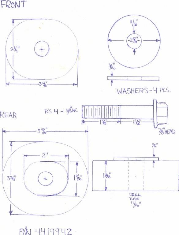

Here is the "blueprint" of the isolators I have on record. I think this came from CuddaZappa, but not 100% sure.
I've got the POLY isolators in my coupe, this combined with all HD/new stuff, including the adjustable KONI shocks does give a pretty good ride. I do also have the MP cast-iron pucks and CudaZappa's aluminum pieces, have not tried them though, so I can not comment regarding the difference one would see.

Very cool.
Made out of what material?
I want to get another set for my other car.
Have a ballpark on how much, yet?

Aluminum. No price yet, he said he would give me a price for one set and three sets. Gotta make tooling and write program
