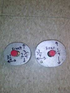

Firm Feel
1,494
those look just like the ones on my workbench - just waiting to install themselves . . .
1,494
They could be made – if someone had “material” to work with.
Need to look at mine again, but I think there was a inner lip made on mine – that I don’t see in the picture.
If one had access to a metal lathe – then flattened the sides – they would be easy to make (note: I have no metal working experience – only wood working experience – so don’t take my word for it). I just hadn’t seen material around to work with that size, before.

Are they solid aluminum? I can see if I can get a hold of the girl whos dad works at the welding shop and see what he can do. Alternatively, the guy I took my heads to last, thats a machine shop..he does everything there. He may be able to do them. If they can, ill get a quote and pass it along
MiradaMegacab
Feb 27, 2011
1,847
753
Long Island NY

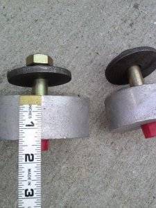

Those are solid aluminum Firm Feel units.
There are raised pads that locate the K-Frame.
These. are 1 5/16" tall.
That dimension can be changed, for example, increasing the height to 1 3/4" tall will give more clearance between the valve cover and power brake booster.. also giving more clearance from carb to hood..
