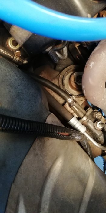

Before
After adjusting nut about half a turn, it's hard to see in video but not taking much to move wheels now
If I did now what I was doing in the first video I would be smashing into the curb or scaring the hell out of the cars on other side of the road.
tried to mark it, I had already tried to adjust about 1/4 turn before I marked it
