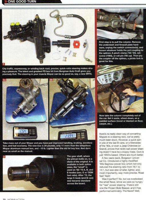

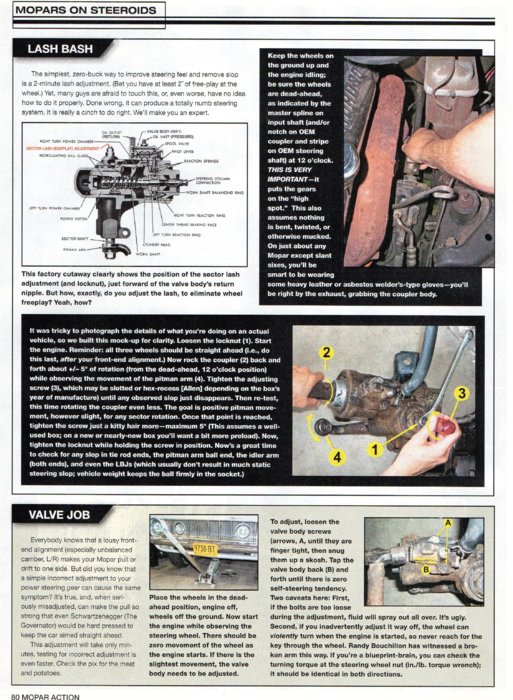

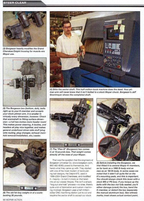

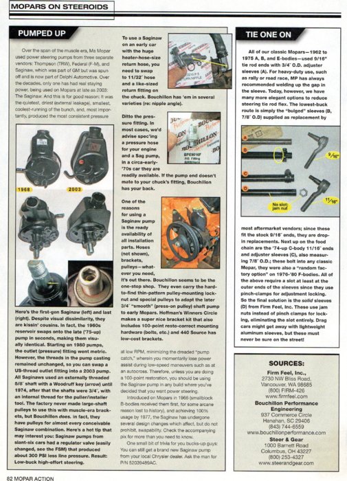

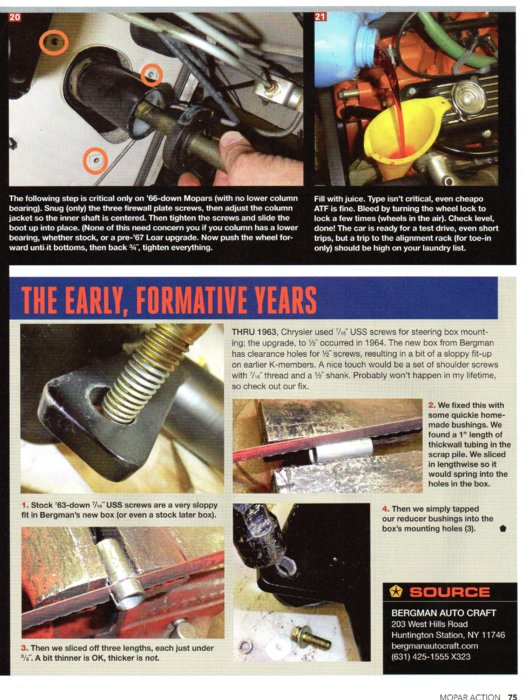

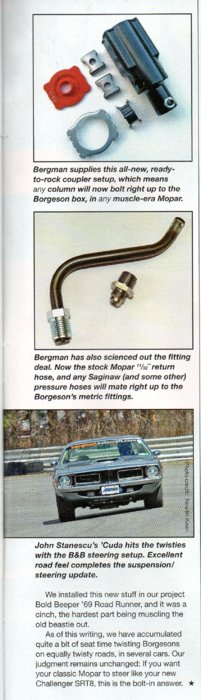

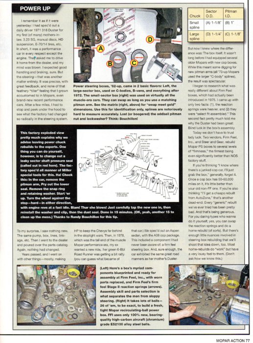

These are copies from two magazines I have. I know I have a third magazine talking about how Borgeson cuts off the Grand Cherokee Gear’s mounting tabs, re-welds tabs back onto the gear (to fit our cars) and also re-splines both the input shaft and output shaft splines as well – but I couldn’t find that magazine, at this time (Mopar Muscle, I think)
From my December 2008 edition of Mopar Action
Above are scanned pictures. Below is PDF copies of same pages.

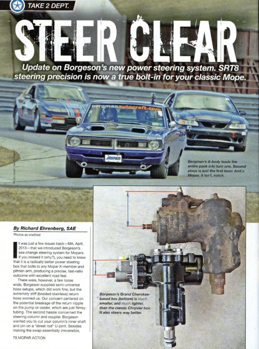

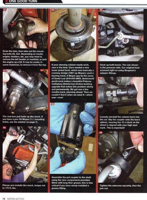

From my October 2013 edition of Mopar Action

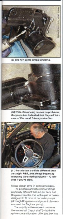

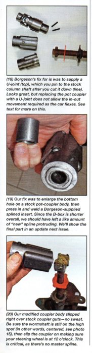

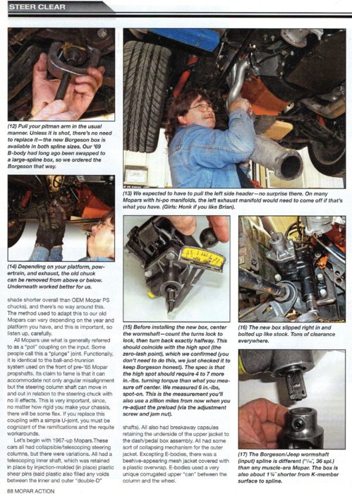

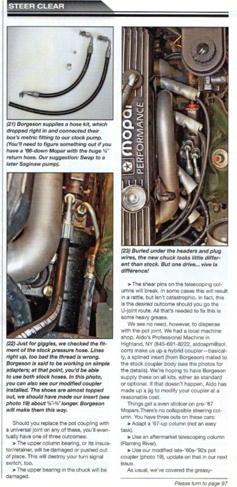

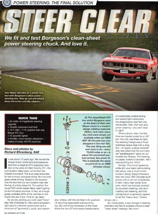

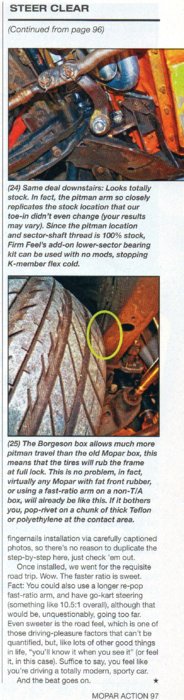

I found the third article, that I was looking for.
I also found online that Mopar Muscle has an article on installing the Borgeson gear into a '65 Coronet (for most details, the install will be the same as your J-body is). The article online is Steer Without Fear! How To Upgrade Your Mopar Steering Box! - Hot Rod Network . It appears I do not have that magazine.
Note: I do not recommend using the U-Joint – without some kind of up/down (fore/aft) movement allowance – or I foresee several potential problems in the future (cars do a lot of flexing).
This is from my April 2013 edition of Mopar Action:
I need to go to work, to make PDF versions.

I ran across even another magazine article about the Borgeson Steering gear (from the newer Jeeps).
This is from my December 2017 edition of Mopar Action.
I’m considering getting one of these, myself (if I can find $ to do so).
