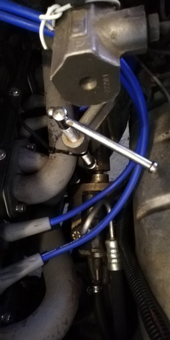

Ok I G clamped the coupler and then cabled tied it to my exhausts, I then went into the car and wiggled the wheel and its got hardly any play in it, have a look at the pics and the video, I am thinking the box may need some adjustment.
The bang at the start is the side door on my garage slamming in the wind, don't think I have smashed my steering gear :)

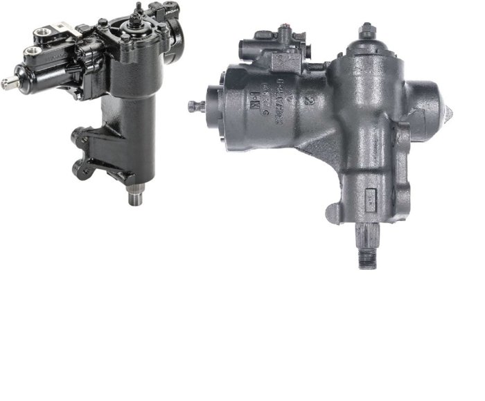

Ok this maybe left field, I dunno, but here we go, my boss use to have a JK jeep wranger, it had RB power steering, I drove it a few times and it had no play in the center position, felt like R&P but with less feedback, how hard would it be to make an adapter plate up that allowed the jeep steering gear to bolt into a J body, looks like to me the jeep mounts on the side and the J body on the K member, so some sort of L bracket might do the trick, really have no idea if possible, just a way out of it idea. Maybe it will mount on the side with some how, anything is possible :)
3,173
819
Remember you have got to use a pitman arm the same length with the same swing as the one you have now, before doing something like this look at a rack and pinion set up.
jasperjacko
Dec 4, 2011
1,672
251
It will NEVER EVER be as good as a rack and pinion like most cars have. There is just too much going on with the old style steering.
