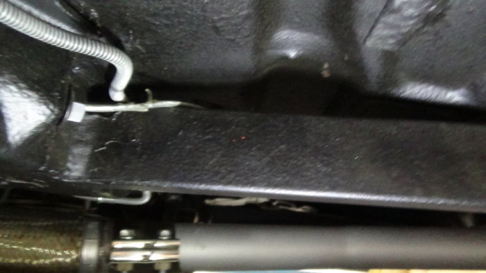

One thing I wished I'd done when building my connectors is make clearance something in the driver's side one for the parking brake cable. I have it going over the top and it works but, isn't ideal. Already has the cable coating worn off.
Sorry for the crummy out of focus photo.:oops:

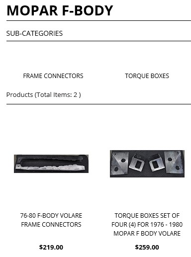

Mopar Archives - autorust.com
1,494
If you go to Mopar FJM Body Archives - autorust.com it leads you to https://www.classicindustries.com where there is very little FMJ stuff being sold (almost nothing).
US Car Tools also make subframe connectors – but will require more welding (possibly).
There is no mention if subframe connectors Mopar F-Body are for 2 or 4-door cars (4-door cars is a bit longer).
This is "all" US Car Tools shows to be available for FMJ’s:
Over the years, I’ve been impressed with what US Car Tools has had to offer, but not seen any actual products in person - so take this sentence at arm’s length.
