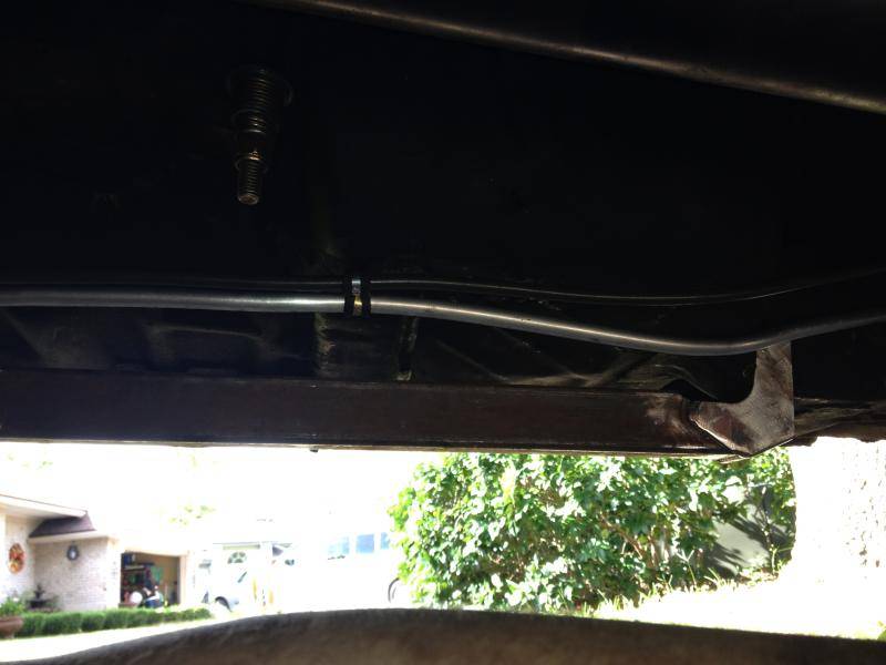

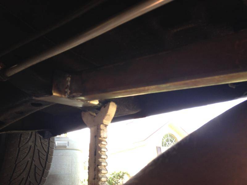

2" square tube works just fine, I was getting ripples in my rockers and the seam at the top of the quarters then added the frame connectors. The car responded by pulling both fronts 12" off the ground. At the time it was capable of 11.80s but I was running 12.0 because of no rollbar. The added benefit of the frame connectors is that I could jack the side of the car with the connectors. I added a cage when I built the 500" and got into the tens.
I've seen this discussion before and the general consensus was there's more strength in the tube than half a C chanel.

If you plan on welding them in yourself then buying a set already fabricated is just pissing money away. All it is is box tube and angle iron. They're simple to fabricate.
It's often said that going through the floor is the better way to install, and while I agree, it's overkill for a street car. Simply attaching the front and rear rails together even without slicing the floor will transform the car.
