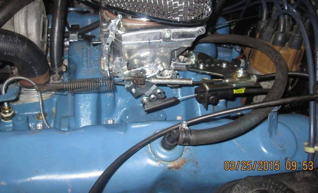

What is the purpose of the slot in the kick down linkage? All I can think of is if you take your foot off the gas pedal real fast it lets the carb come back real quick and if the trans kick down is slow to return it won't hold carb open.

Was the slot in the factory set up a safety thing? If that kick down leaver got stuck or jammed up under full acceleration carb could still return to idle?
I have had this happen to me twice.
For me, one time was a stick got wedged under car leaving kickdown stuck in 1/2 throttle position. Transmission was acting funny, and didn't take long to figure that one out.
My other time was driving in rain/ice storm and kickdown linkage froze up from ice accumulation. That time I couldn't move the throttle but only to off-idle). A few love taps from hammer handle broke up the ice and took care of that.
In your current setup, if a stick or ice happened to you like it did me, you might have problems.

Yes I agree, chances of a stick on a tarseal roads in NZ unlikely but not impossible and snow/ice is not a problem where I live, having said that guy at work was driving a long and a stone hit the trans cooler oil line and split it and he toasted his trans, what are the chances of that happening! But crazy stuff does happen. Bud - Thanks for all you help and advice!!
When I get more time I will look at seeing if I can set up better with the correct parts for the USA, just need to get the car mobile so I can get the wheel alignment sorted and the panel and paint sorted.
