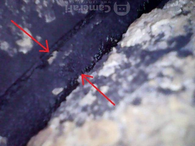

Well here are the basics, correct me where I might be wrong. Replies in bold
This is a ROAD car, and a tire fryer. The speed limit is 60mph,100kmph (62mph) and no drag-racing. Maybe just at the traffic lights :) Might take it down to the drags just to get the piece of paper!
Q1
;What about fuel mileage? - Can't have both, small cam and heads was going to kill perfromance
The engine we are working on is a 360, with 2.02-LA heads Yes, and a 340 type cam cam pulls 11 - 12" vac at 850 rpm, bigger than 340 cam I think, when I have eveything apart I will know more.(600 carb has been jetted and tuned by V8 mechanic in my city), an AirGap Yes. and 770Holley Street Avenger not sure that makes any difference.You are targeting compression in the range of 9.2 to 9.6 yes to try and keep on pump gas in NZ. And no tight quench.sucks but need to have zero deck to get any benefit from quench You believe the heads are gonna come in at about 200cfm - I hope so but someone has said your pushing shit up hill with your fingers on that one, will have to leave it to the head porter to see what magic he can do.
Q2
are the pistons flat-tops or dished, and if dished have you cc'd them yet,and - Yet to be CCed, had camera down plug hole looked like flat tops and a fair bit down the bore. Cant't be sure until heads are off, I know a bit unknown.
Q3
Just how far down in the holes are the pistons? China I reckon This will become very important shortly.Agree they are down the hole.
Q4
I assume headers and dual exhaust,right? Still working on this, hope to have a big single due to gas tank offset, running summit headers.
The tranny is an A998,(with ratios of 2.74-1.54-1.00), and you have an 8.25 with 3.21s and I am or going to rebuild a non lock up 904 as stall converter is non lock up. Lock up seems to be more of a hassle than a help, just loose 10% fuel economy on the gold
Q5
no suregrip yet. Correct and would like a LSD, maybe a future upgrade.
Q6
You think the TC is a 2500 Bought one that is 2200 - 2500 rpm stall, with a few variables won't know until its in the car.
Q7
how heavy is the car I dunno approx 3500lbs I thought, never had it on scales
Q8
What altitude are you at Sea level or just above or below in some parts of my city! Scary eh! Christchurch is built on a swamp!

I did advance the timing we bit and when it is nice and hot it idles a bit better, but you still get the idea! I thought 11 - 12" of vac gave it away to being something substantial in there.
