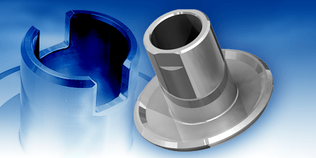

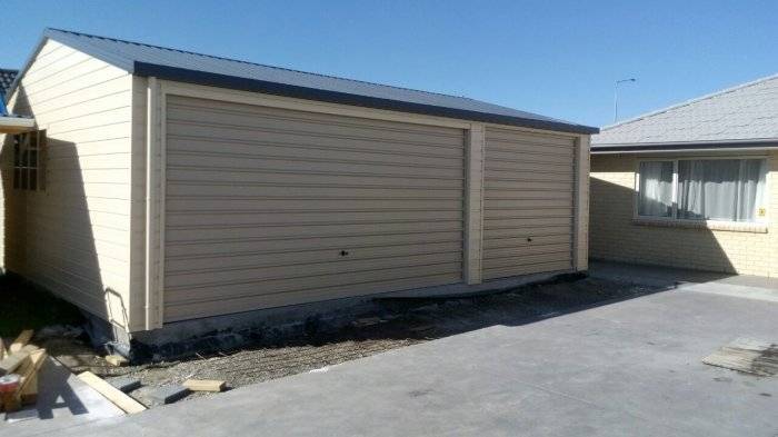

Come on down under, I have a bed for you here Bud and I will feed you. I have an empty 522sqft garage we can work in, just been built on my property we can work in :) Oh and I will feed you as much NZ beer, Wine, Water as you can take along with good NZ food! And you can drive the doba to get around if you think you can drive a left hand drive car on the left side of the road, now thats crazy! try not driving on the other side, its quite hazardous to your health! Oh and while I am at work earning money to pay for the expensive parts as I don't like the idea of selling my ball sack to pay for for parts you could bolt the trans in and out :) Its a fun job I know! Have a complete rebuild kit for Oregon Performance trans, stage 1 shift kit, pistons and Kevlar bands and the stall converter, that would keep you busy for a week I reckon!
